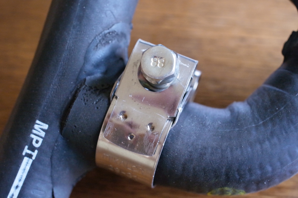

Replied by Blow-in on topic Coolant hose split- an autopsy and SHOCK DISCOVERY
Posted 13 years 4 months ago #107238
David,
I've gone with a Mikalor 29 - 31 mm clamp (W2) tightened carefully. I don't think a cable tie would do much given the evident pressure generated.
Hopefully I've not transferred the stress elsewhere. Not 100% happy with the vulcanising on one side of the joint although it has an inspection stamp and is probably (!) just surface pitting.
It will be some time before I can fit this.
Richard
Attachment Mikalor1.JPG not found
Richard
