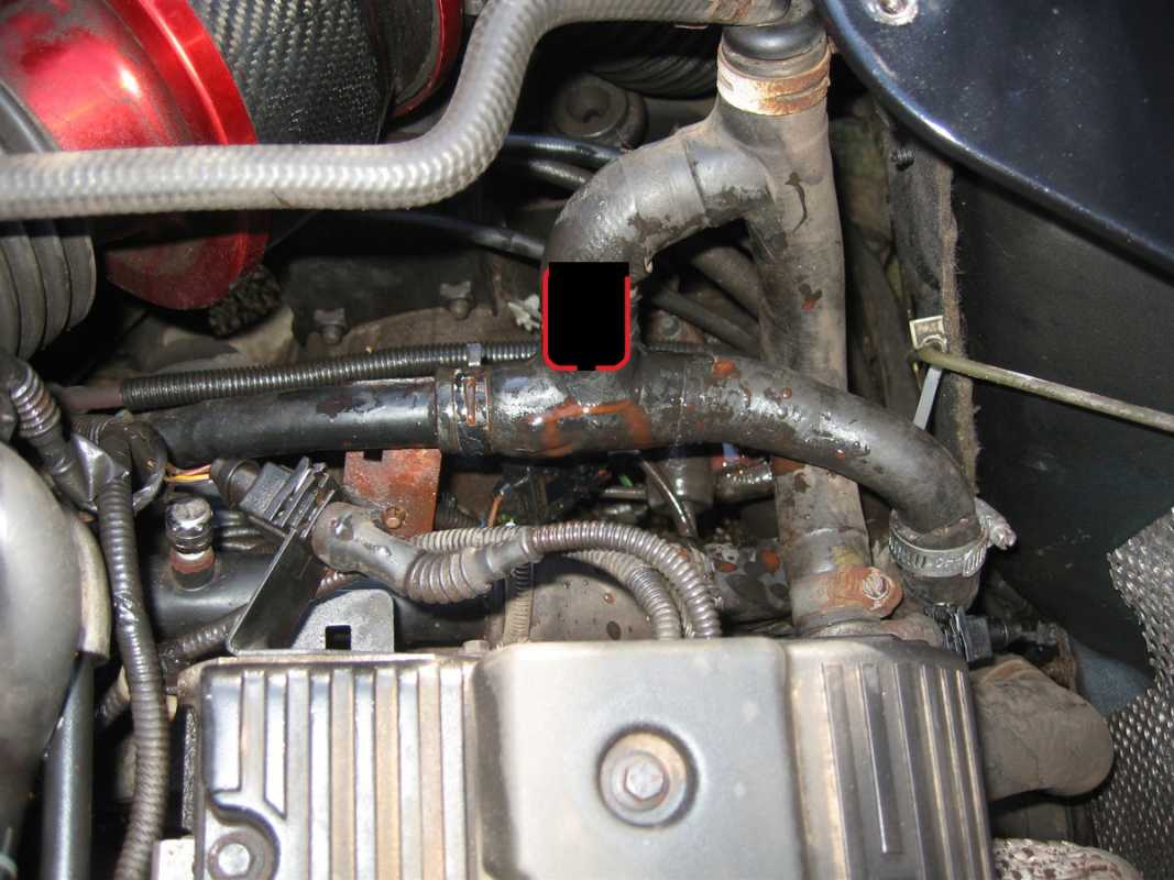

Replied by David Aiketgate on topic Coolant hose split- an autopsy and SHOCK DISCOVERY
Posted 13 years 4 months ago #105046
Ok, Thanks to me old mate Russell, i know know that this part should be positioned so:-

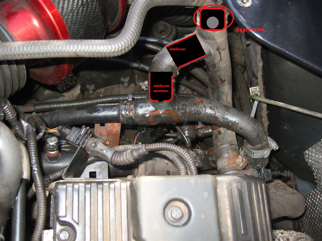

Posted 13 years 4 months ago #105049
The wandering part is actually a reinforcement/restrictor and not related to the jiggle valve.
Should be like this Jiggle valve *(ball bearing in a plastic cage)
Two reinforcing tubes, one with a flow restrictor.
