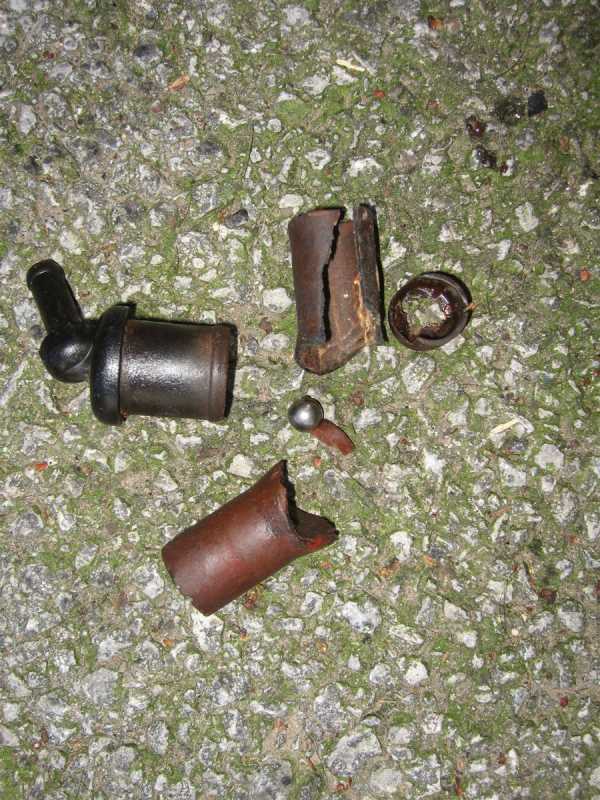

Take heed dear listener, for I have a tale to tell.

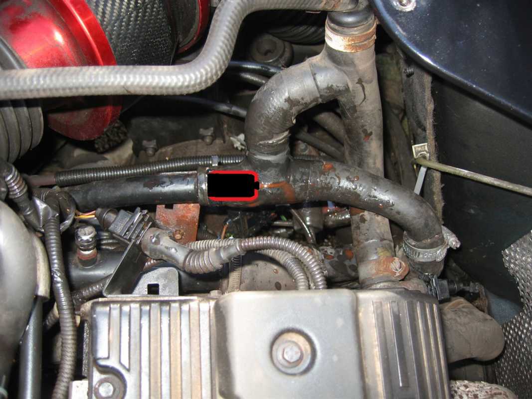

Being of an inquisitive mind (nosy git) I decided to investigate why the hose had decided to fail so spectacularly.
This is the hose in question.

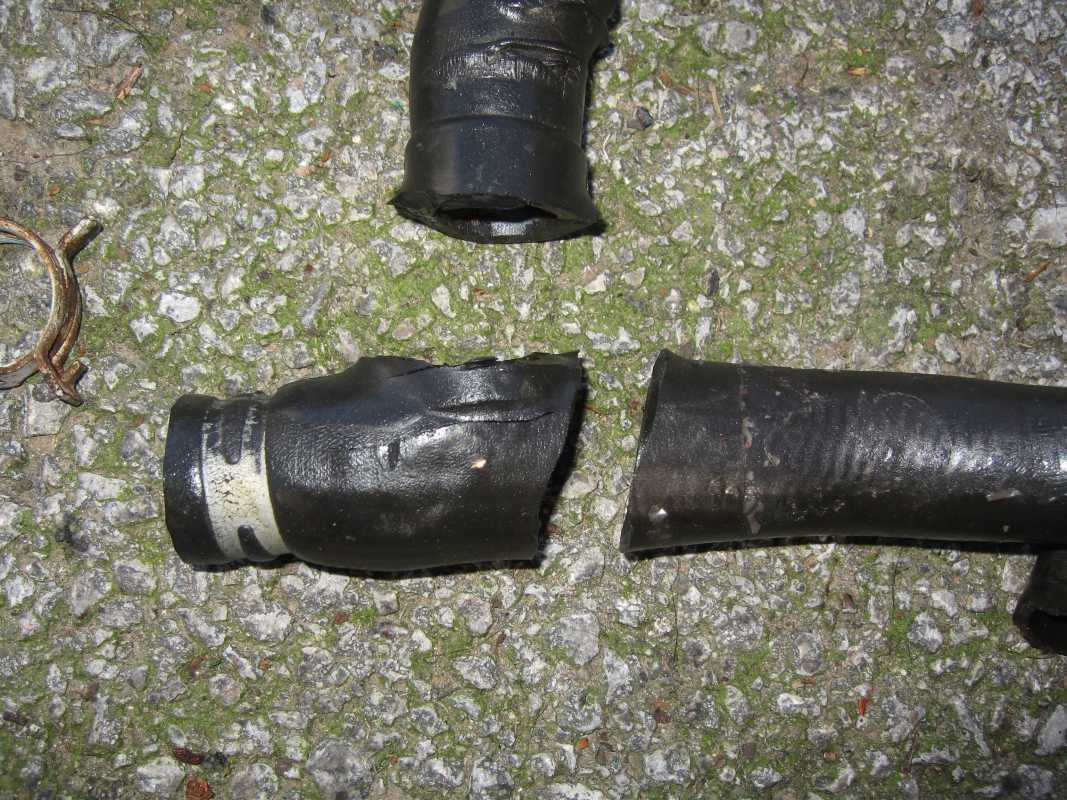

So having removed the hose I decided to perform an autopsy.
It seemed clear that the hose had blown out rather than being cut or damaged externally.
The first incisions.

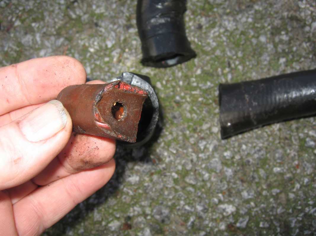

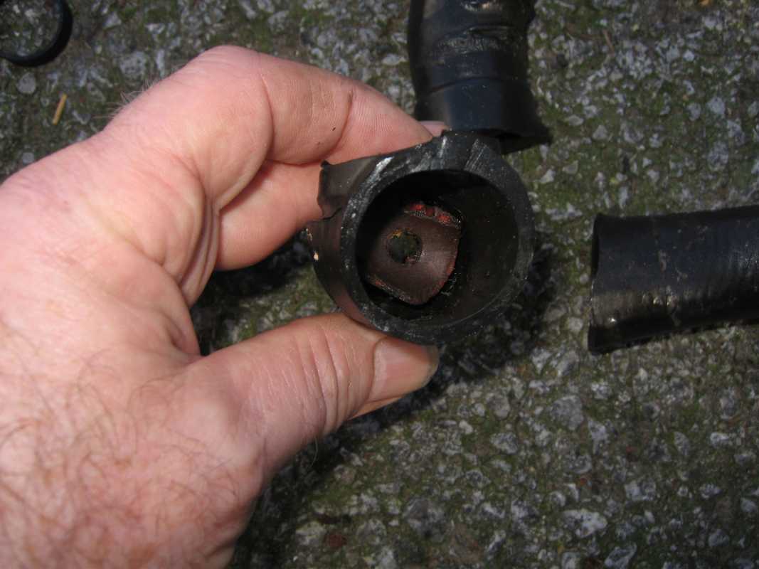

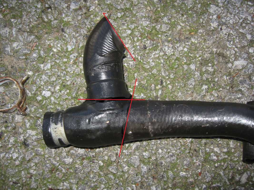

What the hell is this?

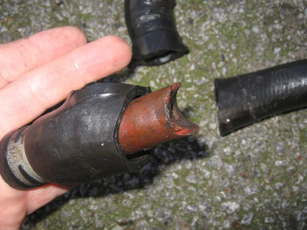

This is where this restriction was.

Any ideas where this has come from? :-?

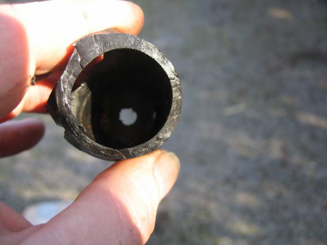

This shows how restricted the flow would have been.

Hmmm, interesting find. Can I assume this was under the jubilee clip where the two pipes meet? Is it there to have something solid to clamp one pipe over the other to or specifically to restrict the flow?
I look forward to hearing a proper answer.
Coolant hose split- an autopsy 11 years 1 month ago #104912
  • David Aiketgate's Avatar Topic Author
  • Posts: 20139
  • Thanks: 4388
No, the pipe on the left(in the photo) of the restriction is metal so the rubber hose clamps to that.

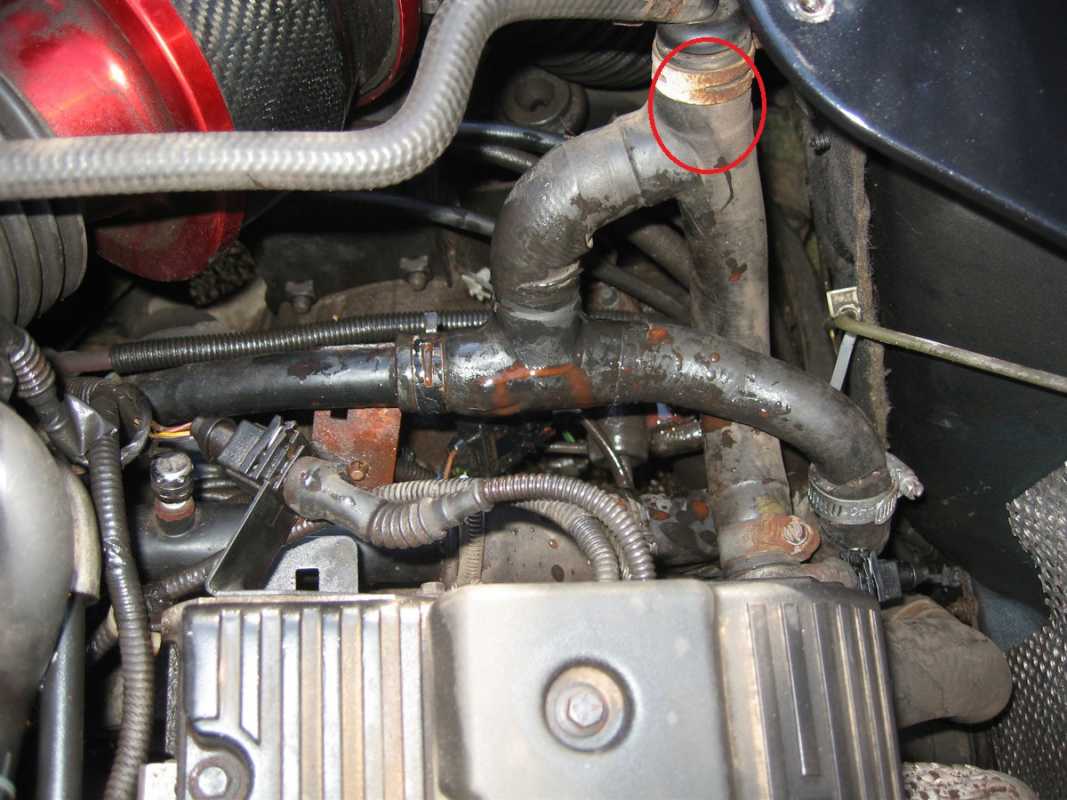

The offending article with the rest of the Jiggle Valve

From here?

Just a restrictor I assume, to create a pressure differential maybe.
Last edit: Post by David Aiketgate. Reason: sp
Coolant hose split- an autopsy 11 years 1 month ago #104921
So this begs the question(s)
What is the reason for this?
Does the silicon replacement pipe have the same restrictor and, if not, what are the implications?
As usual from me - all questions and no answers :coat:
