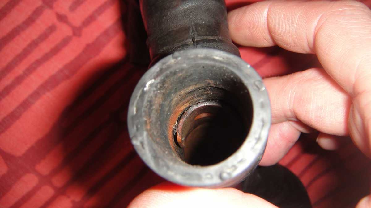

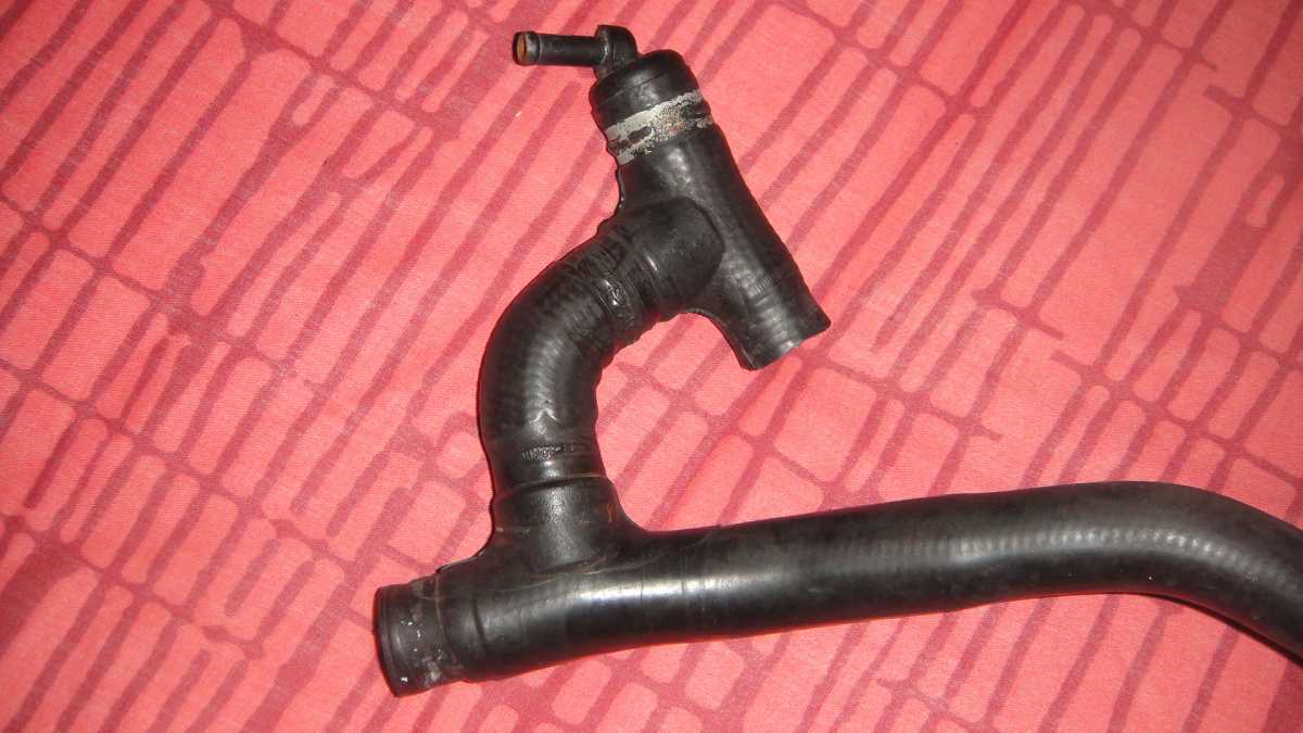

Nice detective work David. I'm glad that you have taken the time to determine the root cause of the failure.
[size=10pt]Mark[/size]
95 MGF
by mowog73
Replied by David Aiketgate on topic Coolant hose split- an autopsy and SHOCK DISCOVERY
Posted 13 years 4 months ago #105053

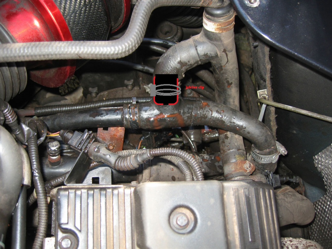

You should be able to feel if this reinforcer is still in place by squeezing the area. Perhaps as Craig suggested a jubilee clip might not be a bad idea to make sure it stays put.

mowog73 wrote: Nice detective work David. I'm glad that you have taken the time to determine the root cause of the failure.
I agree with Mark, it's really good detective work. Nice one David. Very nice job indeed. Great mock up pics too. :broon:

I'm going to head over the Canadian Tire and get a roll of silicone self-fusing tape to carry in the F.

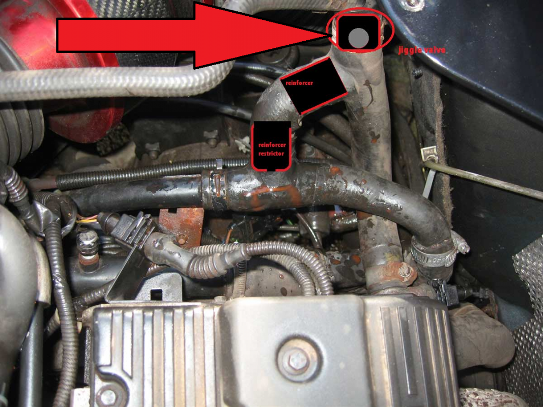

Replied by helsbyman on topic Coolant hose split- an autopsy and SHOCK DISCOVERY
Posted 13 years 4 months ago #105183

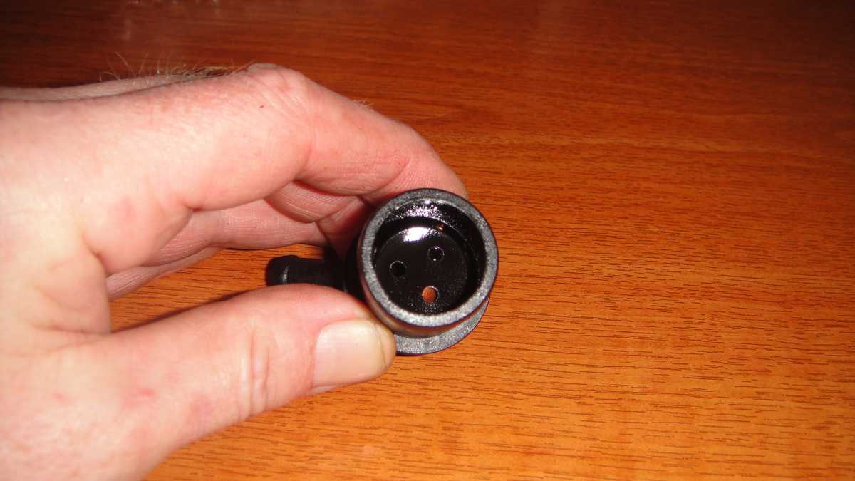

this jigle valve, i can not see it in the pics and the only thing i know of this jigle valve is you are able to open/close it to bleed the system so were is it ?
Posted 13 years 4 months ago #105187
Last Edit:13 years 4 months ago by David Aiketgate

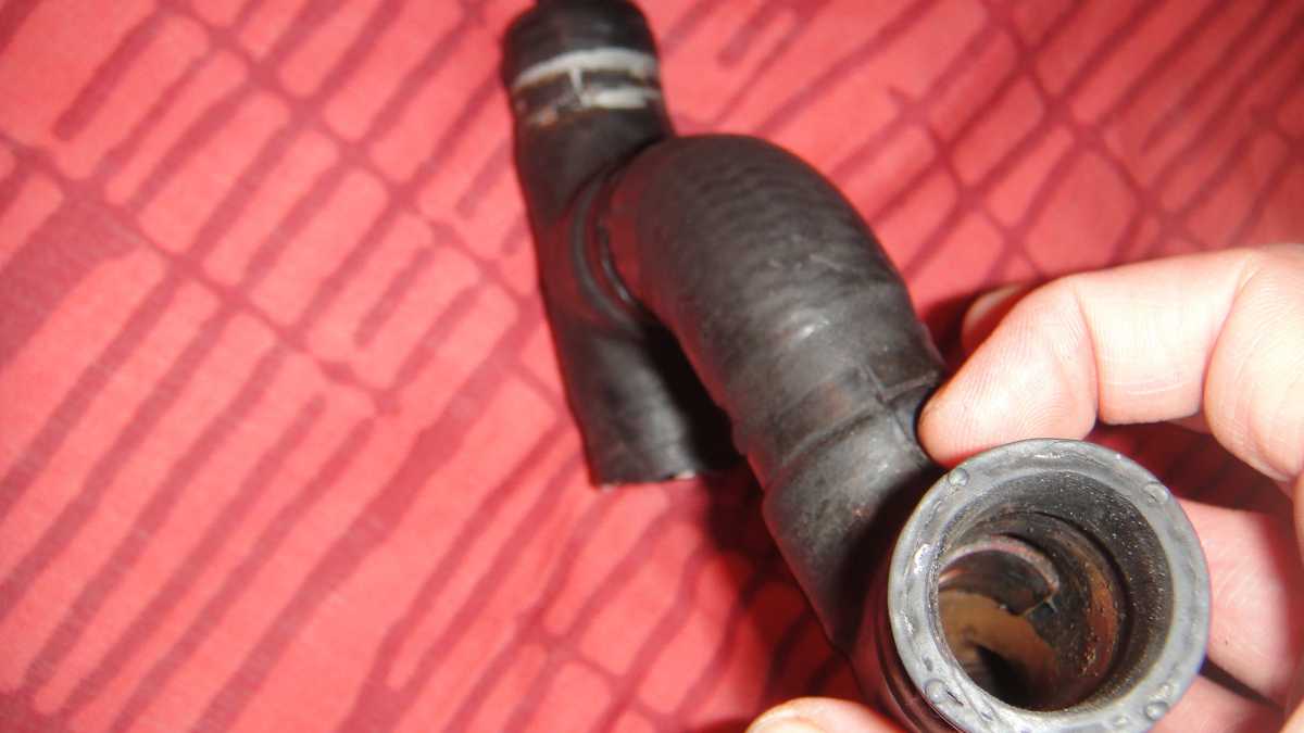

Here's a closeup of my new hose! :dry:
You can just see the red bit sticking out. ;)

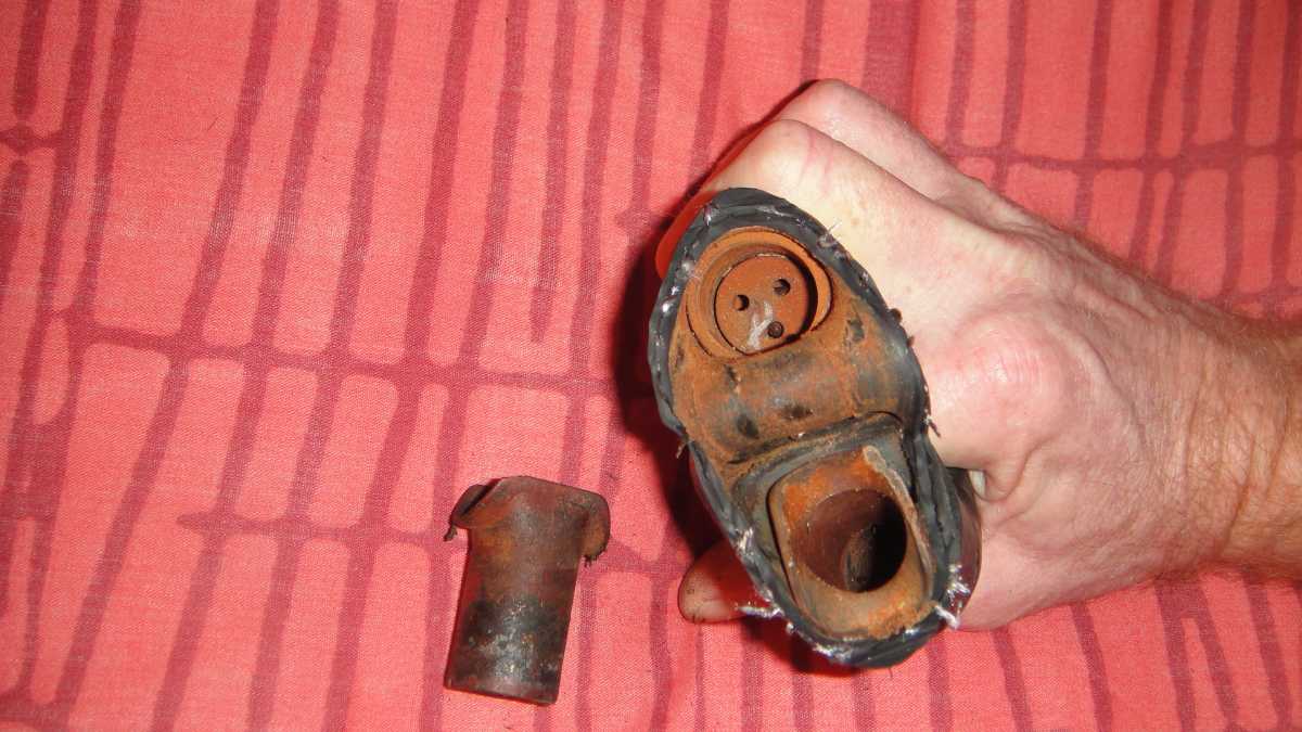

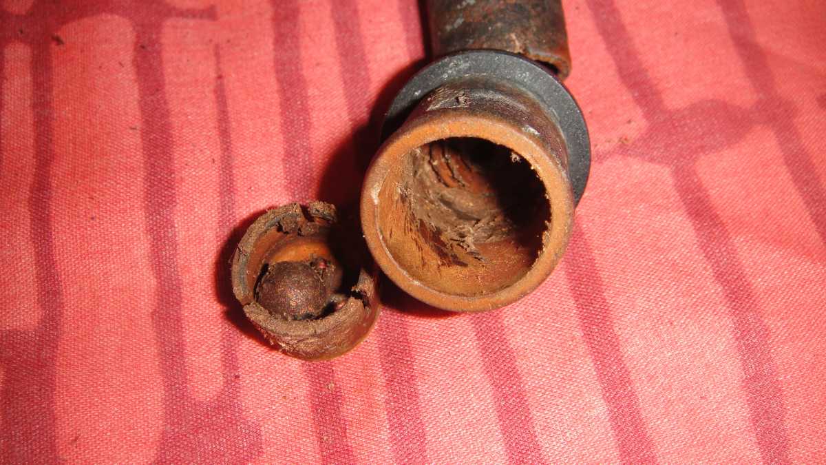

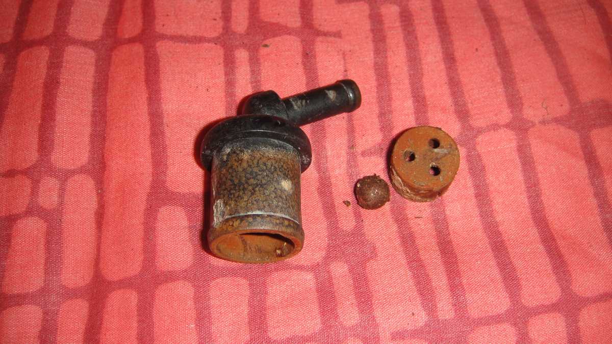

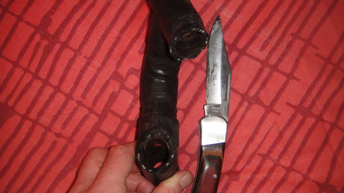

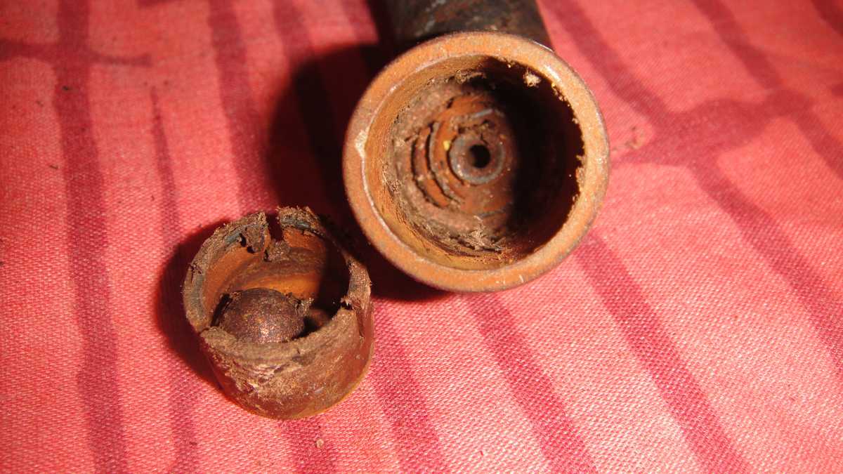

Replied by Leigh Ping on topic Coolant hose split- an autopsy and SHOCK DISCOVERY
Posted 13 years 4 months ago #105800
Another failed hose of the same type being dissected. You can also see the jiggle valve after being taken apart. :dry:
Last Edit:13 years 4 months ago by Leigh Ping
Last edit: 13 years 4 months ago by Leigh Ping.
Posted 13 years 4 months ago #105805
Errr - nice knife Leigh! :dry:
There wasn't much left of my jiggle valve apart from the ball bearing... :bust:
