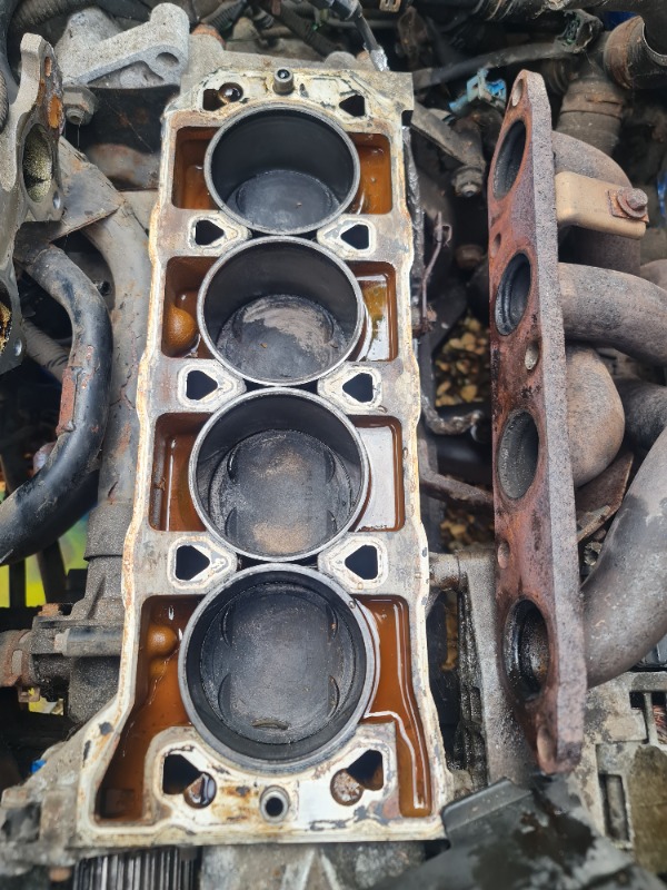

Hopefully the liners haven't dropped too much, but if they have then I will probably need to strip it for spares.
I will know tomorrow and I'm keeping everything crossed.

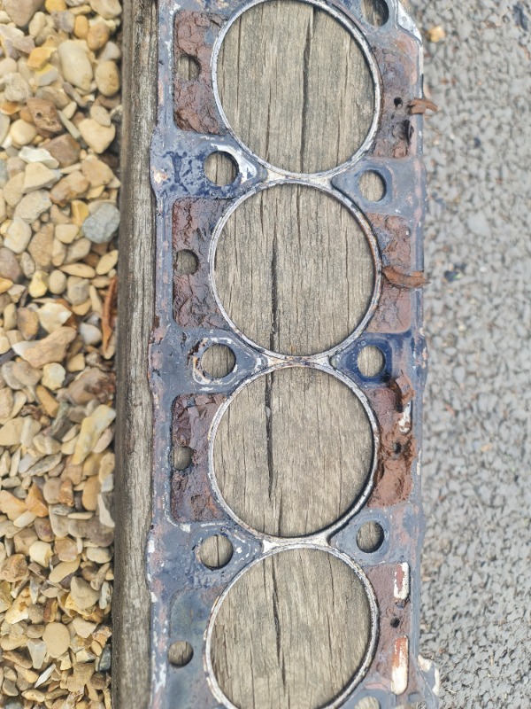

Your thoughts please gentlemen.
Replied by TA22GT on topic Weird coolant problem
Posted 1 month 12 hours ago #223870
From what I can tell with the block the liners haven't sunk.
If you scrape the cylinder head and remove the old crud a straight edge and a feeler gauge will show any warps. I doubt there will be any because I think it was caught in good time.
My gut feeling is that both the head and block will clean up and a new HG will do the job.
I know it"s easy to say from where I am sitting!
Replied by Cobber on topic Weird coolant problem
Posted 1 month 10 hours ago #223872
As TA22GT says, check the liners are sitting OK, give the head, valves and block a good clean up, wave the straight edge at it and slap it back together!
I've seen much worse, come good with a little love!

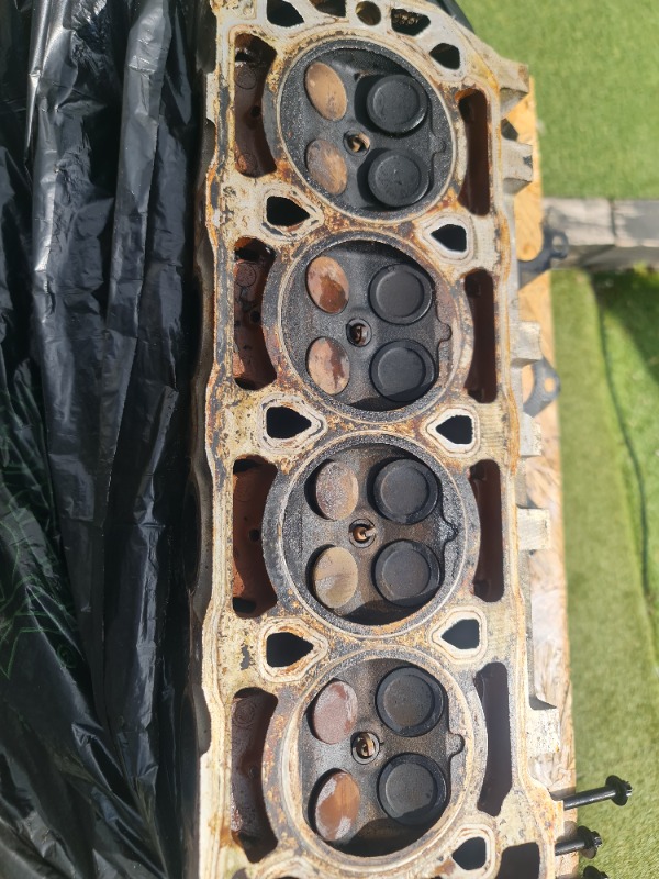

Replied by Charless on topic Weird coolant problem
Posted 4 weeks 1 day ago #223878
If you want to clean the crowns I recommend painting Reddex on them to soften the carbon and then scraping off with a piece of bamboo cane cut like a chisel blade and vacuuming the bits. Bamboo is hard enough to apply spot pressure down in the cylinder and soft enough not to damage the crown surface; it can be recut if it wears down.

Replied by D4KGP on topic Weird coolant problem
Posted 4 weeks 1 day ago #223879
That doesn't look too bad, as others have said give it all a good clean (get most of it off then into the dishwasher) check for warping, new gasket and stick it back together. Good luck.
Replied by Notanumber on topic Weird coolant problem
Posted 4 weeks 1 day ago #223884
If the head checks out with a straight edge and the liners havent dropped i think you will be fine as I was.
Replied by Delbourt on topic Weird coolant problem
Posted 4 weeks 1 day ago #223885
You might try “nylon pan scrub”.
I bought a set from Halfords for just such a job. I wrapped the coarse grade around the end of a 1” steel scraper. Then finished off with the finer grade.
Yes, it took some effort but it did the job.
I’m sure there might be a more appropriate grade of “pan scub” but I have yet to locate it even though I know it exists.
