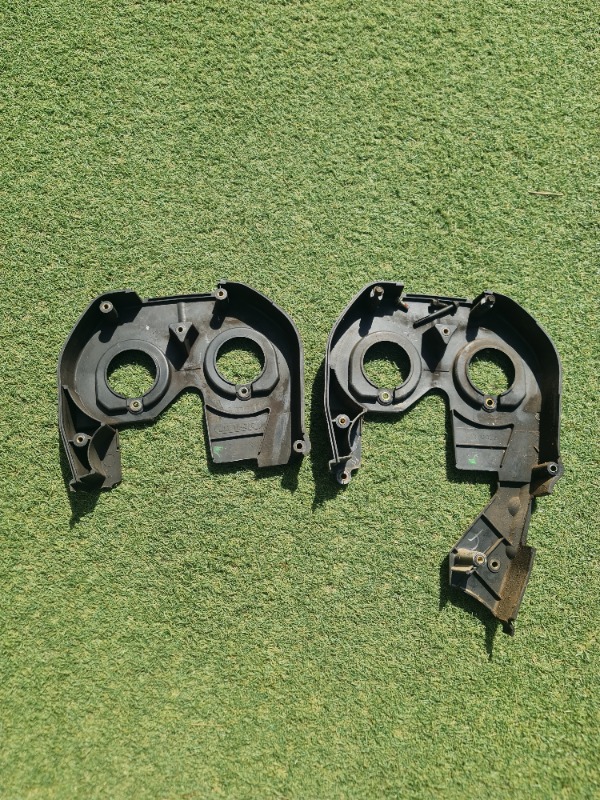

I found another bodged job.
How hard would it have been to remove the 2 extra bolts rather than butchering the cover 🤔

This isn’t the first of this particular “upgrade” I’ve seen, in fact I have an example on my car; not of my making.
If you work & charge by the clock, short cuts (shit cuts) such as this might save a minute or two a day.
There’s never enough time to do the job properly, however there’s always enough time to do it again.

Someone had done the same to the covers on my 135. I had to replace all the parts of the cover as theyd all been cut to buggery. To top it all they had thrown out the exhaust heat shield in order to run a length of bar from an exhaust manifold bolt over to the top corner of the belt cover as the only way of stopping the considerably weakened plastic from rubbing against the cam pulleys.
