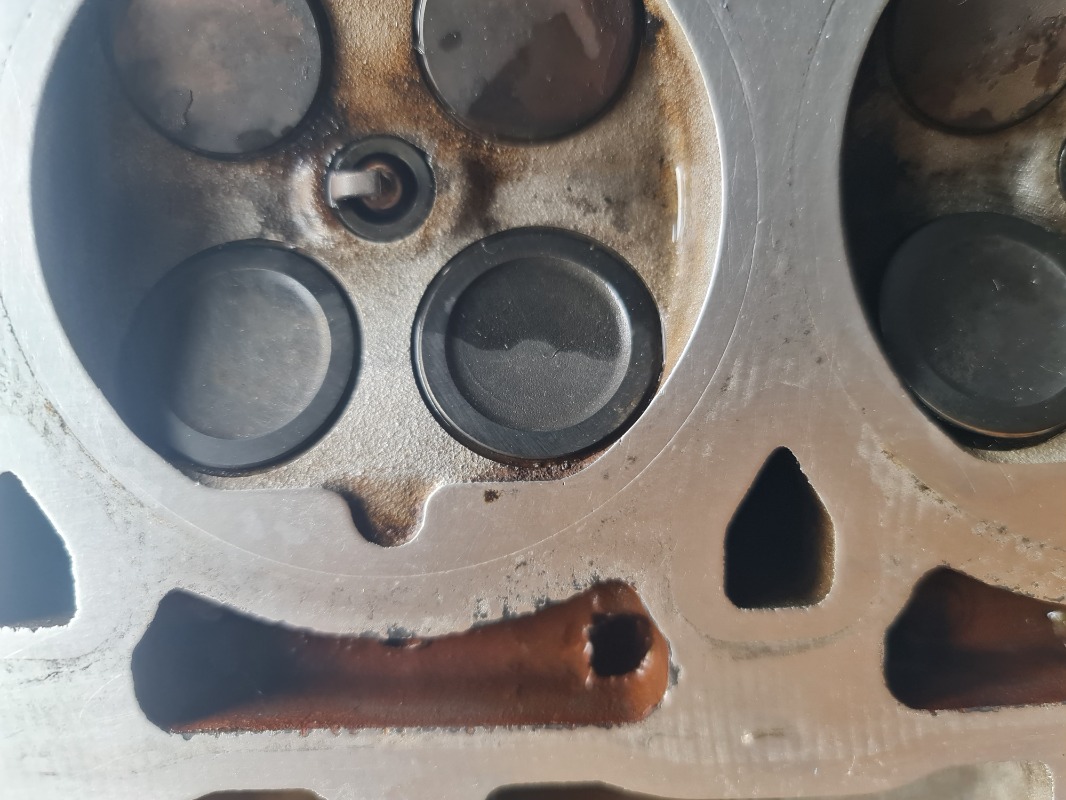

I'm not sure that I could get away with putting the head in the dishwasher atm but I like your style 😎
The liners are proud of the block but only 1 of them is below 2 thou.
The head is flat,...but it has some pitting.
I will give the elastomer gasket a go.
this is the worst part.

If that was my head I would be using it.
I would take a small file and file the edge of that waterway channel just to take away some of the pitting. At the moment it is perhaps a way for the water to seep under the gasket.
Just file the very edge slightly and you will be surprised how much better it looks.
The gasket has plenty of head to seal on.

Doesn't look so bad, but I agree with TA22GT a fine file on the edges of water channels. Elastomer gasket and a fine bead of sealant should see you ok.

One of the benefits of the MLS head gasket developed by MG Rover's Powertrain division (compared to the SAIC-designed MLS gasket), is that it included a shim that went against the cylinder head that would seal minor imperfections in the head such as seen in the pictures you attached.
If it were me, I'd open up all of the partially flashed over coolant passages in the head using a Dremel with a carbide burr bits to gently cut away the flashings to improve coolant flow throughout the head.

Some great advice here 👍
I'm going to check the liner heights again, just incase there is a possibility of using a mls gasket.
I wasn't planning on using sealant on the gasket, is it recommended?
And the scotchbrite..wow! I couldn't even use my thumb print to unlock my phone after using that.
