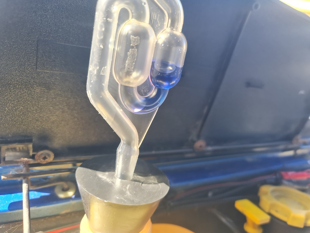

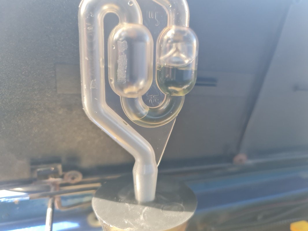

I replaced the coolant cap and everything seemed fine, even during the recent hot weather I had no issues with alarms or overheating on a few long runs.
However.. the car has now developed a misfire on start up, really noisy lifters ( unit warm)..and the coolant problem is back!

Well I was hoping for a better outcome but..
I'm glad that it's happened before the lady got her car back.

Posted 1 month 1 week ago #223795
Its not a nice moment of realisation at all. Will you plan to get the head off next ?

Posted 1 month 6 days ago #223799
Yes I will be.
hopefully I don't have any issues with liner heights.
