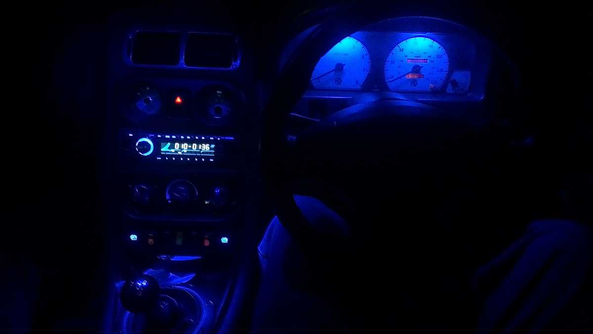

sometime ago i tried putting in some blue LED bulbs but had such poor results with them i took them out and put in red ones that were a bit better so i left them in. So now i have found the reason why i set about removing said bit of yellow plastic to see what difference it would make and heres the results,

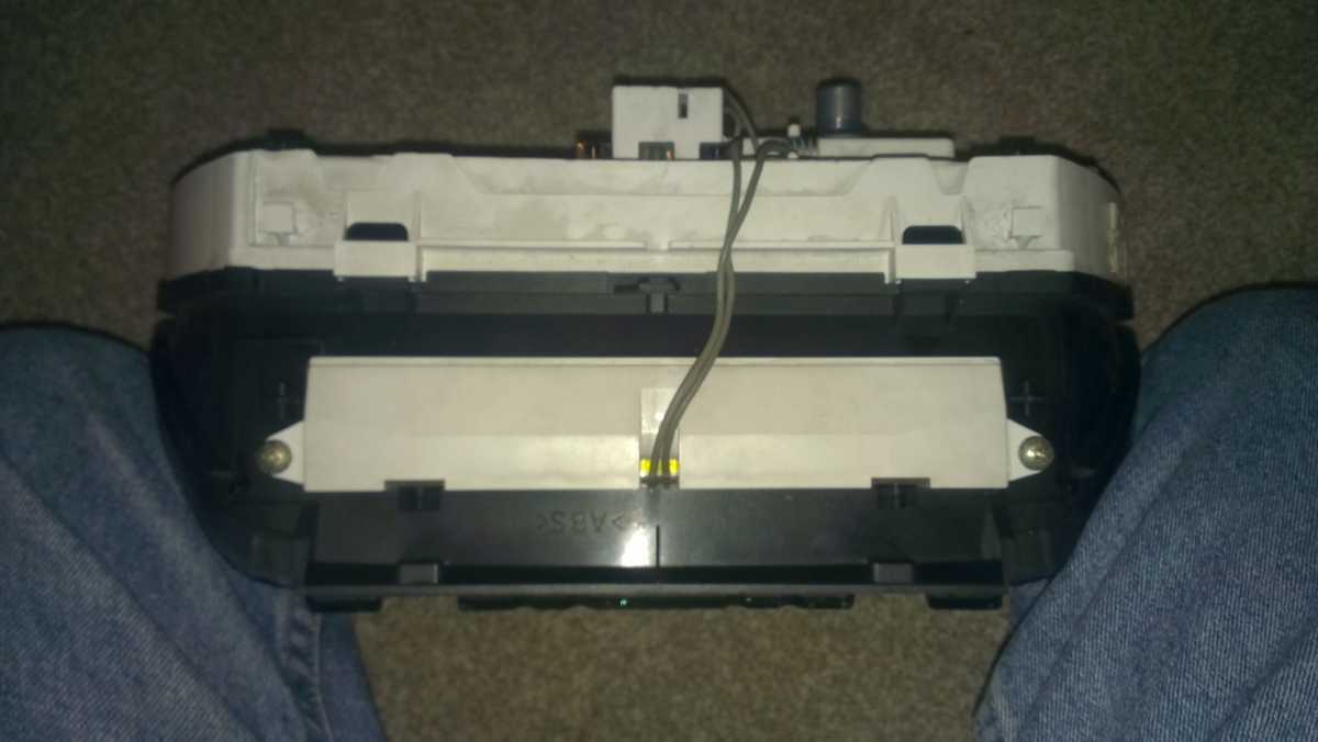

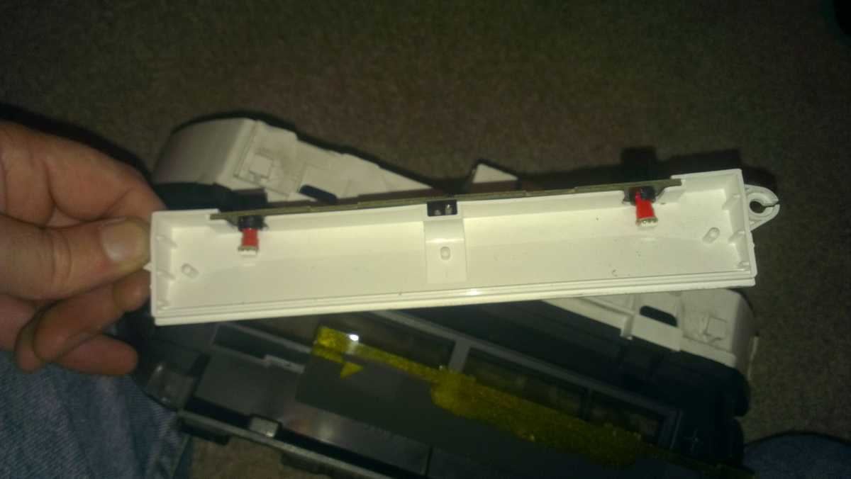

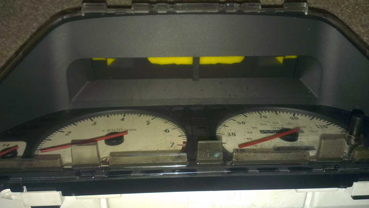

follow this guide here on how to take the instruments out.. or if you cowel is broken like mine all you need to do is take of the instrument cowel surround then undo the screws on the front that hold the cowel on. this then enable you to see the top of the instrument panel without having to take the whole thing out. the top looks like this

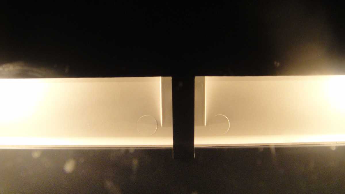

if you look from underneath you can clearly see the filter lens

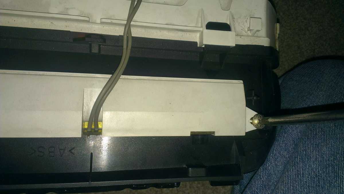

shocking isnt it.. so from the top undo the two screws that hold it in.. yours will also have a metal strap (support) bracket on that you will need to put back on when done.

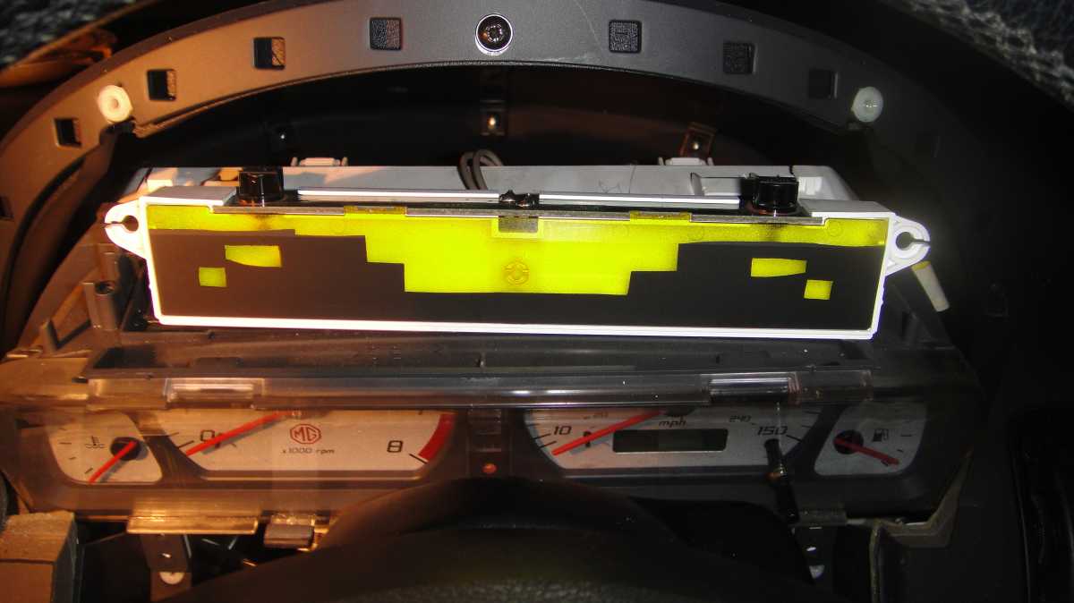

lift the panel you just unscrewed

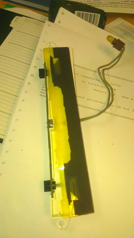

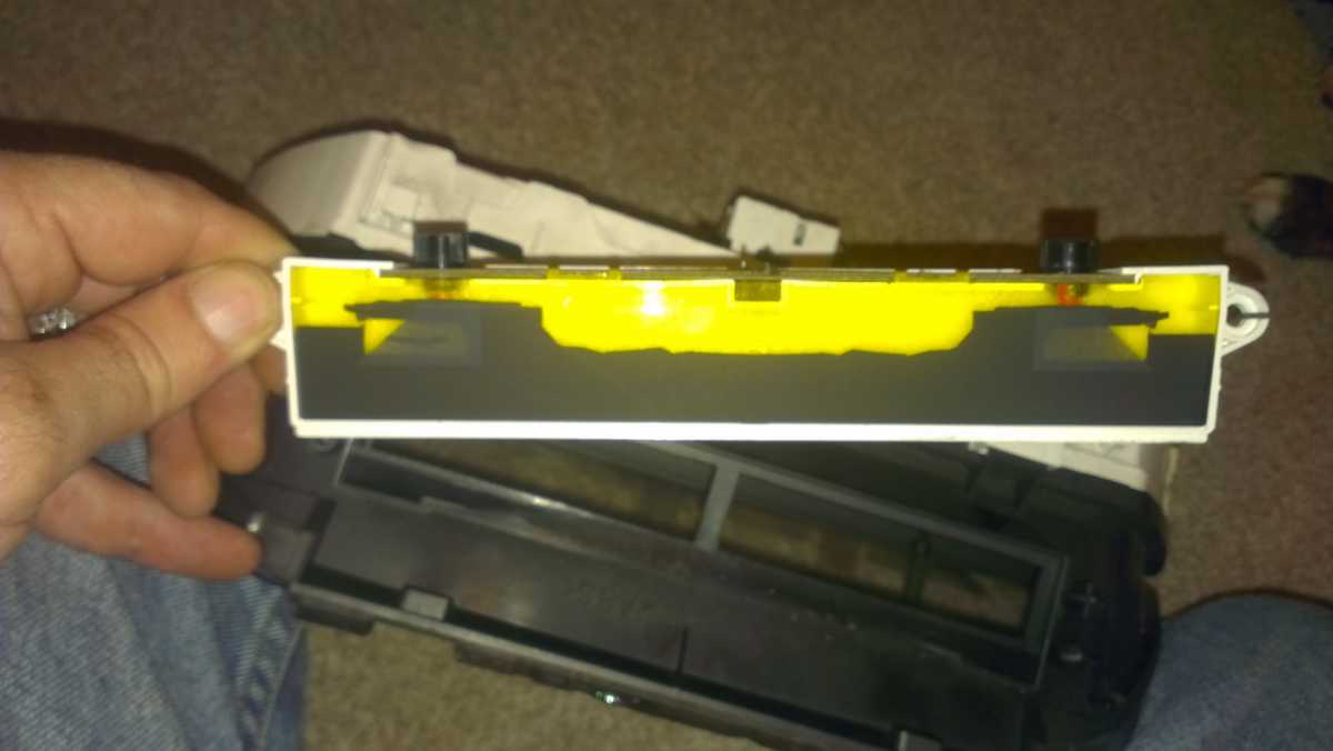

then just pull off the yellow lens so it looks like this
now there wont be anything diffusing your bulbs..
now put it all back together and enjoy the dramatic improvement it truly is 100 times better

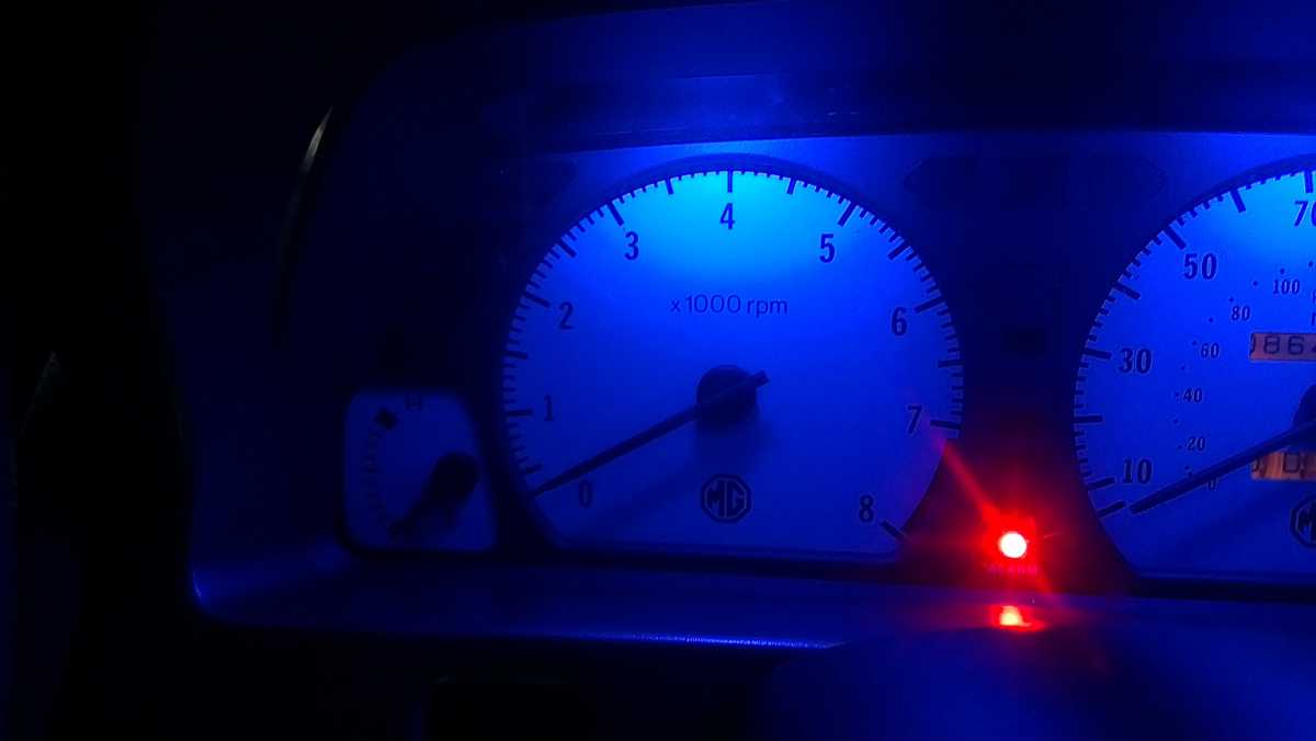

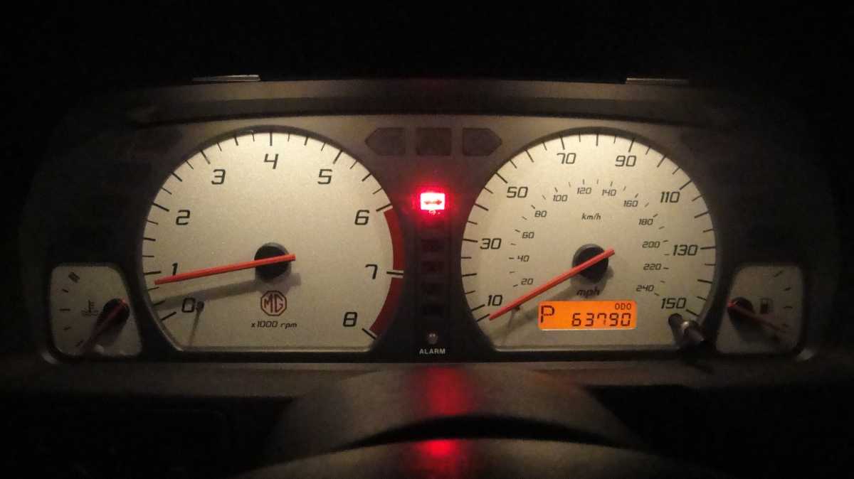

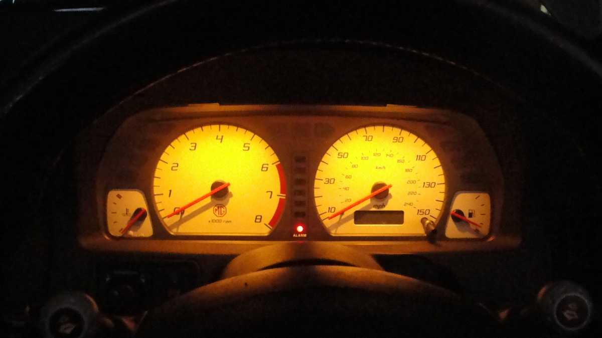

just been out to take picture now its dark so get the full effect now * this is how i wanted it to look at the begining

Great mod I did this a couple of years back.Looks much better than the crappy yellow dim effect MG Rover went for.

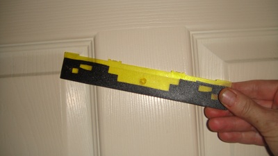

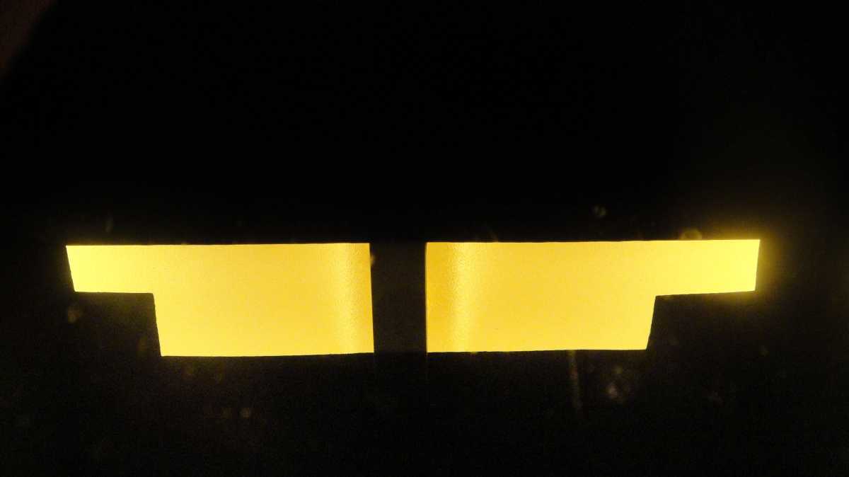

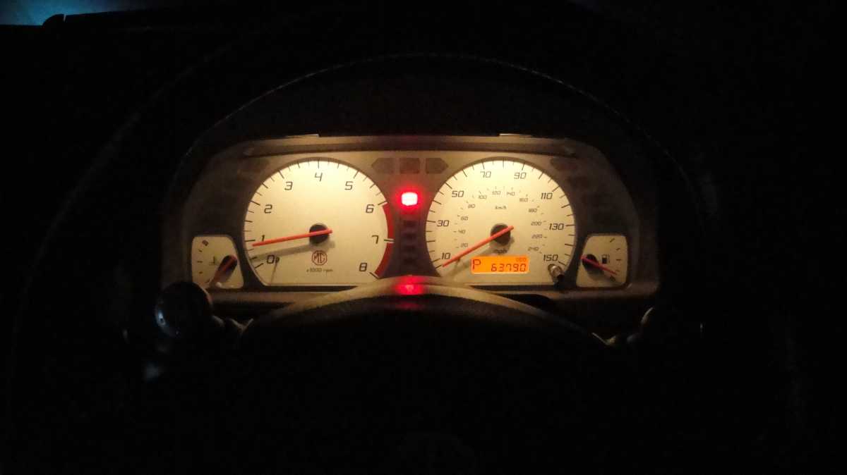

I didn't need to take the steering wheel off but I did lower it with the adjuster. 10 screws later I was able to remove this yellow plastic lens -

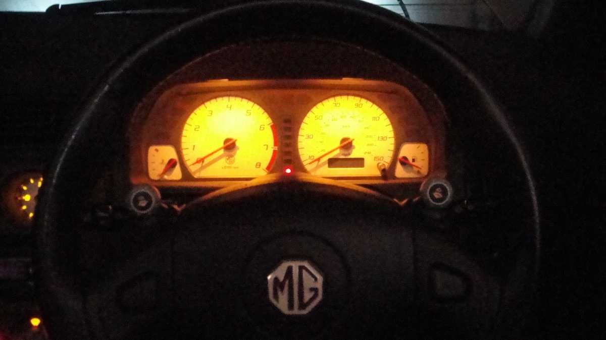

Before -
After -

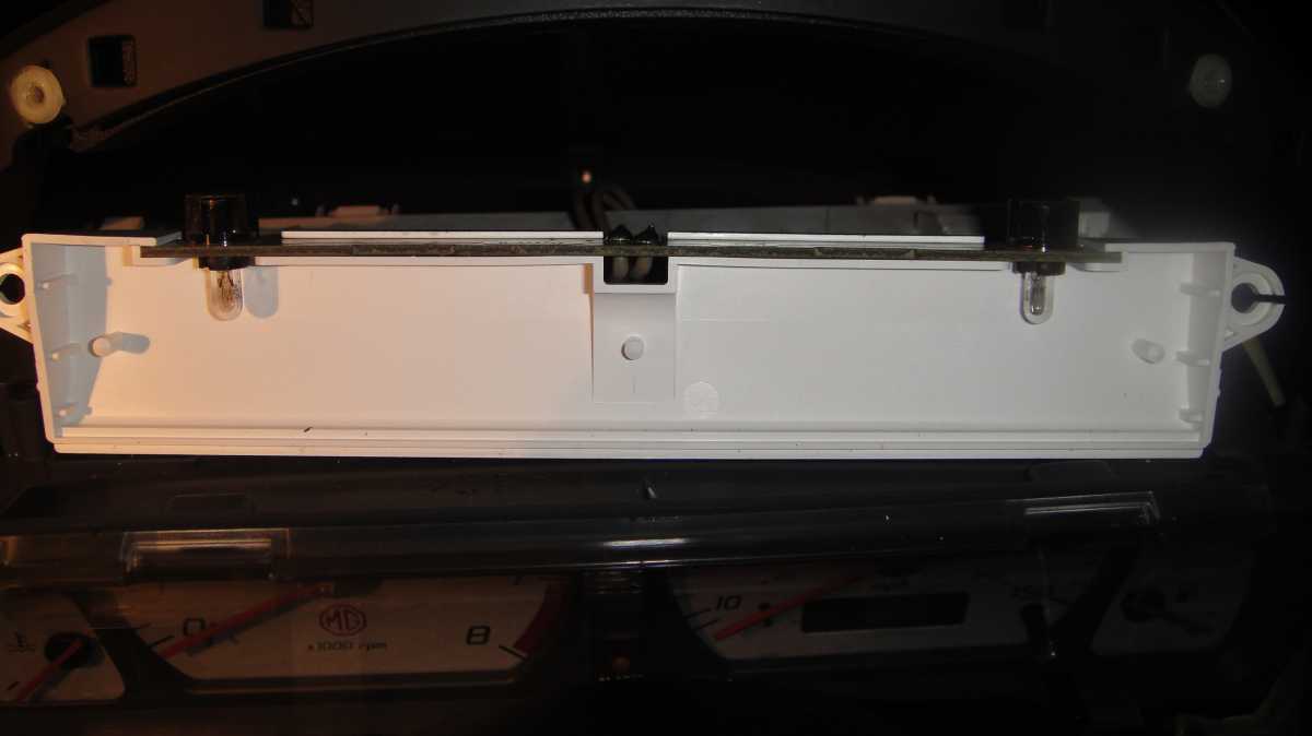

Here's what it looked like before. (This view is looking up to the area above your speedo.The light shines down onto the instruments).
Before -
After -
Here, you can see the difference made.
Before -
After -
Before -
After -
The job's a good un! :broon:

Nice to see the silver clocks silver :broon:
