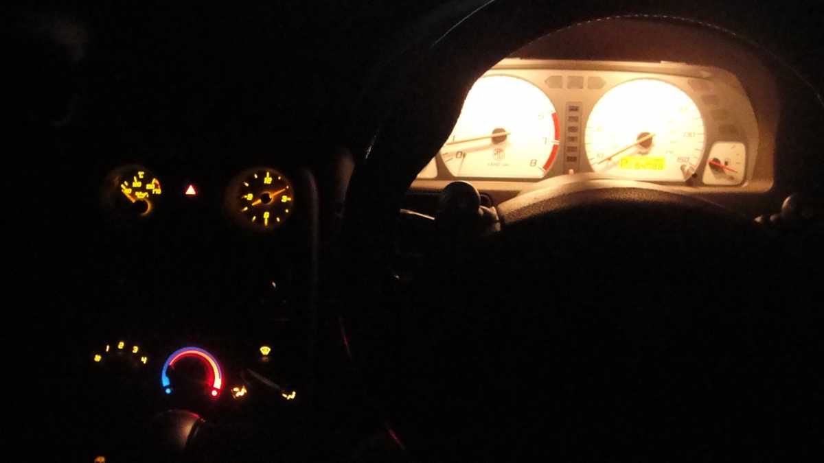

richandpaula wrote: One thing that really gets me is the poor illumination of the dials.
I'm really tempted to do this mod, but how does it look against the other 2 dials in the center console?
Nice to see you around Rayb. :)
They look like this against the other two dials Richard. Best I could do at short notice. :)

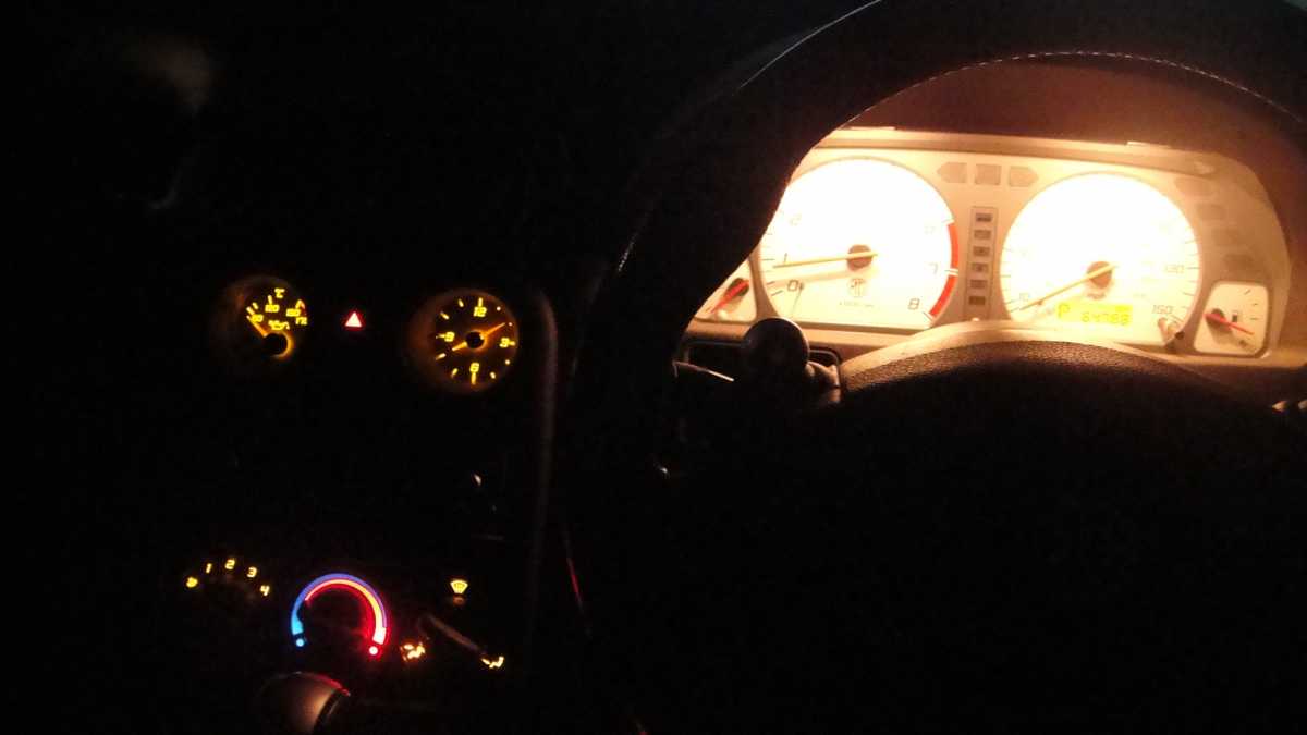

Replied by TruckerClarky on topic Improving instrument display illumination.
Posted 13 years 5 months ago #101893
Thats how mine looks now, rather than feeling like I am looking through a pint of lager :beer: :beer: :lol:
Replied by richandpaula on topic Improving instrument display illumination.
Posted 13 years 5 months ago #101916
That looks not too bad at all then, thanks for the photos.

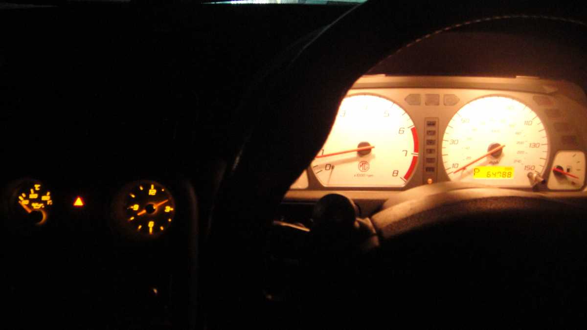

I've just done mine too - I was a bit dubious about this at first as someone went to a lot of trouble to design that filter with all the little cut outs in the black and also I drive around here with no street lighting so I ldon't like the instruments to be too bright and distracting. However, if you exercise moderate care taking the filter out, the whole thing is reversible and it only took me 20 minutes taking it steadily (wheel left in - I just wiggled the cowl around it). The results in a blacked-out garage seem really good....the lighting is more even over the instruments than before especially the water temperature and fuel guage which previously always looked dim against the 2 bigger instruments. There is still plenty of 'dimming' left in the rheostat. So a 'free' upgrade. Thanks to everyone who has posted on this.
Richard
PS added an 'after' photo with the rheostat mostly down and the camera at -2 .0 EV and with the white balance adjusted for the lights.....this looks pretty close to what I'm seeing.

Replied by Leigh Ping on topic Improving instrument display illumination.
Posted 13 years 5 months ago #102928
Jack of Hearts wrote: Just finished doing this myself and I'm surprised I've never done it before. I really like it!
wendyej wrote: I'm definitely going to have a go at this one. Great stuff.
Thanks for the pic Richard. It's a good, reversible, cheap and easy enough upgrade mod to do, with real safety benefits, especially during these dark winter evenings. :broon:
Don't forget to take some pics 'before' and 'after' folks. :yesnod:
