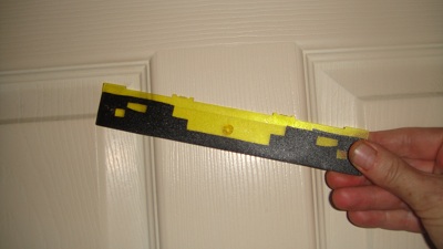

Replied by Leigh Ping on topic Improving instrument display illumination.
Posted 13 years 5 months ago #101802
mgfnortheast wrote: It had the same yellow shield, its a really easy job and looks much clearer.
Its so much brighter I dont have it turned on full.
This the TF light shield I removed. Before and after pics showing the difference made are on the previous page.
