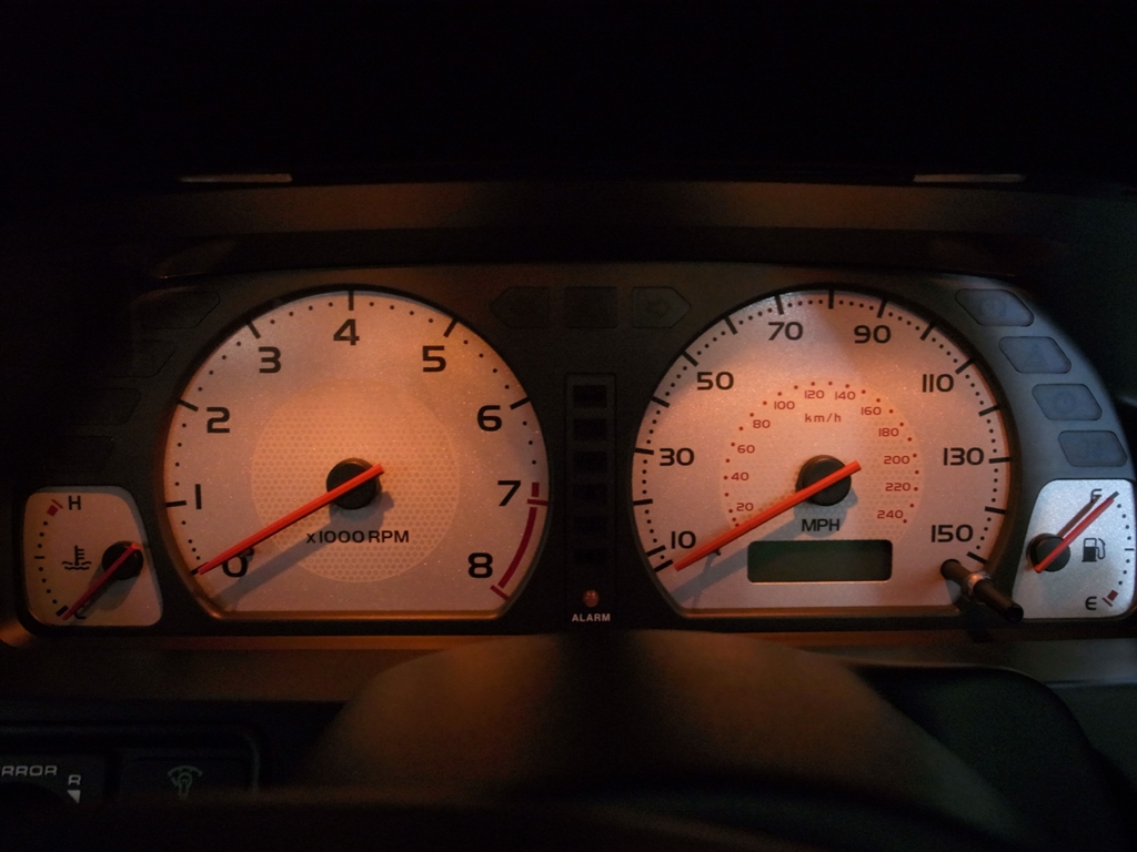

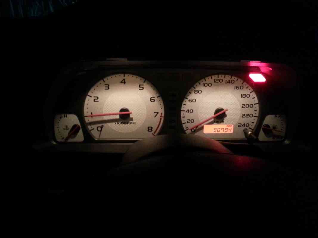

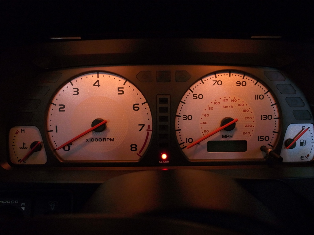

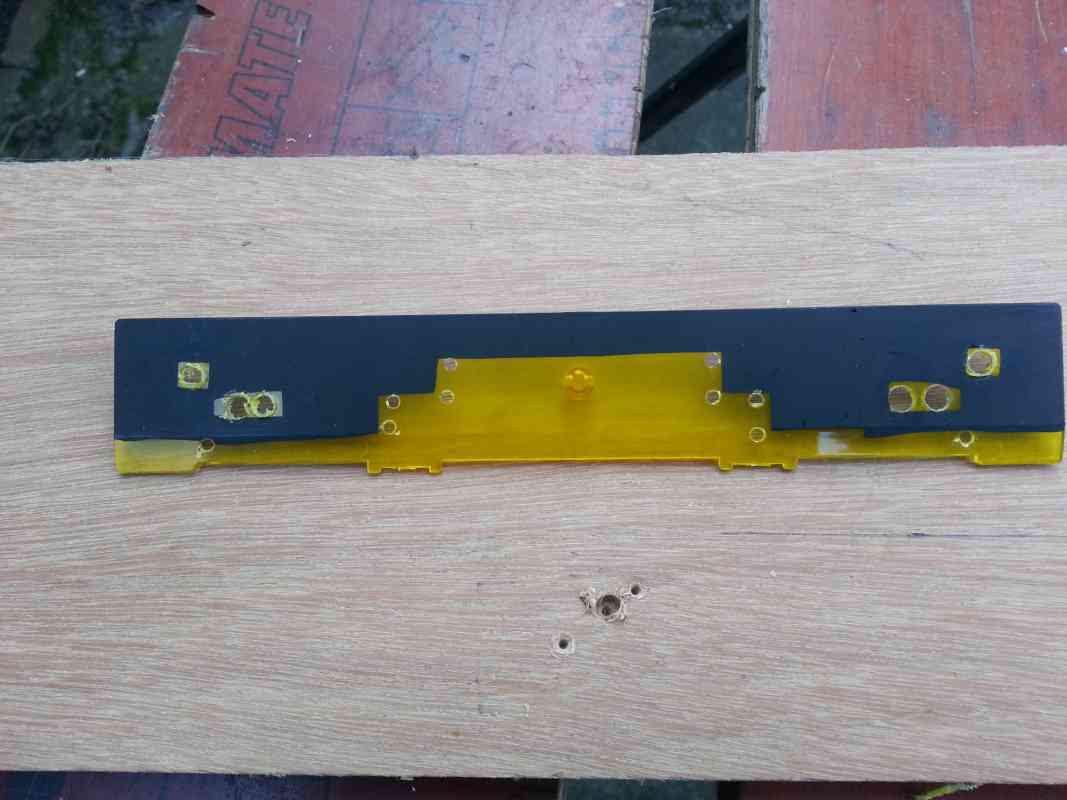

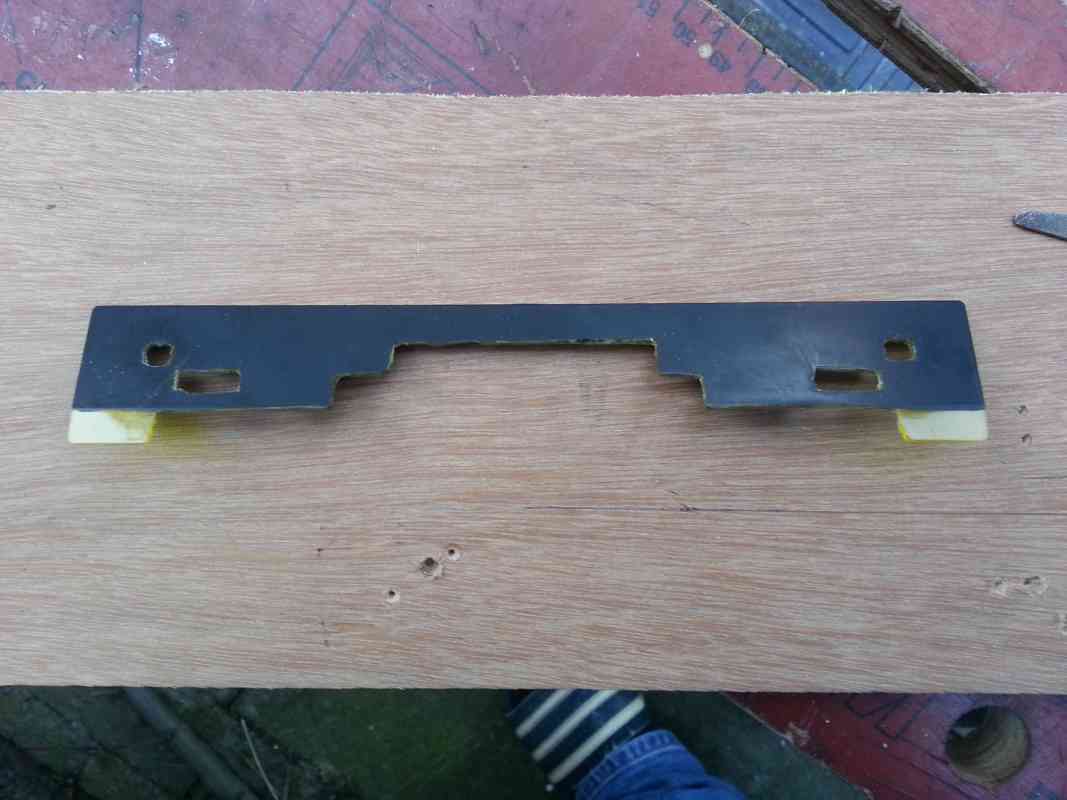

Last year I removed the instrumentpanel lighting yellow pate and this for sure improves the visibility of the instumentpanel.
But I found that the light was a little unsubtile. IMO the blind pattern of the plate isn't without function.
So I wanted best of both worlds... I'm confident with the result.
After removing the plate:
The 'mod':
The result:

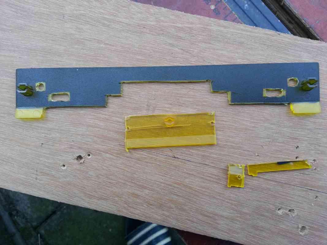

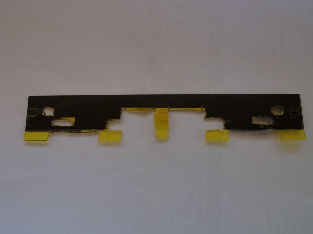

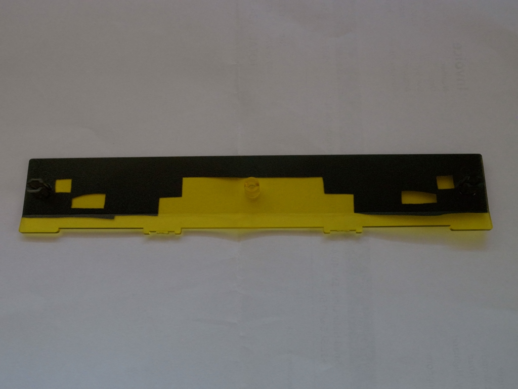

I did DD's mod today but with a small variation.
Here is my original filter which I had removed ages ago. The filter is a yellow piece of plastic that then has a black-out cover applied to one surface.
I decided to try and retain all 3 of the central lugs plus all 4 of the base tabs so with a drill, dremel with cutting wheel & a file removed most of the clear yellow:

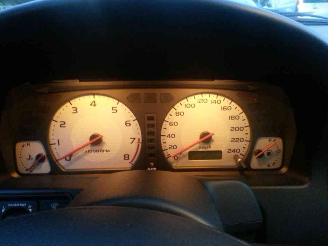

Here are pictures of the results taken in the garage today. I can't completely close the door from the inside so please ignore the right hand side of the pictures where there is some day light. The main point is a comparison between how much light spillage there is with & without the filter.
This is without any filter:
And this is with the modified filter:
I think as DD suggested, the black bits on the filter do a useful job in that they reduce the amount of light greatly that spills on to the black instrument surround. The end result is a greater contrast between the lit face of the instruments and everything else. I shall be interested to see how it looks in total darkness but I think this is the way to go.

Replied by The driving dutchman on topic Re:Instrument panel light
Posted 11 years 1 month ago #158857
Good to see you're on the same result Blow-in.
