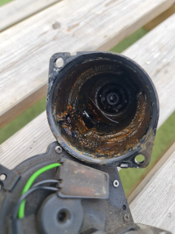

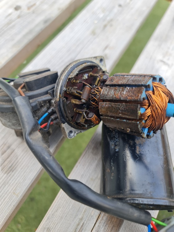

I posted about having a noisy wipers motor a few months ago and AP recommended that I strip the motor as it could be full of crud.
He was spot on.

Thanks for the pics.
Mine was totally clean inside so I think it is the bearing.
