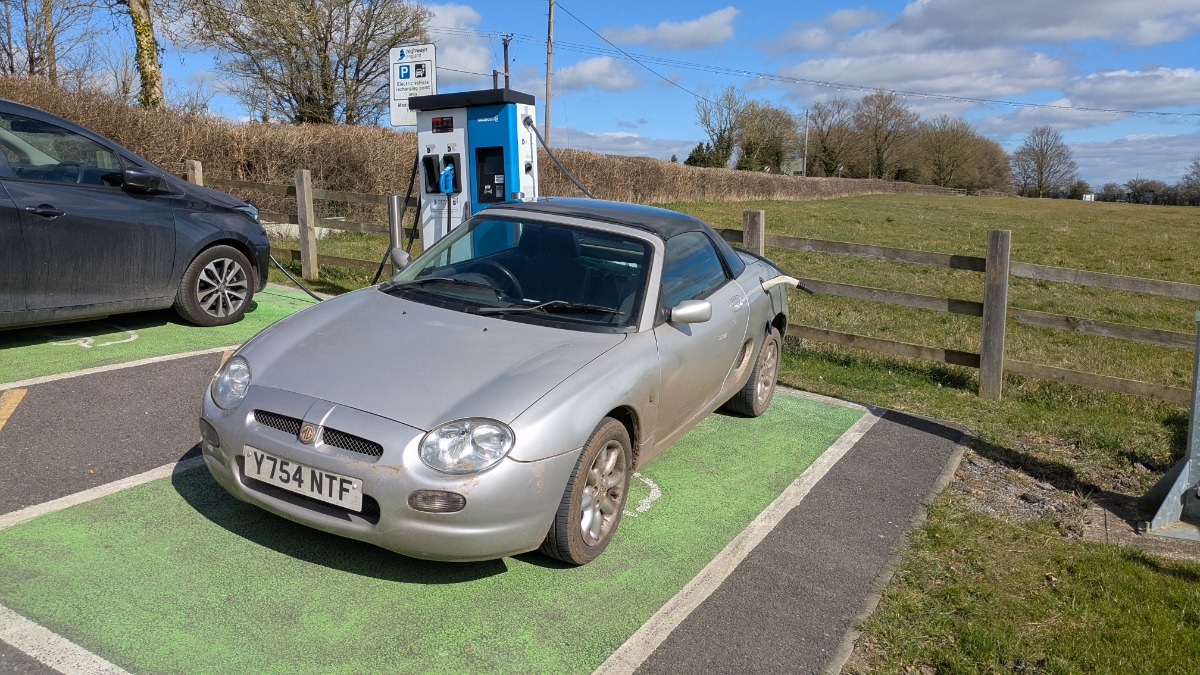

Thought I might put a bit of an update up since it's been a while!
The MGF is still going strong, recently hit 21,000 miles since the conversion. It's still my daily driver all year round. Given me no real trouble apart from the usual things you get from driving a 25 year old car.
Still no heater, although I have done 90% of the work to install a water heater from a modern electric MG. Just need to do the last bit of wiring into my canbus network and do a bit of coding. What I have been doing is preheating the car in the mornings with a fan heater on an extension cable, give it 20 minutes before I leave and the cabin is nice and toasty for the first couple of miles at least!
Picked up a hard top for it last year which does make it a little warmer in winter. Also got some individualising valves for the suspension so it's finally back to a level ride height.
Here it is from last year, just after I picked up the hardtop.
by LRBen
The following user(s) said Thank You: mowog73, ronnie_space

What is the strange dildo thing hanging outta the fuel filler?
