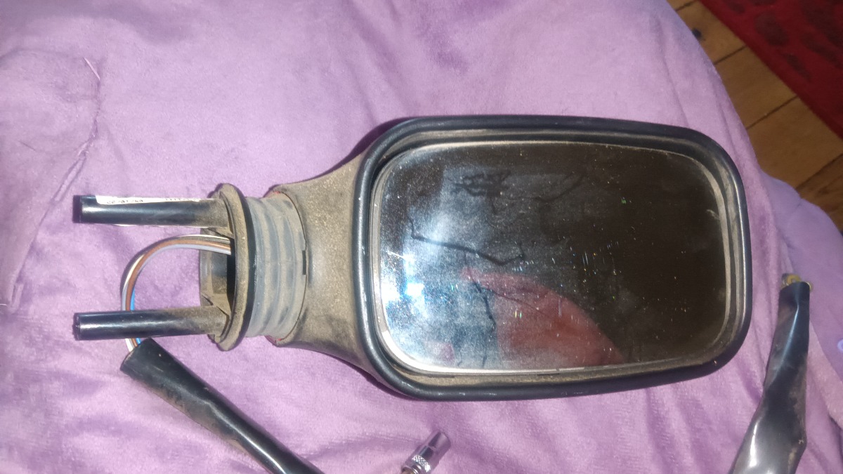

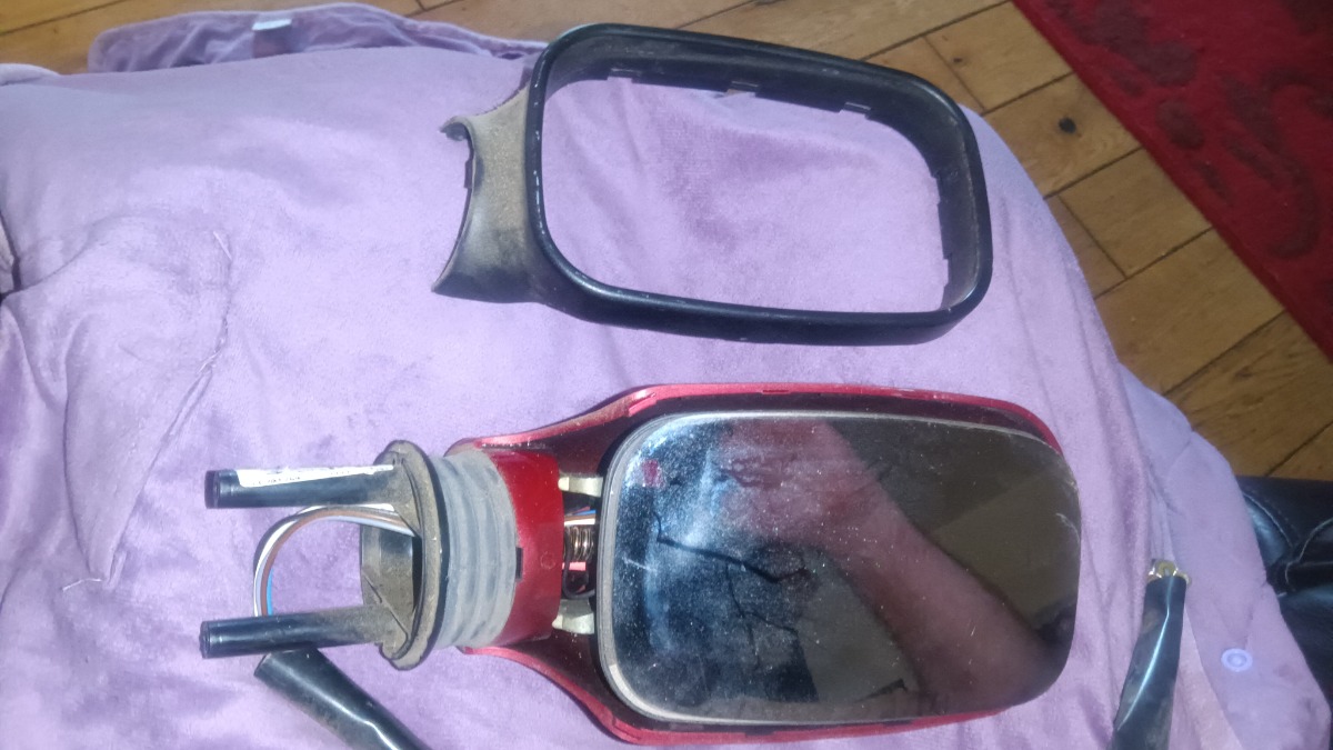

Replied by David Aiketgate on topic Red paint peeling
Posted 1 year 10 months ago #208270
The colour coded back is NOT removeable, it is an integral part of the mirror. The black plastic surround is removed with the careful prying described.
To remove the painted part you will need to remove the entire mirror assembly.
Posted 1 year 10 months ago #208271
There is a how to in the list for more info/pictures. How to
Posted 1 year 10 months ago #208274
Not an issue, matey. I only know because I went into my mirror repair many (14!)years ago with the same thought that the painted back must come off.
On the positive side your comment made me look at my old 'how to' to confirm my memory, and realise the photos had vanished.
luckily, being a bit of a packrat, I had kept the nightfire red mirror ( never know when that will come in handy!), so I was able to make new 'how to' pics to complete the old 'how to'.
