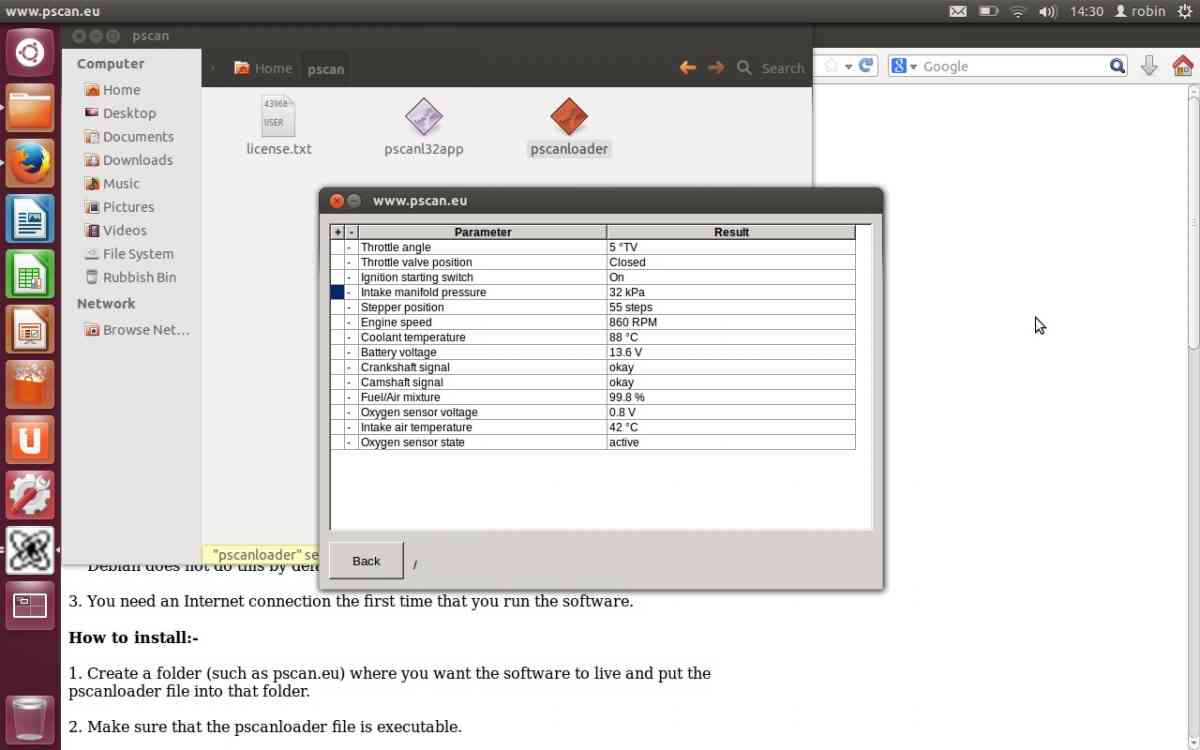

Got my kit on Monday and ordered a cheap Linux based laptop from ebay that arrived today. All connected up, all appears to work as described.
Cleared some historical codes and watched some live data though not sure what the readings are supposed to be just yet. Anyone know what the correct values are for the following table for example?

Replied by David Aiketgate on topic Kickstart project for a Diagnostic tool
Posted 11 years 9 months ago #151617
I take it you don't have a cold air feed.
Replied by cairnsys on topic Kickstart project for a Diagnostic tool
Posted 11 years 9 months ago #151618
I have an enclosed cone filter with the intake routed just in front of the gearbox because I didn't want the hassle of removing the resonator box. One day I may get around to bringing it out to the side air intake. The car was stationary while logging so there wasn't any air flow. I'm guessing that this explains the quite high intake temp.
The ones I'm really interested in are the intake manifold pressure, fuel/air mixture and oxygen sensor voltage, all at idle.
