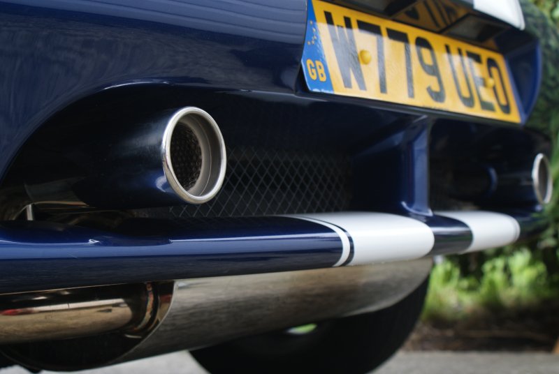

The looks; nice oval pipe finishers which are quite stylish but a bit on the small side.

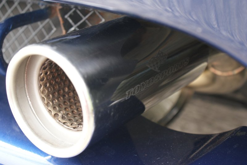

2) The Toyosport.
After you first install a new Stainless Steel exhaust you will find that it takes a few weeks to really settle in. The sound changes over time and you also become accustomed to it and begin to know how to ‘play’ with the various tones it produces.
The Toyosport produces a deep rich low tone which grows in volume as the revs rise. If you push it hard it begins to roar louder. When you step off the gas it produces some wonderful burbles and pops over a wide range. Whilst just driving slowly around it keeps playing its low tones without the need to give it extra gas, although it is very tempting to blip the throttle and let out a gentle little deep roar every now and again.
It is louder than the standard exhaust when cruising on the motorway, but not too loud. There is a bit of a drone but it’s something you quickly become used to and is not annoying like the ones mentioned above.
The looks; large 3” round finishers with the Toyosport logo on the offside pipe.

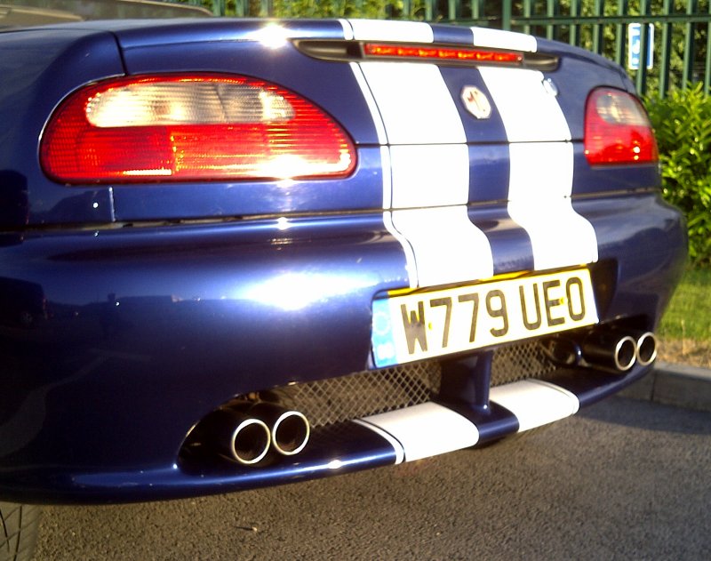

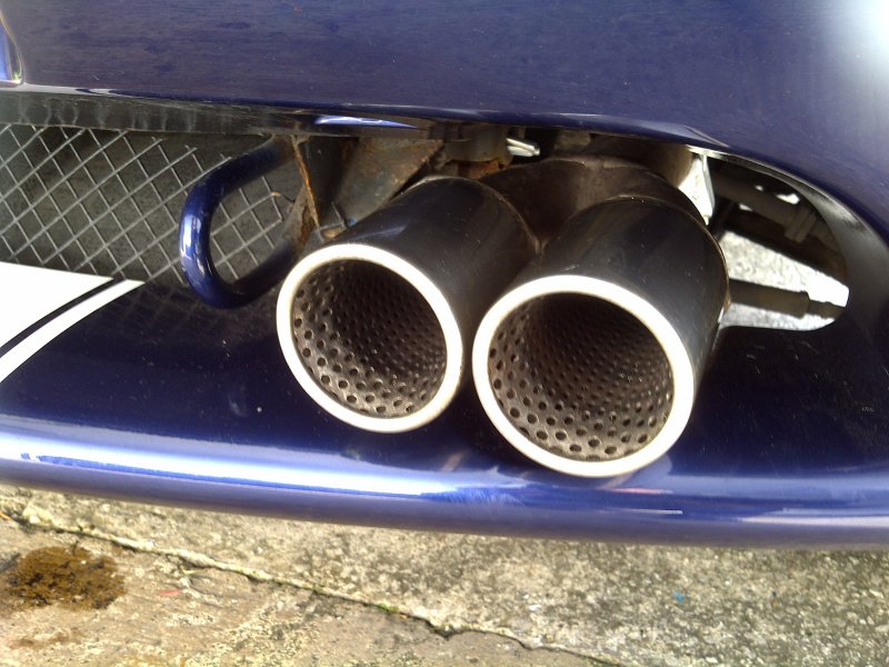

It may come as a surprise to some but yes, I purchased a used Daytona, with quad finishers, which I have been using for the last week. At start up I have found the Daytona to be quieter than the Toyosport. The Daytona box is quite a bit smaller than the Toyosport, with smaller inlet/outlet pipes which goes some way to explaining why the Daytona is not as deep.
The Daytona remains quieter until you start to push the car, the Daytona then comes alive producing a wonderful loud wwwrrrrrooooooommmm. This sound is very intoxicating, but when not pushing the car it goes quiet again, you therefore find yourself speeding around, using extra petrol just so you can get the Daytona to sing its tune.
It also pops and burbles, albeit a lot quieter and less dramatic than with the Toyosport, around the 1750 rpm level which is nice, but fades away quickly as the revs drop.
On the motorway, cruising at 70 mph it is much quieter than the Toyosport.
The looks; this is one area where the Daytona excels. It does not have finishers, that is to say the exhaust is supplied with just two short outlet pipes for which you need to purchase finishers. You can thus fit single or dual (giving you quad pipes at the back) finishers or purchase aftermarket finishers, thus the appearance is really whatever you want it to be.
Note: You could remove the finishers of any of the other exhausts and do the same if you wanted to.

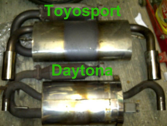

Decat. I was also curious to hear the difference with a decat, so I ran both the Toyosport and the Daytona with one. The Toyosport just became a bit louder and gave out a slightly more harsh tone on hard acceleration. The Daytona became also became slightly louder, however the wonderful tone of its song was altered detrimentally in my opinion and so I don’t believe a decat does any of them any real favours.

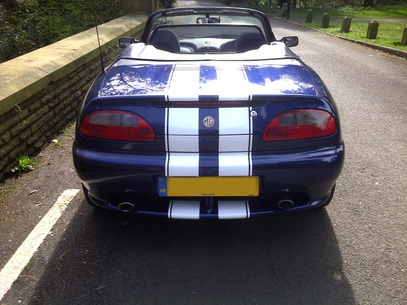

Well, it looks very sexy for sure and a picture paints a thousand words. But there's something missing... the sound. Any videos with noise for this please? :)

With regard to the extra large oval chrome finishers that affix over the small originals, I thought looked silly, because you can still see the small ones through the hole :sick:
