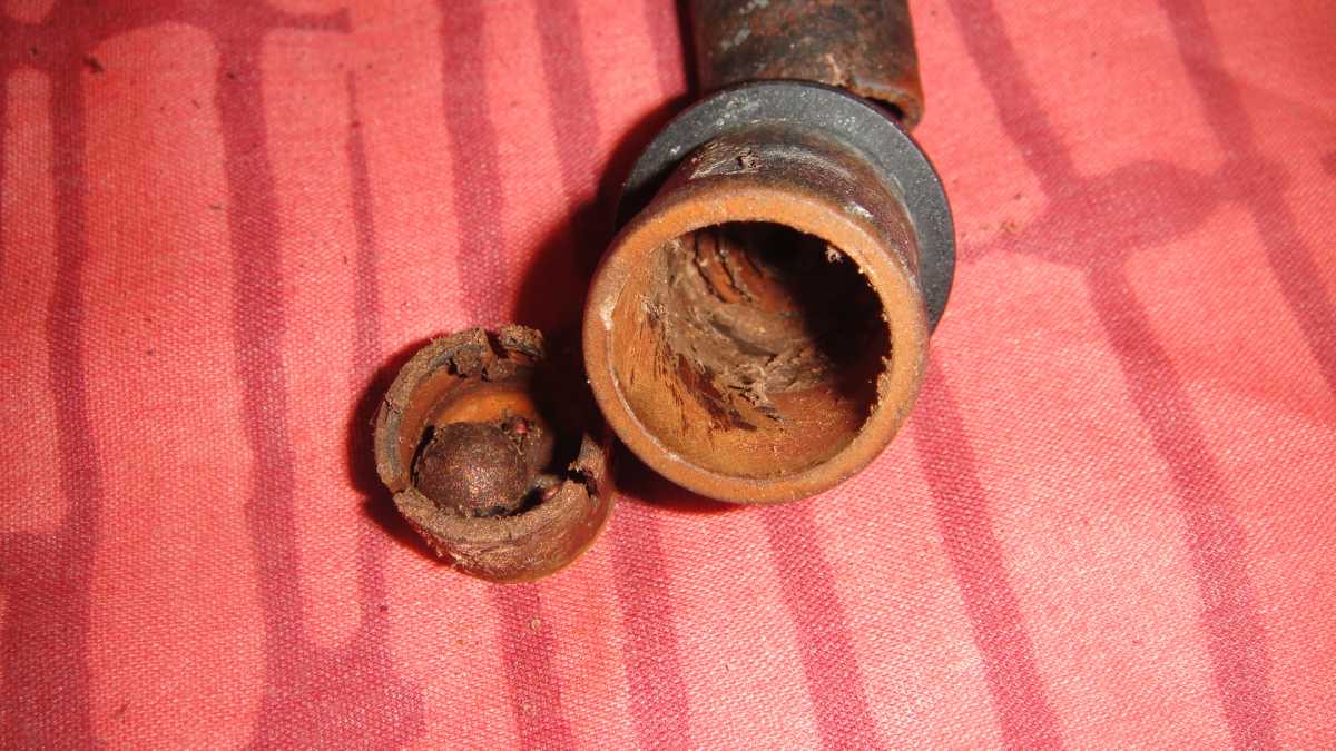

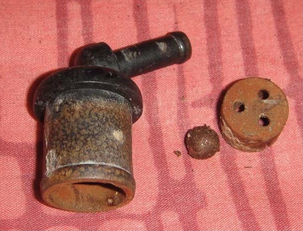

Don’t know about the head gasket, and I have no wish to teach granny to suck eggs. And with my tin hat on, running for cover I add one possible thought which might also be a suggestion if you proceed with the thermostat option.
Are the jiggle valves clear and in good condition? It’s not that difficult to blow down the one at the cylinder head but the other “up and over” item is a bit more tricky I would have thought and might need a few more hoses coming off for inspection.

As they say here are two I found earlier on the web (possibly even off these website pages.
They tell a fairly gloopy picture.

Hi what model of car is that off? I don't recognise it as anything from an F/TF, please enlighten me.
As stated I did not take the photos but searched the web for examples of the valve that allows any entrapped air in the cooling system to make its way back to the head tank.
It is definitely fitted to a TF pre the PRT mods to thermostat position. Cant answer for the Fs.
Across the top of the engine is a small bore hose going into the head tank. If you follow it back from the tank you should come to what looks like an up and over hose at the outlet from the engine.
It should be in there
Jiggle Valve.
Jiggle Valve.
