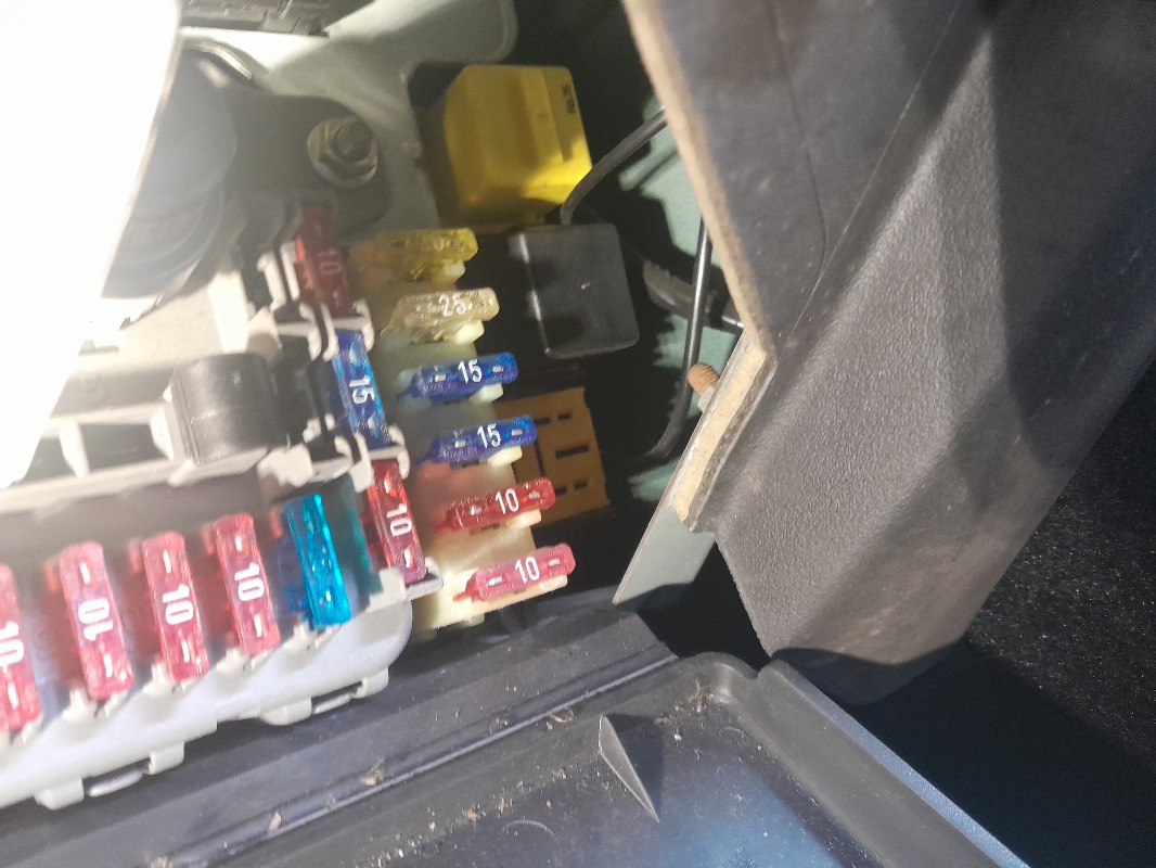

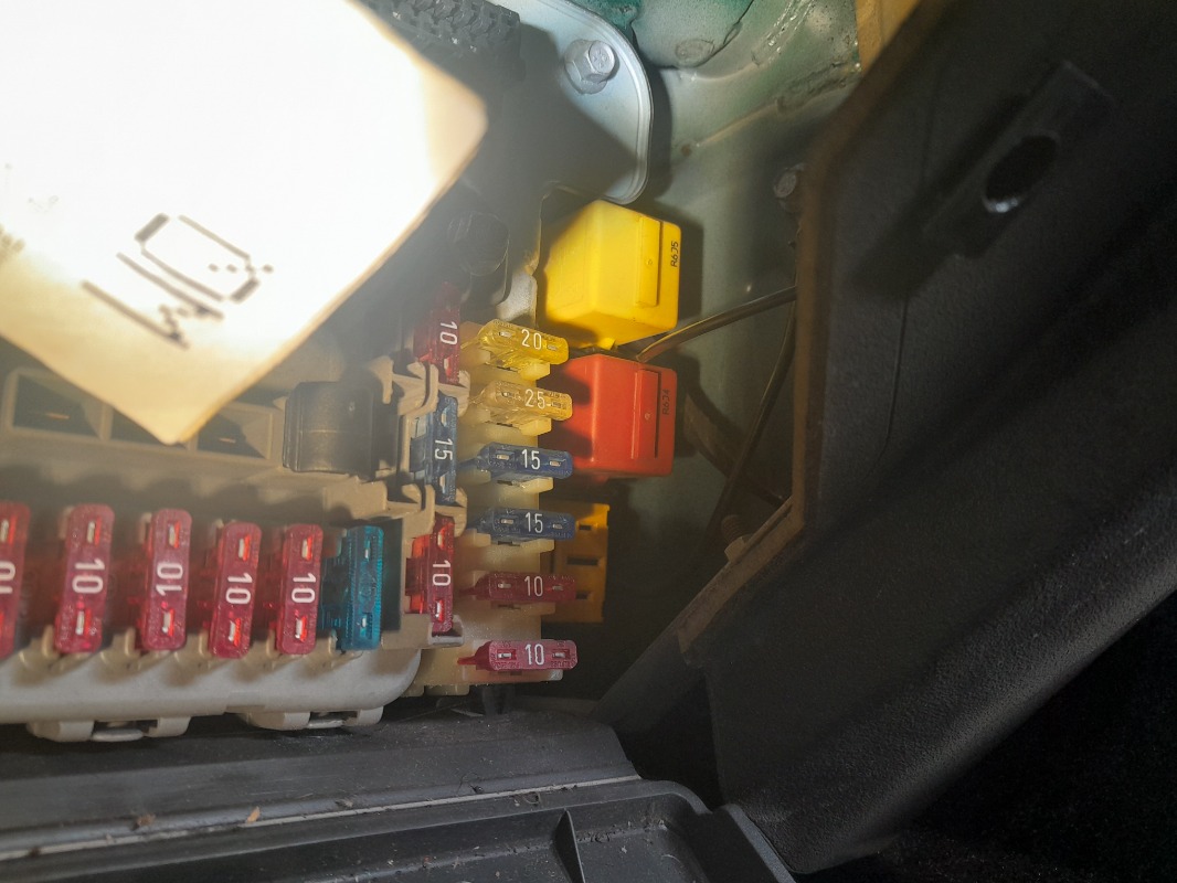

Found the fuse box.
swapped the relay. What a fiddly job getting that out!
same result sadly.

Replied by D4KGP on topic Newbie from Morecambe
Posted 1 year 10 months ago #208304
Yep they are a real pain to get out.
Replied by Airportable on topic Newbie from Morecambe
Posted 1 year 10 months ago #208306
No not a red fuse box, but a red box attached to the rear of the fuse box sub chassis. It’s far from easy to get to & if you decide to bite the bullet, make sure you have a replacement in your hot little hand before you start. Take pictures & be methodical.
