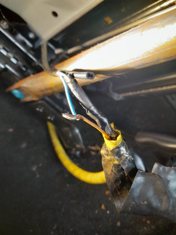

Attempted the seat height reduction at the weekend. I removed the seat and found some wires cobbled together which looked a little naff, not sure I need to worry about?
I assume it's related to the seat belt restraint system thingies? I have no dash warning lights about it.

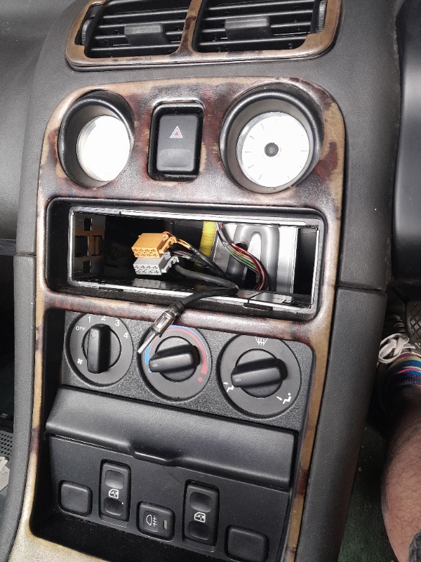

I also popped out the old stereo as the digital screen is past it's best.

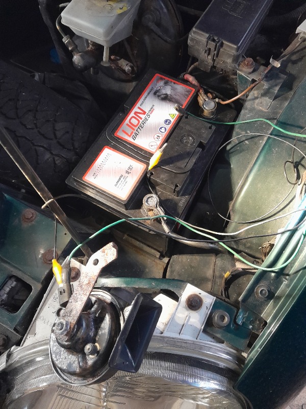

The one main issues i have is the horns. They were both disconnected. I plugged them in and pressed the button and nothing. Should i be concerned why they were unplugged in the first place? Ive not done any further investigations yet as still looking were to start on this new problem

If there disconnected, take a pair of wires from your battery & connect them, momentarily, to the horn, do observe polarity, although it’s not critical. Toot is tremendous, however you’ve got more hunting to do if all is silent & that could include looking at the red box behind the drivers side fuse board.
I recommended replacing this box to a chap who had no horn (poor thing) & it turned out not to be the box but two duff horns. If you have tested the horns then you’ll not get tangled up in that loop.
That wiring is rubbish, cut it out & use some terminal block until you find the correct connector. You have an early f, try & find one of a tf or a Rover 35 etc.

Hi I'm surprised that you don't have any warning lights on with regard to that under seat wiring, they are part of the SRS system and if there is not a sound connection the SRS YELLOW warning light will come on in the dash as soon as the ignition is switched on. Disconnect them then switch ignition on to check if the warning light comes on, it should do if the system is working.

Just a word of warning re SRS (Suplementary Restraint System - airbag and seatbelt pre-tensioners), don't muck around with anything to do with the SRS without having disconnected the battery and leaving it for a while first.
Early cars have different connectors under the seat from later cars. It could be that somebody replaced the seats at some point and soldered the wires in preference to swapping the pre-tensioners.

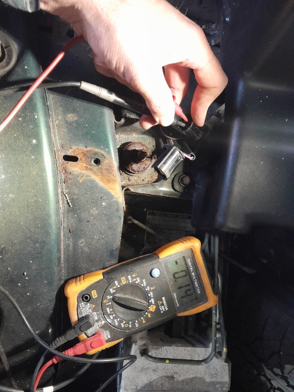

so I'm off work today and thought I'd have a look at the horns not working. Tested both horns direct to the battery, low as heck!!
checked the horn connector and both read 0.16 volts when the ignition is on but nothing changes when i press the steering wheel button.
also check the fuses under the bonnet and all as lovely.
Where should I look next?

A while ago one of our chums had a horn problem (I can hear Cobber sniggering from here), I advised changing the red control box, mounted behind the fuse board under the steering wheel.
When I bought my car I was a member of your very elite no horn club, it turned out to be a relay in the little red box.
I changed it & all had been well; that wasn’t the case with our other friend.
I’m away at the moment & I’m without diagrams, I’ll go no further than that & hope you make progress.
