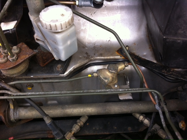

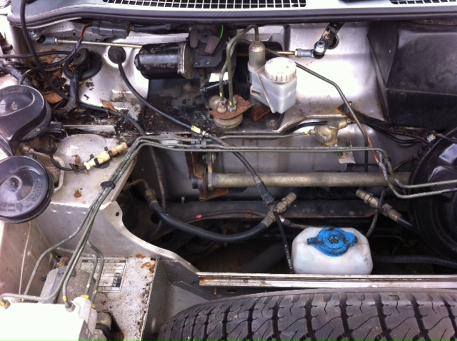

According to RAVE (8th Edition), cars with ABS have a Brake Pressure Proportioning Valve.
My 1998 F has got ABS. I'll have a look in the morning to see if it has the valve fitted. From what I remember, I'm pretty sure it has.

FWIW..my LE500 (with AP brakes) has ABS and no brake proportioning valve...at least not in the front boot...the bracket for one is there but the pipes show no signs of being mucked about so I would guess one was never fitted..

As I thought, my 1998 VVC F has ABS and the bias valve, with the standard size brake discs.

My 1996 MGF with ABS also has that proportioning valve - but of course was also fitted with 240mm brakes all round.
Very interested to see that at some point MG Rover deleted the proportioning valve?

That's a good question! Tipper's TF120, with standard 240mm brakes all round and ABS does not have the proportioning valve.
Therefore I wonder whether, on TFs at least:
ABS = no proportioning valve
No ABS = proportioning valve fitted
Anyone have a TF that does not fit this rule? :)

The TF ABS rule is correct: Nick (Austin garages) posted the answer on the MGFRegister forum: Bosch 5.3 ABS has an electronically controlled "Brake Force Distribution" valve that renders the bias valve superfluous.
I am still interested in your observation David that your car effectively does not need the valve at all with APs fitted at the front. But unfortunately I don't think it is a good idea for those with earlier Bosch 5.0 ABS to simply delete the bias valve.
