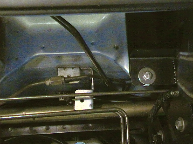

Replied by mgbv8mike on topic AP Brakes balance - how to fit adjustable valve.
Posted 12 years 4 months ago #139547
Am I right in thinking that cars fitted with ABS do not have the restrictor valve ?
My Tf160 has the bracket, but just a plain pipe connector in place of the valve, when you think about it, with ABS the valve becomes redundant surely ?
Posted 12 years 4 months ago #139616
How odd,
I wonder when the decided to scrap the valve on ABS cars, the paint on the bracket appears to be pristine, and the pipe connector original, mines an 03, chassis 608489, by time they got round to my car, the plastic covers in the boot had gone, maybe the valve went at the same time ?;
