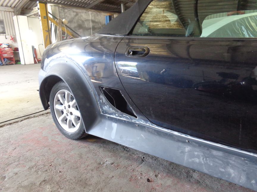

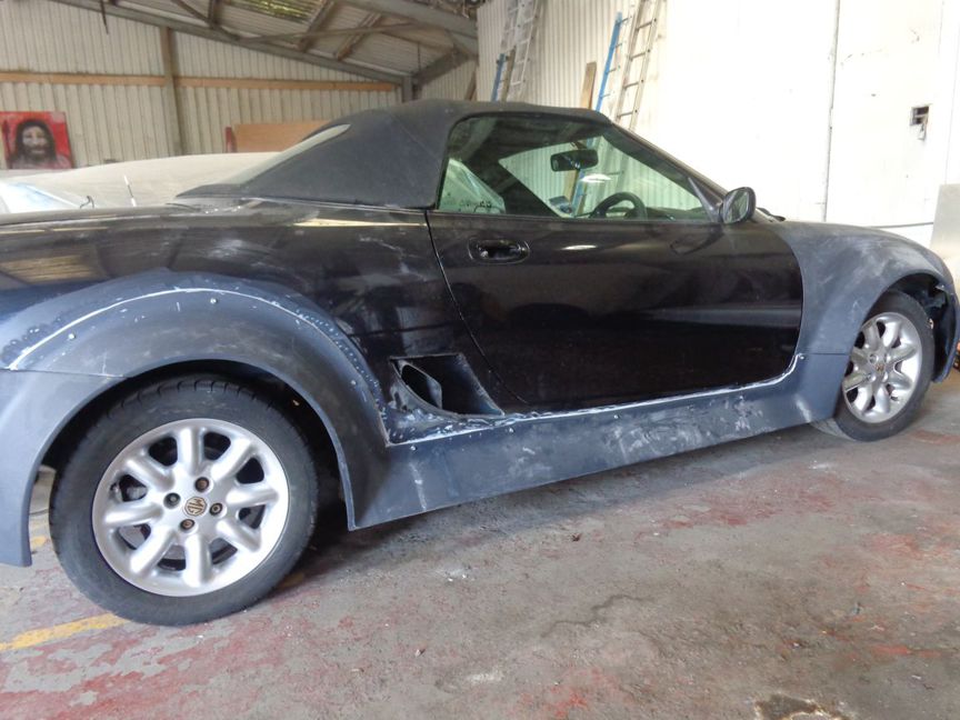

So with the test fitting done it's time to get on with fitting the kit for real. The plan is to chop the font bumper, lower it and to then bond the wings into the front bumper to produce a monocoque, 1 piece front end. Everything is a direct bolt on replacement with the exception of the side skirts. The area where the skirts meets the body was taken back to bare metal:
The side skirts were then trimmed and then bonded to the body of the car. The skirts were also fixed in place with a series of bolts until the bonding agent cures/dries. Once cured/dried The bolts will then be removed and work can begin on blending in the side skirts with the body:

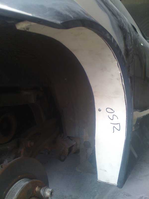

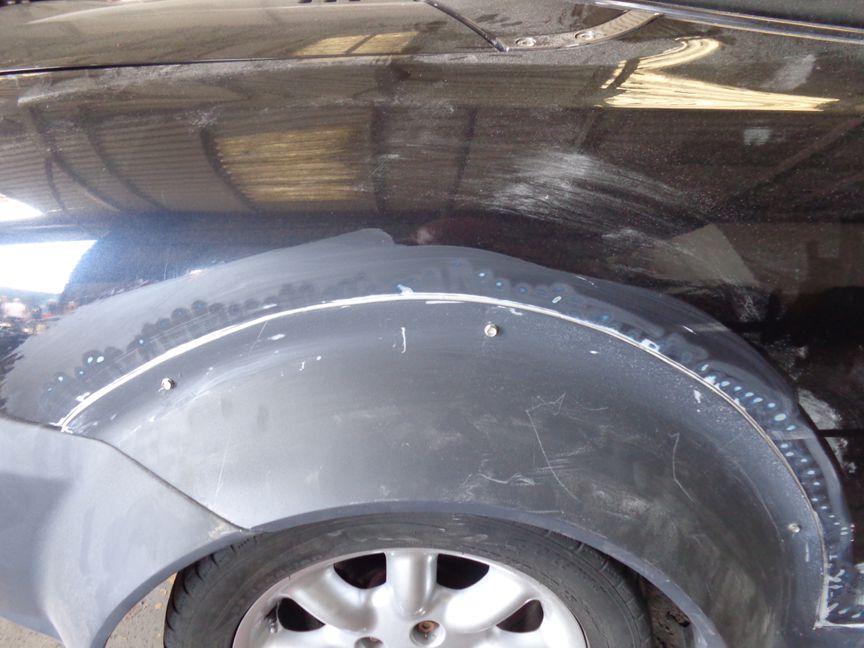

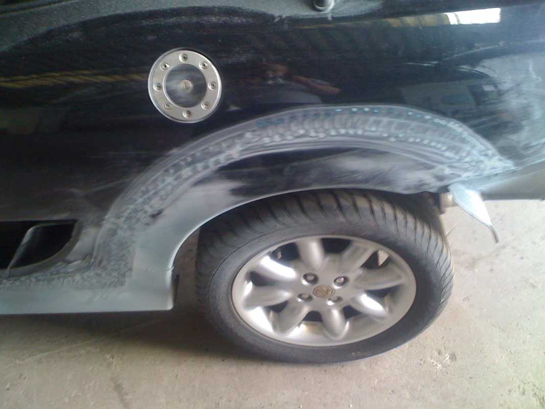

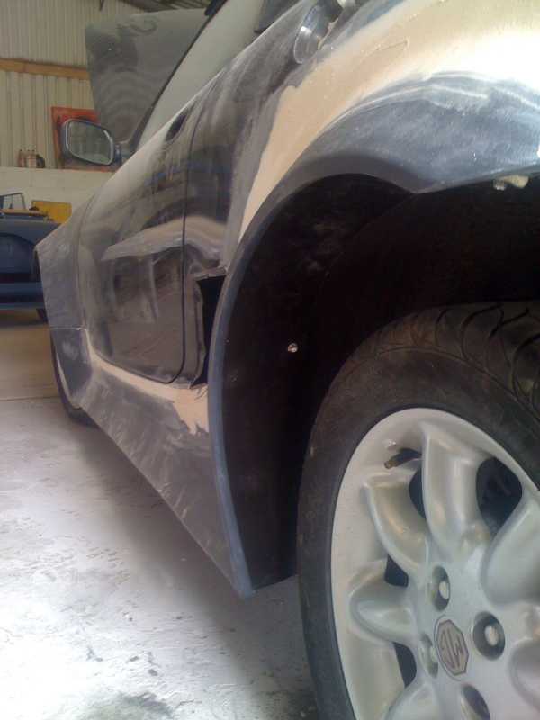

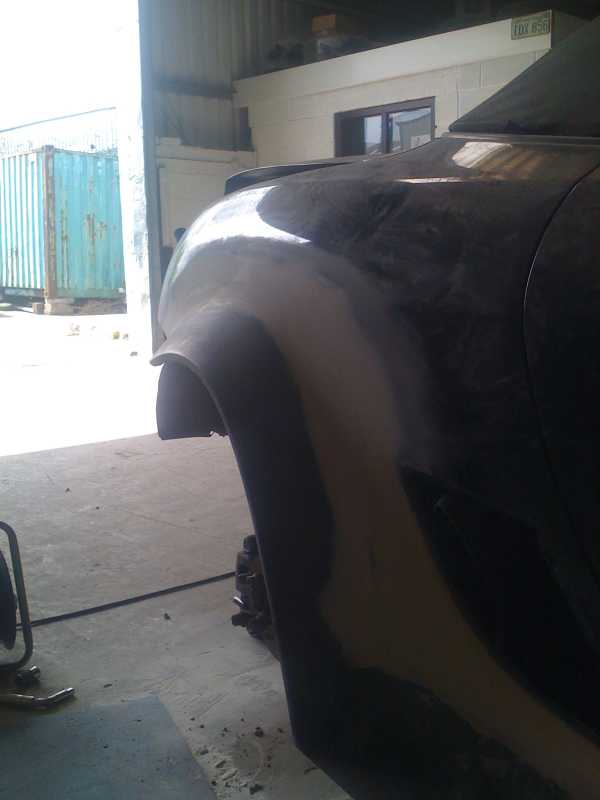

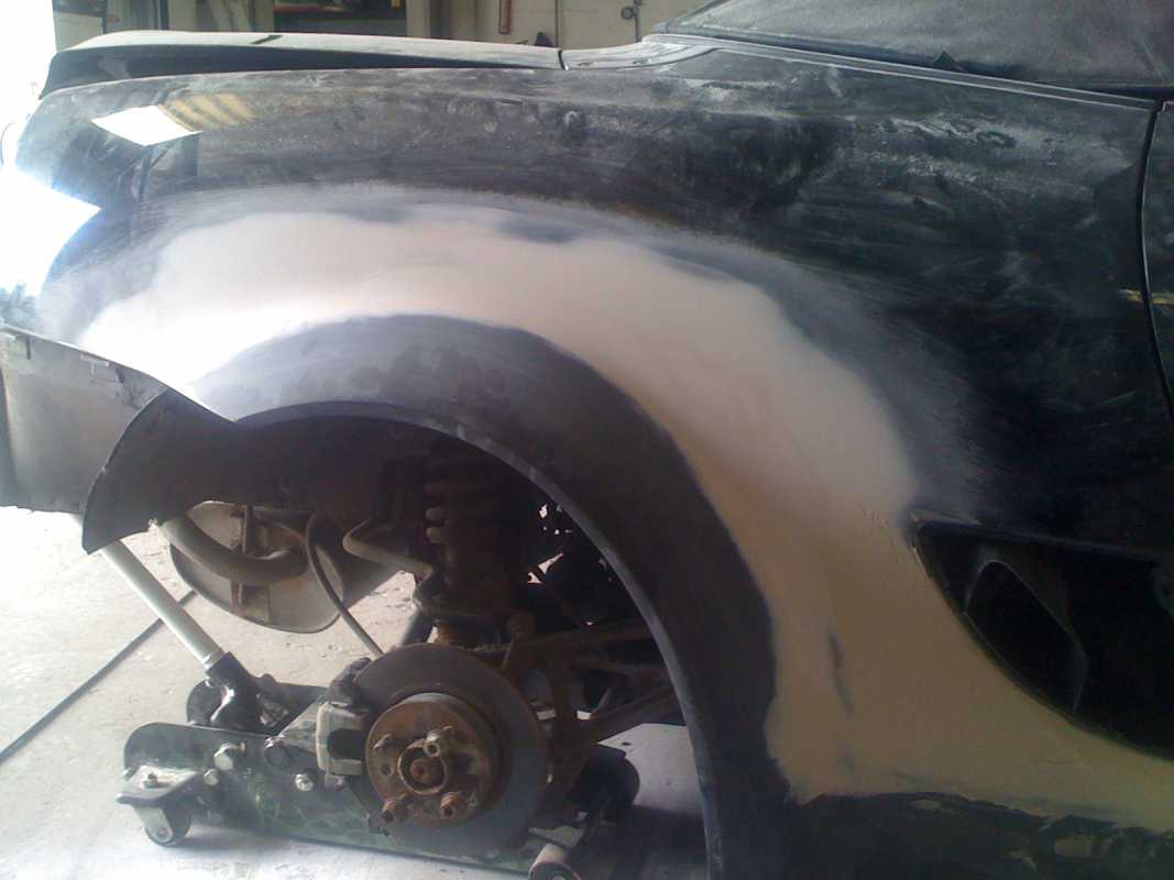

Work continues but at a slow pace owing to my finances. With the side skirts now bonded to the car, the bolts that were used to fix it in place have been removed. The edges of the skirts (where they meet the body) were trimmed down, and work has started with filler to blend them into the body.

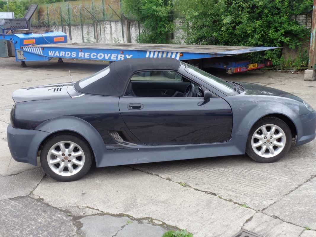

The guys at the bodyshop have also made some custom "spats" to cover the gap/space between the original wheel arches and the new ones.
and painted up
more updates will follow as when things get done
