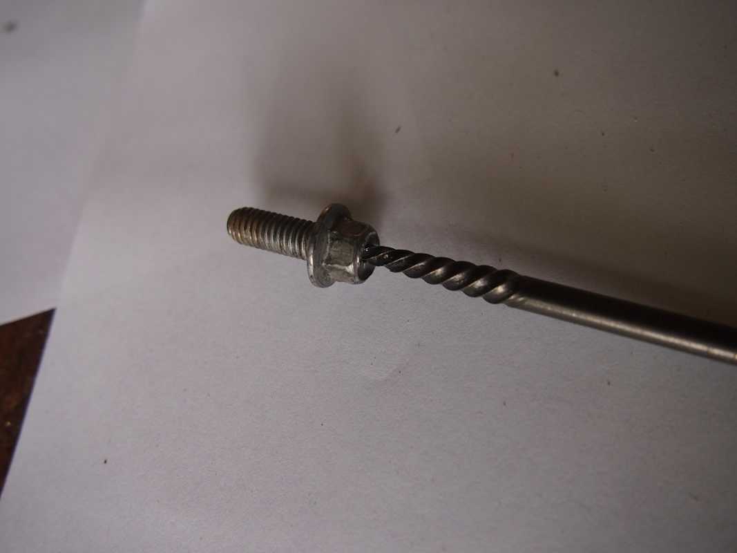

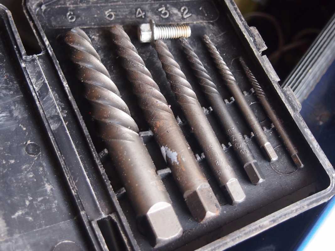

For those who don't know about these they can be really useful sometimes. If a bolt or screw has a busted head or is badly rounded off then a hole is drilled into the bolt. Start with a small drill then use the appropriate sized drill for the extractor being used. The extractor has a very coarse left hand thread and when inserted into the drilled hole and turned anti clockwise it bites in to the drilled hole until it starts to undo it.

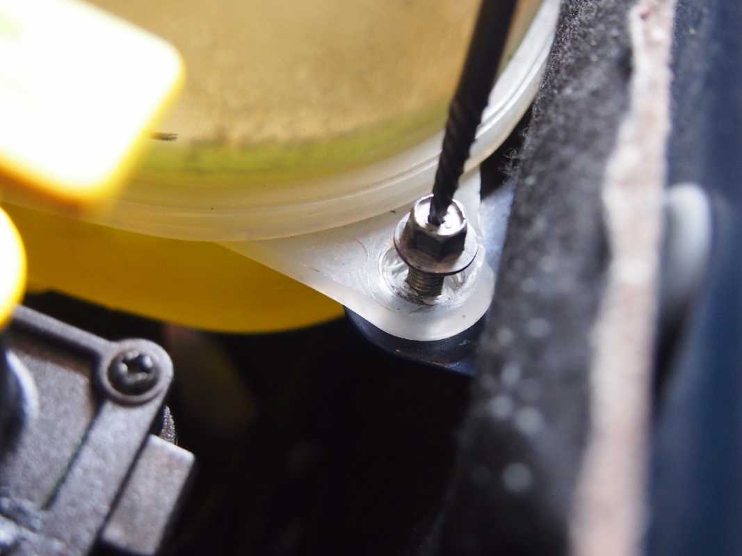

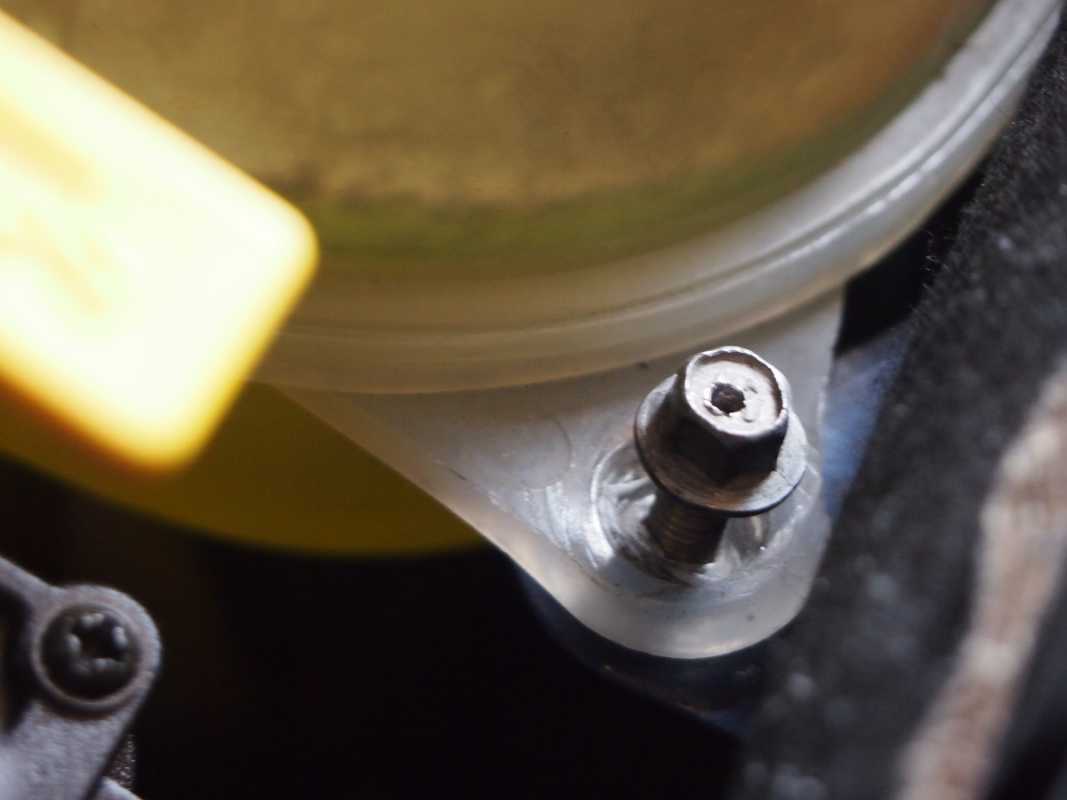

A little example -- The bolts that hold the coolant reservoir had previously been put in with a rattle gun or something. They had melted a hole into the plastic body and were so far in it was impossible to get a spanner or pliers onto the head. I considered breaking the reservoir :bang: but then thought about the extractors. A little hole was drilled and the extractor removed the bolt easily.
