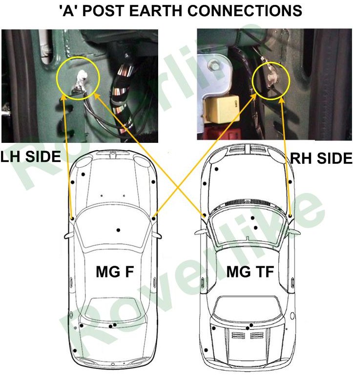

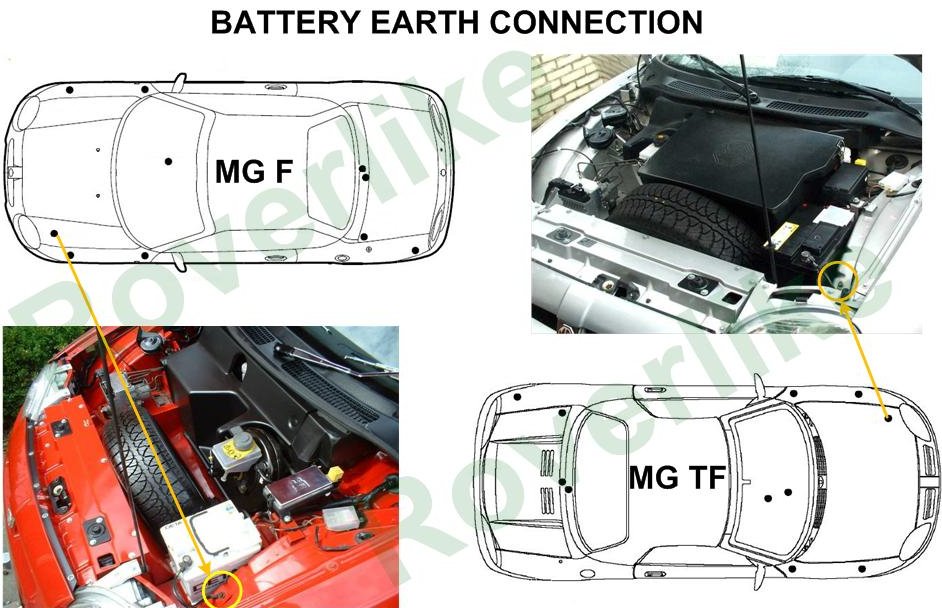

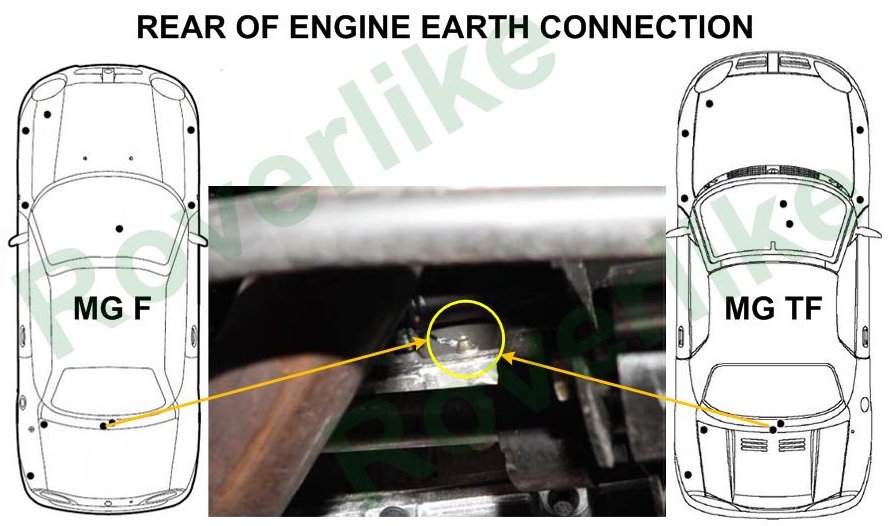

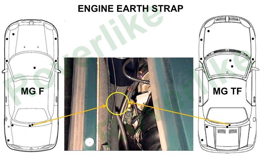

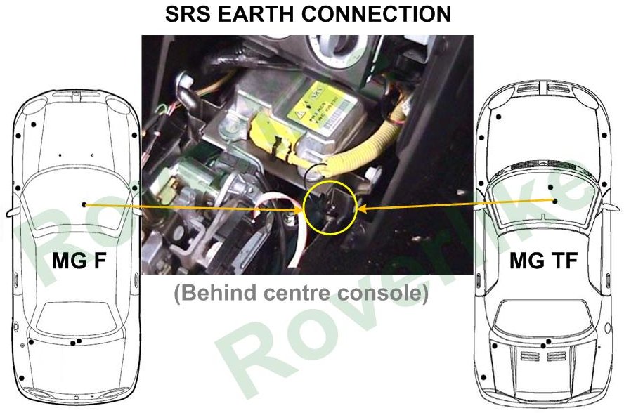

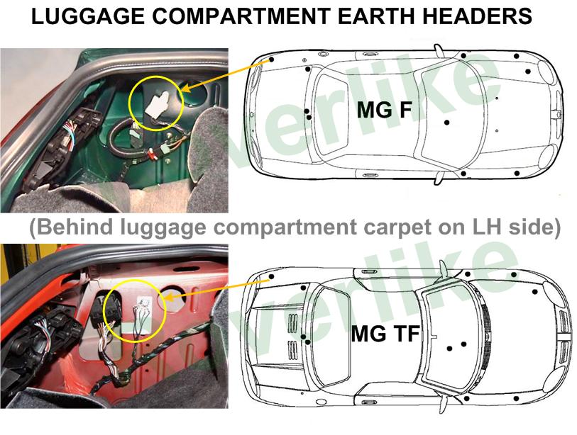

LOCATIONS
  • Battery earth connection is under bonnet LH side
  • Under bonnet, LH side
  • Under bonnet, RH side
  • Behind centre console
  • LH 'A' post
  • RH 'A' post
  • Behind luggage compartment carpet LH side
  • LH side of engine compartment
  • Rear of engine compartment

Replied by Roverlike on topic MG F/TF Earth Points Locations Guide
Posted 4 years 7 months ago #197875
In following post you will find list of electrical circuits connected to particular earth point.
