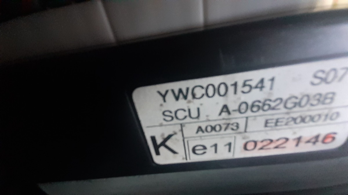

Hi Roverlike, I've managed to take another look to Identify which SCU unit is fitted to my car. It is , indeed , the later one YWC001541 as can be seen in the attached photo. Given I have a VIN number 633647 should I be able to get low coolant alarm ? As said previously I attached an expansion tank to the existing socket that had the necessary internal part , waited more than 35 seconds but not red warning light came on the dashboard.

Your SCU should support low coolant alarm, but your VIN is comming from series of cars which came with wiring but no low coolant alarm sensor. Your car SCU actualy have this low coolant feature disabled because otherwise you would have low coolant light constantly glowing.
You have 2 possibilities:
1. Ask Paul @ https://www.technozen-electronics.co.uk/ if he can enable it for you but you will need to send SCU to him if he can do it.
2. Contact Philip from PScan here on forum by PM as he said he is willing to add this feature in PScan, but I assume you will need to come with car to him.
