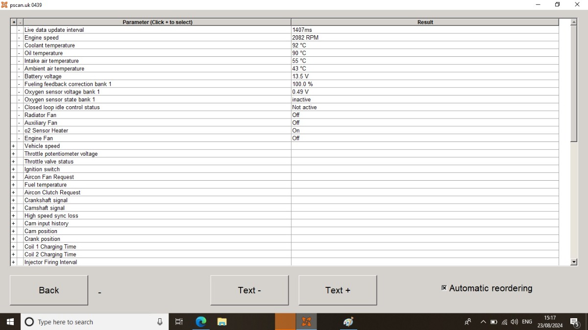

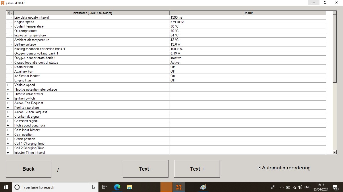

Plugging the PSCAN in I could see that the coolant temperature was being reported but the O2 sensor voltage remains at a constant 0.49v regardless so I went hunting.
I have tested the individual conductors from the O2 sensor back to the ECU (pins 27 & 28 on red connector) and these are good.
I have tested the heating element in the O2 sensor and this looks good using Dieter's pages as a reference.
Placing a multimeter across the O2 sensor I can see the voltage steadily rise as the device warms to peak at 0.9v. From this I consider the sensor to be good?
Engine earthing point has been cleaned to ensure a good contact with ground.
I have attached a couple of images as I'm confused by the behaviour of the ECU. My understanding is that the ECU should operate in open state until the coolant temp reaches 'normal' running temp (approx 90 degrees). However, if I'm interpreting the data correctly, mine appears to operate in closed mode when idling regardless of temperature. When I then pick up the revs the ECU drops to open mode - returning to closed mode when the revs return to normal.
Am I correct in thinking that the O2 value of 0.49v is not necessarily coming from the sensor but is actually a default value from the ECU itself?
My thinking is that the ECU is at fault here as it appears to be ignoring the coolant temperature despite the fact it is reporting what I believe to be true values.

The O2 sensor voltage should fluctuate. If it stays steady in PSCAN, but fluctuates while measuring with a multimeter, I would check the connection wires from the O2 sensor to the ECU connector, perhaps the wire is broken, or too much resistance in the connector. You can also clean the connectors, including the ECU connector, with contact spray.

I suggest that you select only the oxygen sensor voltage so that it updates much faster, which will help you to see if it's fluctuating.
I'm not 100% sure but yes, I think 0.49V might be a default value, so what you get if there is no sensor present.

Have you made any progress with this? One thing to point out: the system should go into closed loop a minute or so after start up, as soon as the 02 sensor has warmed up due to its internal heater and the heat from the exhaust gases. The sooner you pull away, the quicker it heats up. And the ~0.49V is a bias voltage created by the ECU that it uses, when the ignition is turned on, to detect a short to ground in the sensor circuit. That bias voltage doesn’t allow the ECU to detect an open circuit (because, when cold, the 02 sensor appears as an extremely high resistance ie open circuit); however, it does allow you to carefully probe at the 02 connector** with the ignition on, engine off, to see if you detect that voltage - if not, you have an open circuit between the ECU and the connector. It won’t be 0.49V, your digital voltmeter will pull it down, depending on its input impedance (a cheap DVM has been known to pull it a couple of volts lower). That 0.49V bias voltage drops away to zero as soon as the 02 sensor starts to warm up (as its resistance falls from many MegOhms) and begins to switch between ~0.2V and ~0.8V, which it should do around once a second. The ECU should switch from open loop to closed loop as soon as it detects the fall in bias voltage and the beginning of switching ie around ~30 secs to a minute after startup, regardless of engine temperature.
**. The 02 connector disconnected, and very carefully probing the sensor signal and sensor ground contacts, without spreading them, in the connector that leads to the ECU.
