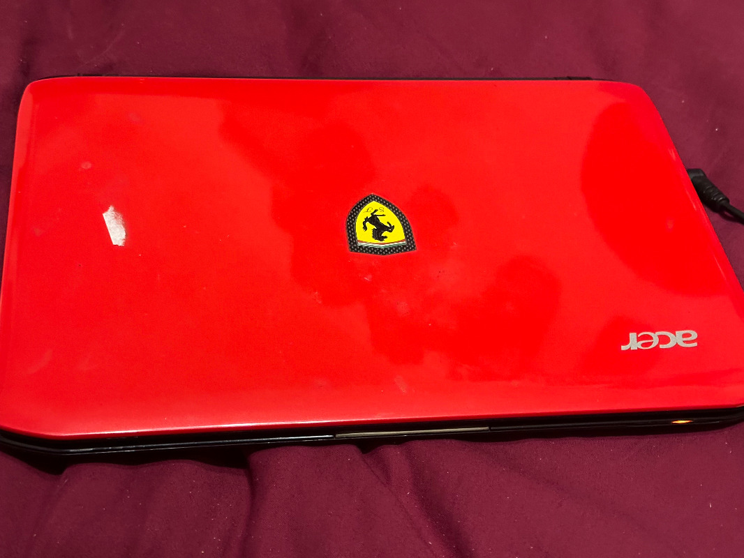

I have a simple solution that is cheap and cheerful......... find yourself an cheap old windows laptop which you dedicate to diagnostic duties,  as a bonus  you wont care if it gets grease and crap all over it and it it wont be the end of the world if you drop it or some other drama befalls it!
This is the one I currently use for all diagnostic apps. it cost me next to nothing as it was given to me with a buggered hard drive, so I threw a new SSD (for reliability and robustness)in it and set it up with Windows 10 (it was originally built running 7) None of my personal data is kept on it, if and when it needs to go online it is protected by Avast (a free antivirus App) not that there is anything on this machine that would be of any interest or use to a malicious actor.
I've been using this for @ 5 or so years, with out any drama. It's small enough to easily use and carry in the car.
It's also amusing to see the look on spectators faces when they see I'm using a "Ferrari" laptop for diagnosing my MG, Ford or whatever.
