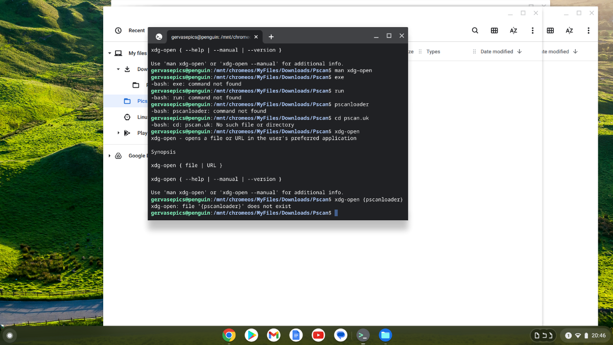

Thanks. The file is downloading, because I can see it saved on the system with a file size. However, I don't know what to type into the terminal to get it to open in Linux. I don't know if it's something I'm doing, or just something so simple that I'm not seeing it.
