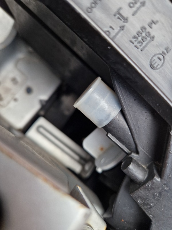

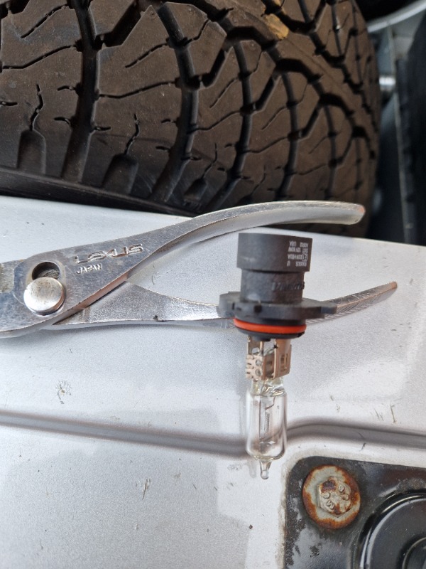

Fitted two H7 Nightbreaker bulbs to dipped beam a few weeks ago. They improved the lights so I bought two more for main beam.
OSF fitted easily and quickly.
NSF had a completely different bulb, plug and holder in the main beam slot. Dipped beam next to it is a std H7.
Do you think someone has replaced the NSF headlamp unit with one from a different model year?
I'm not happy...not happy at all.

I am sorry to ask but are you sure that you changed main beam bulb on your OSF headlamp with H7 and not again dipped beam bulb?
For main beam bulb you should have HB3A bulbs as per picture and for dipped beam bulbs you should have H7 bulbs.

Yes both bulbs on the OSF are H7's  and both clip in with the metal spring retainer as most headlamp units.
Only that bulb in that slot is different.
Thanks for replying.
Edit:  OSF both bulb plugs are the same..the bigger square connectors...there is no plastic base for the HB3 to lock in to..just the spring clip.
It was obviously the OSF bulb I checked to see what type I needed because it was the easiest to access not thinking the other would be different. I must have a replacement OSF headlamp unit at a guess.

Replied by Notanumber on topic 2002 TF 135 headlamp anomoly.
Posted 1 year 6 months ago #210423
It sounds to me that the NS headlamp is standard and unmodified, having its 2 different types of bulbs but that someone has changed your OS to use H7s for both beams, possibly because of a damaged headlamp wiring loom. I'm also wondering whether this might have been standard for the Chinese built cars hence this may just be a later headlamp.

It would appear I have two different headlamp units as has been said by @Notanumber
I have checked the loom at the OSF unit and it is unmolested so I assume the main beam plug comes with the unit and is piggybacked..hence the square plug.

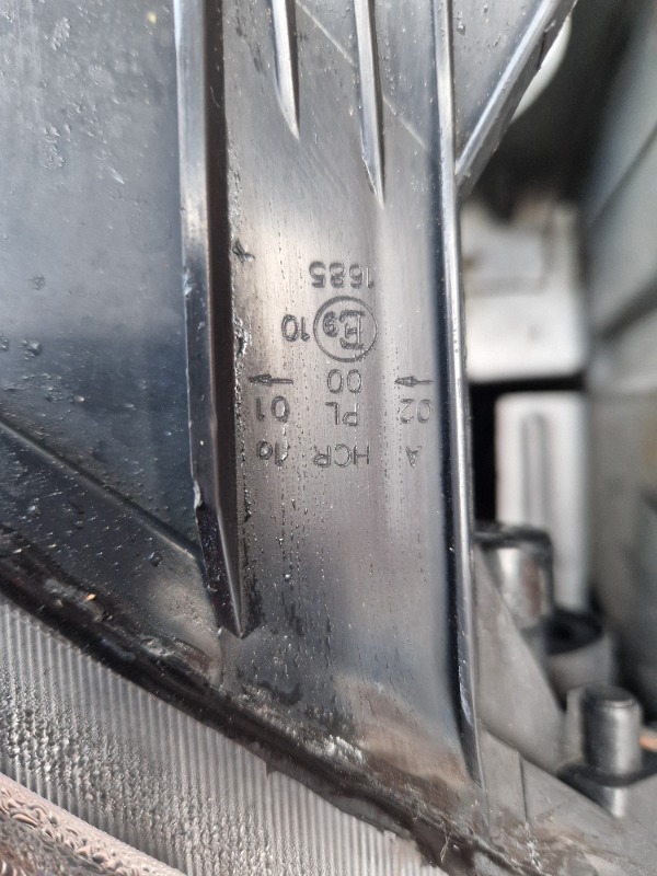

I also assume from the markings that it is a Chinese unit but confirming they have two H7's is proving difficult.

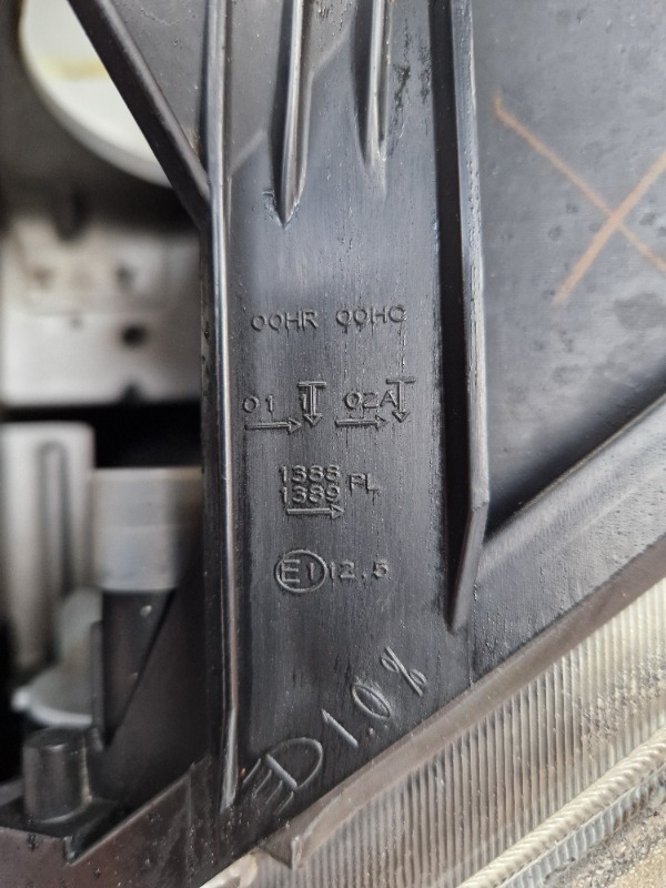

OSF with E marking.
NSF with E markings..

Interestingly your NSF headlamp has E1 type approval (Germany), while your OSF headlamp has E9 type approval (Spain). To me your OSF headlamp more and more looks like pattern replacement headlamp.

Thank you Roverlike...yes it's definitely the OSF that is the odd one..and the HRC mark..republic of China..makes sense that a pattern part would come from there due to MG Motor group.
