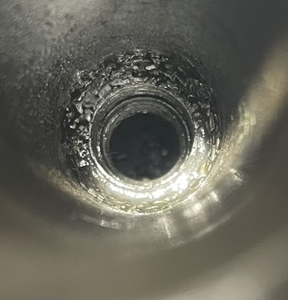

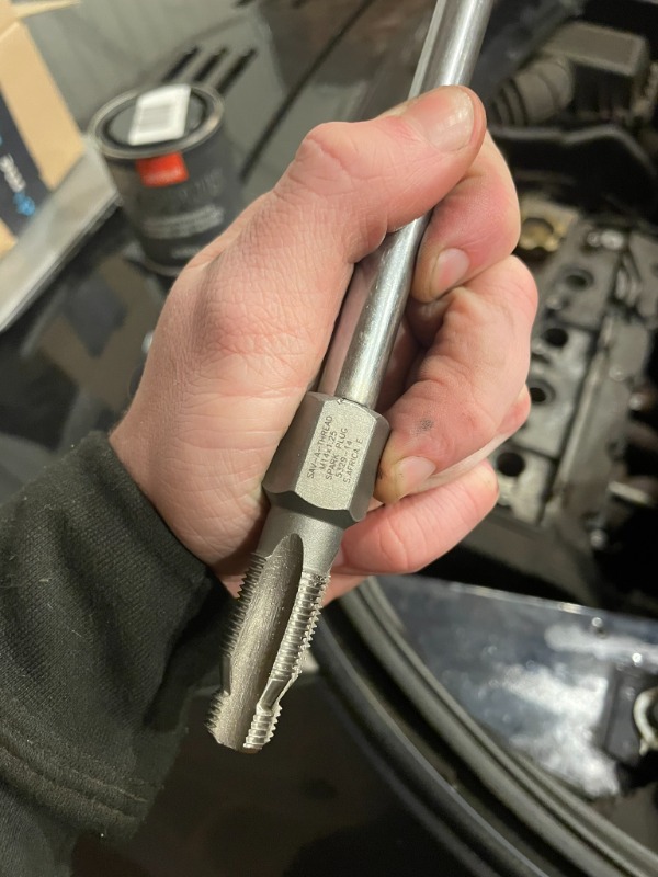

Okay so my helicoil kit came today with tap + inserts.
I first made sure the piston wasn't too high in the cylinder that the tap would hit it. I greased up the tap, clipped it into the long extension, got it into the spark plug thread and screwed the tapered guide in by hand. I then attached a ratchet and as cobbs guide suggests, slowly tapped 3 rotations forward and 2 back which was a success. I then screwed my insert onto the spark plug, screwed in and it the good news is that I have a nice new strong thread to work with.

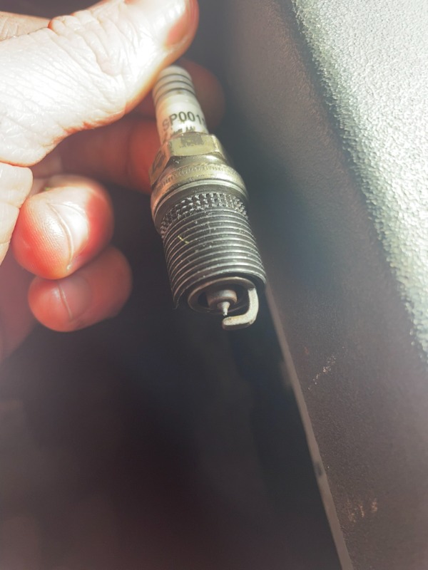

I could have left the spark plug there as it would have been flush but I wanted to get the job done properly. The insert I'm using has outward teeth at the top of the insert, on the outside and above the thread which are designed to be lined up flush and punched with a tool provided with the kit to expand the teeth into the block. Preventing the insert from exiting the thread when you take the spark plugs out in future.
When I first took the spark plug out to inspect, the insert came out with it. So I thought I'd have to screw it in nice and tight for it to stay put. I took the spark plug out again and noticed that the insert was too high and not flush so I put the spark plug back in to screw down again. I've then somehow managed to screw the insert too far down into the thread, so the thread on the spark plug won't catch it.
On the bright side, at least it hasn't fallen into the cylinder because that would be a serious pain. At the moment, I need to figure out how I'm going to grip that insert and raise it up the thread without that happening.
I would like to punch the insert in like it's designed for. But I also can't think for how I'm going to get the insert flush and free in order to do that.
Any suggestions gents ?
Last Edit:1 year 6 months ago by DT1210
Replied by Cobber on topic Time to say goodbye ?
Posted 1 year 6 months ago #210663

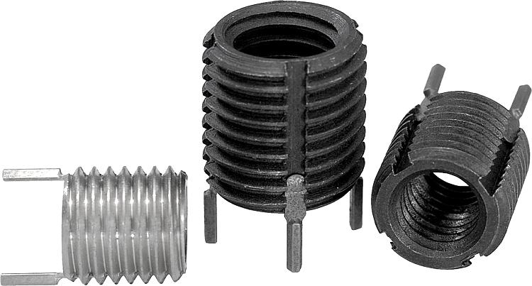

I'm not familiar with that type of insert, the other type I briefly mentioned  have tapered strakes that are used to screw in the insert using a special tool  that once the insert has been screwed in the tool is turned unside down and is stuck by a hammer to drive the strakes in to the hole around the insert to permanently lock the insert in place.
Here are some pictured
I'm not aware of these being available for the repair of spark plug threads, I would imagine the awkward location of many spark plugs would make these type of inserts too difficult to install.

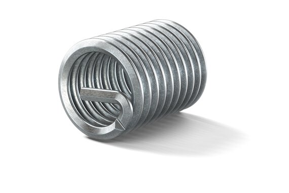

The type of thread insert I was referring to are a helically wound length of wire with a diamond shaped cross section.
From what I gather from what you've written here you should've locked it into place by punching it before you screwed in the plug and moved it!
Looking at the insert  in the pic were it's sitting on the on the plug I can see it is knurled above the thread. I guess that when punched this knurled section is meant to deform to lock the insert in place.
What is the brand of insert?
And how far is it too far screwed in?
I'm sure we can come up with a recovery method. However that particular insert may not be reusable once we get it out, you may have to use a fresh one, it all depends on how hard it is to recover.
