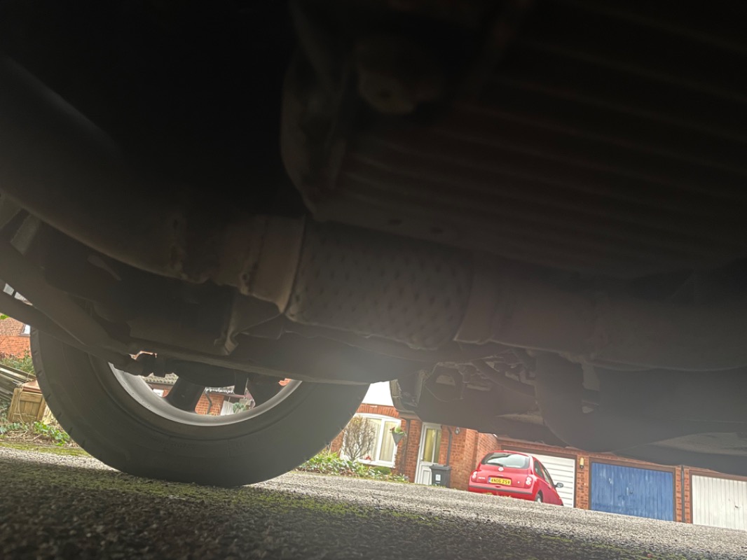

On start I couldn't seem to see or feel any exhaust coming from the manifold. I had a look under the car and the flexi didn't appear damaged or freyed (photo also attached). But the loud chicking/chuffing sound seemed to be located within the engie rather than coming from any of the exhaust components. There was also oil all over the engine on both sides.

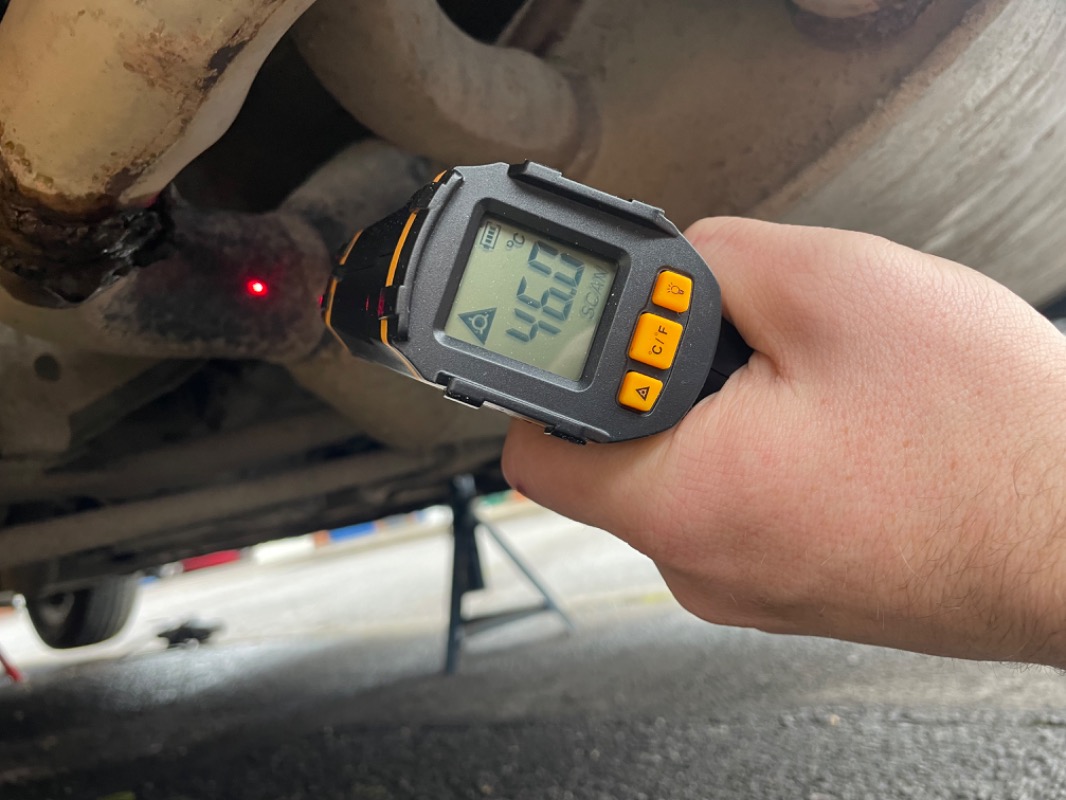

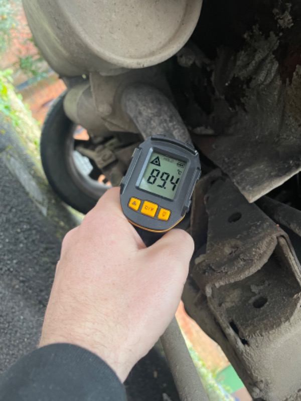

It is possible to diagnose a blocked cat by temperature. Something like one of these is invaluable.(£12 on amazon)
The cat inlet temp will be significantly greater than the outlet...

Okay gents so finally got out and under the car. This is as far as my diagnostics went today.
Checked the oil filler cap. Was clean as a whistle and wasn’t puffing with engine on. There was some exhaust coming from the tail pipe. Seemed normal.
I bought the digital thermometer gun and measured the cat with it as David suggested. Low and behold the inlet side temp was nearly double than that of the outlet side.
So a new cat and camshaft cover gasket and hopefully all should be well fingers crossed.
