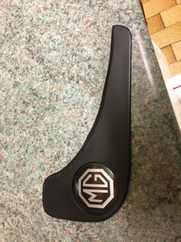

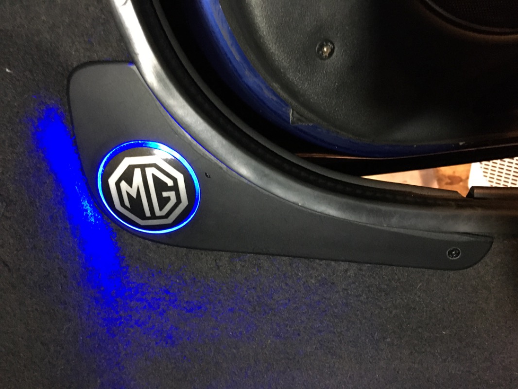

I made a couple of retainers which screw into the inner sill; when tucked under the door rubber they retain the carpet snugly.
These are Perspex & the MG badge is off the MGB Rostyle wheel centre cap, I stood the badge off the plate & made a ring of blue LEDs which illuminate in sympathy with the footwell lights.
These come under the heading of five minute fixes, from inception to final item took about a month.

I’ll include another picture, although the effect is Ok the outline of the Perspex could be improved.

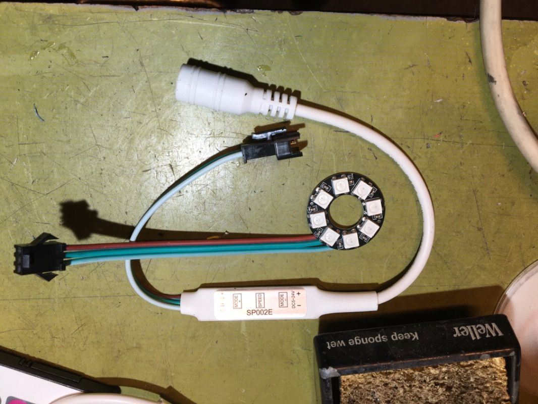

I had a retrospective through my Perspex purchases & found reference to the bits I bought for the carpet plates. The supplier was Trent Plastics & as with all these bits, you will find them on eBay. It was an A5 piece & out of which I cut two, you can buy it in 55 colour combinations & that piece was £3.50. The MG badges were £4.99, I think it was five in a pack from padmg they are for MGB Rostyle wheels. If you want to put a bit of light behind them, you can buy an 8 LED ring these are a couple of quid but you need a controller, which are not much more (see picture). The unit is RGB & by fiddling with the settings you can derive a colour to match your mood. I haven’t used this, I made a circuit board & populated it with SMD LEDs, this wasn’t a success. LEDs too small, hands too big. I substituted those for 3mm devices.

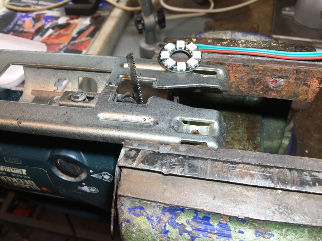

I’ll add a picture of a method I used for sheet work before tooling up properly.
