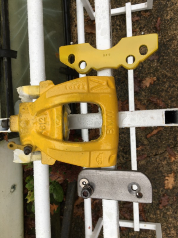

Replied by Airportable on topic Front Wheel Bearing Replacement MGTF
Posted 1 year 7 months ago #209706
 Not all bolt on goodies are equal. I have seen some examples which look like they have been designed & made by someone who has recently graduated from Airfix to Scalextric.
Conversely there are chaps like MGB281 who have produced systems which could easily be mistaken for a product from a competition specialist.
I can’t comment on soooper dooooper brake pads as I’ve never experienced the change from a respectable manufacturer, like Ferodo to some exotica.
A friend paid a fortune for some product made from materials from a distant galaxy & ran into a bus. Had he had bogo pads he would now have more hair & probably not the grey it is now.
I include a picture of my adapter plates; the unpainted one is for the rear callipers & still requires finessing, which in my workshop speak means another going over with a flat bastard file.
Last Edit:1 year 7 months ago by Airportable
Last edit: 1 year 7 months ago by David Aiketgate. Reason: Repositioned photo
Replied by TA22GT on topic Front Wheel Bearing Replacement MGTF
Posted 1 year 7 months ago #209707
That's why I said"tried and tested" ..as recommended by this forum...ie. Mike Satur.
Those yellow callipers are quite fetching. You do good work even with a bastard file!
