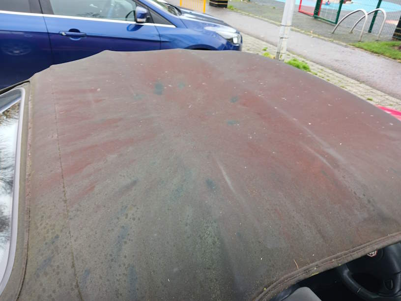

Over the last couple of years, my roof has been changing colour - looks almost as if somebody has hit it with one of those bombs made of dyed flour
When I first had the car, I tried to keep it sweet with one of those "restore and protect" kits - Autoglym maybe? Didn't make a lot of difference that I could see...
Anybody got any tips for restoration/upkeep?

I wonder if it was a different colour previously?
There are soft top roof dyes available, some also recommend using their pre-dye solution to help it "take". I've used one of the dyes on mine, and it has made an appreciable difference.

What colour was it? going by the pic it's a bit hard to tell

I have found that a wet vacuum cleaner and standard carpet-cleaning products work well for initially cleaning dirty hoods. I bought a dirty, secondhand hood and frame, (with a glass screen) to replace my generally better hood which had a cracked plastic screen). Perhaps needless to say, after a heavy dose of carpet-cleaning products, thorough rinsing with clean water in the wet vac, followed by a few days drying then fresh waterproof and dye will be essential.

Looking at it again, it might’ve been red, if so that will be the hardest colour to get right, most red pigments are prone to fading and also the most expensive.
it’s quite possible that attempts to restore it to the original deep red will only end up a brownish red….or worse a reddish brown!
If it is meant to be black then it might’ve  Suffered from chemical attack flue to fallout from being parked near some industrial plant.

Once you have cleaned and sorted it, I use one of these,
https://www.mgocspares.co.uk/product/t610/waterproof-half-cover-universal?nodePath=1/3/977/1161/1162/2931
my car sits outside as an older more vulnerable model has the only garage in my possession
It works well, is easy to take on and off and folds into a small square zip up case it comes with.
On very wet days moisture will be captured on the inside of the rear screen, but my TF is my daily driver, so a quick wipe usually sorts it.
Most importantly, the wind has not yet blown it off, the elasticated straps are very good.
Sorry, for some reason the forum doesn't alert me any more when I get a reply! Also when I quote somebody now, I have to reply in the "quote" box - don't know what's going on.
It was a black top!

So it might have been red at some stage in its life! Oh well. Head gasket went yesterday, so the roof has slipped down the priority list a bit for now

That roof looks like it needs a deep clean, if it was mine I would start with my jet wash to give it a deep clean blast..
OK will try that! I think I need something to "re-black" it afterwards though, if anybody has any ideas...
