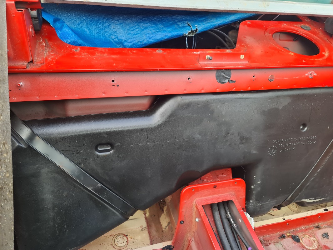

I had a go at this today and took a couple of photos.
Replied by R40MGF on topic Fuel tank removal
Posted 1 year 8 months ago #209280
I had already removed the pump and drained the tank previously so that made it much easier for me.

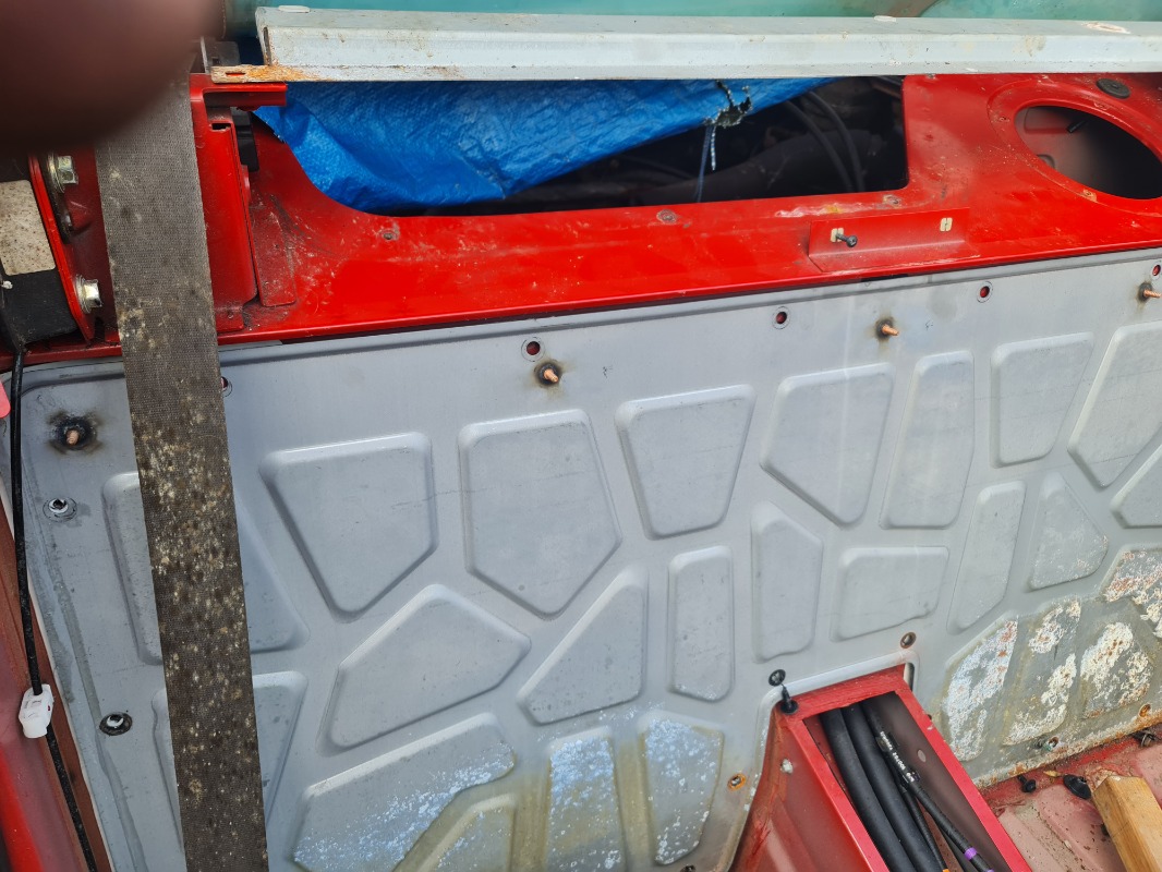

Undo the 10mm bolts and remove this panel.

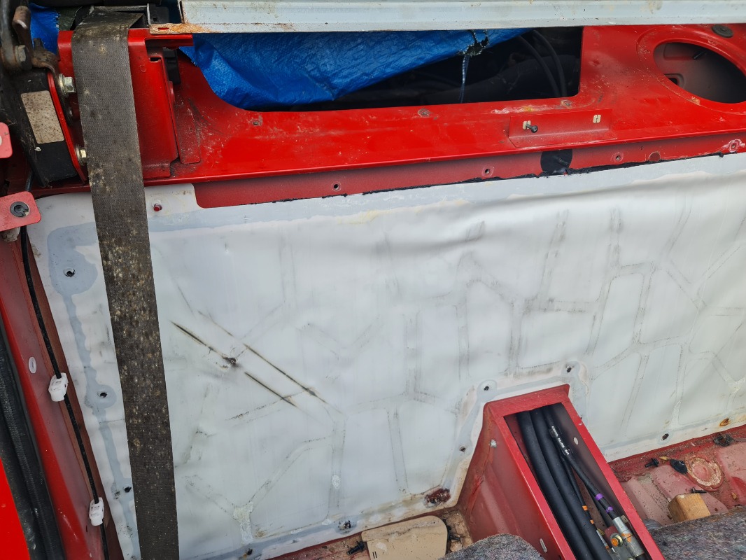

Peel off the plastic sheet.

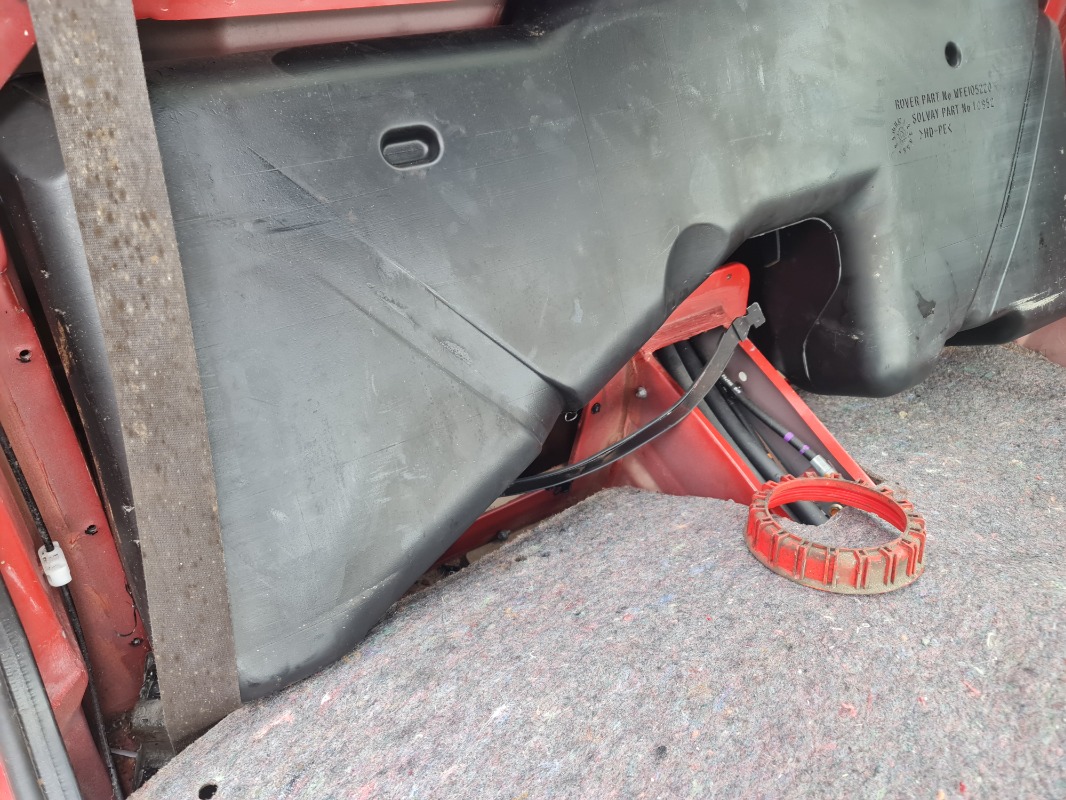

Undo the 2 13mm nuts that secure the tank straps.

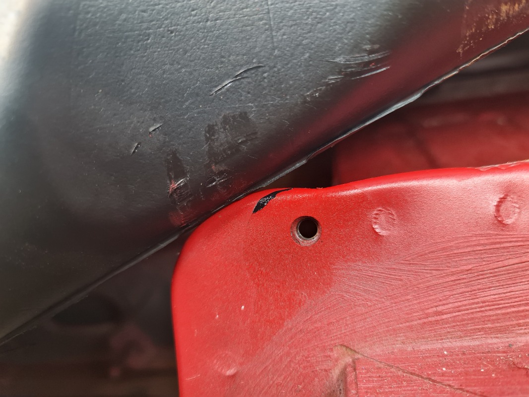

After looking at the shape of the tank I thought that it would be easier to start by working it out from the bottom, it was a bit tight here.
Once I had it to this point it came out without further problems.
It was a way easier for me because the tank had already been drained and open for a while so I think that it had shrunk back a lot.

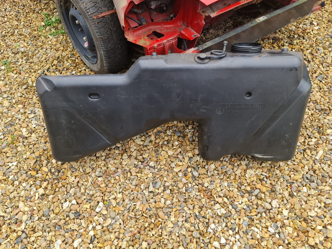

What the hell is that?
is the tank really holding a bit of fuel in it that will never get out unless you drive it on the wall of death?
I for the life of me can't imagine why anyone would design it like that, the only reason I could guess what happened was at a planning meeting by a bunch of suits who wouldn't have a clue, came up with the desired specifications, one of which was fuel capacity, the engineers could give them the capacity, they wanted but couldn't find away to make it all usable capacity, in the confines of the av available space so didn't bother....it had the desired capacity, but just not all of it was useable!
