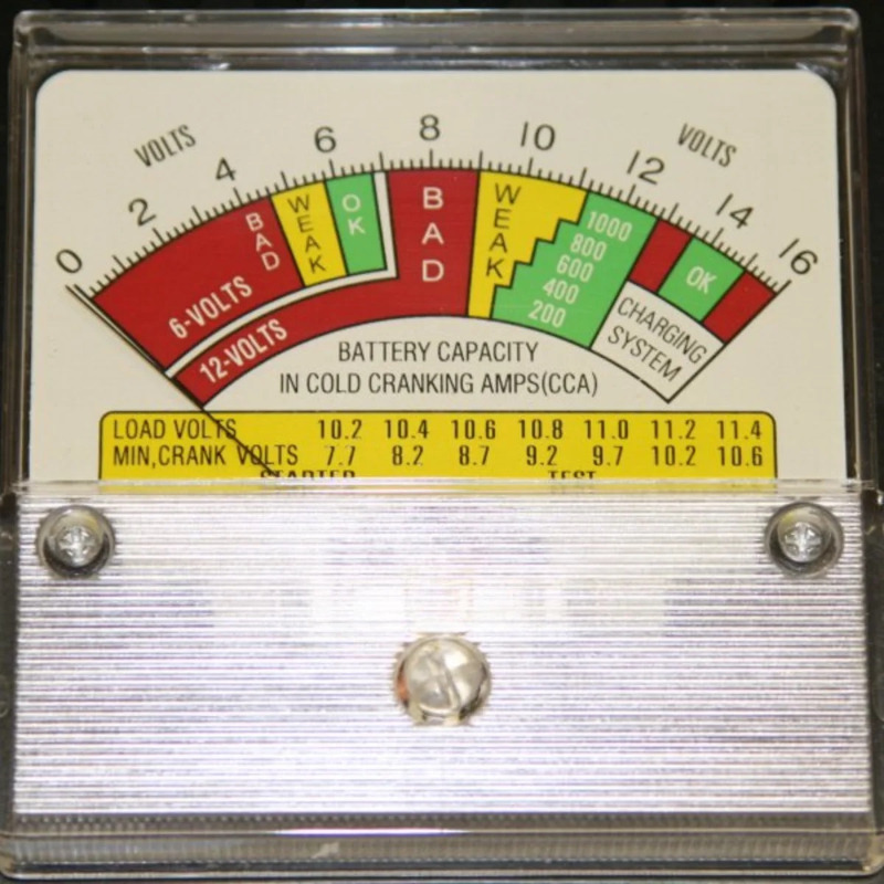

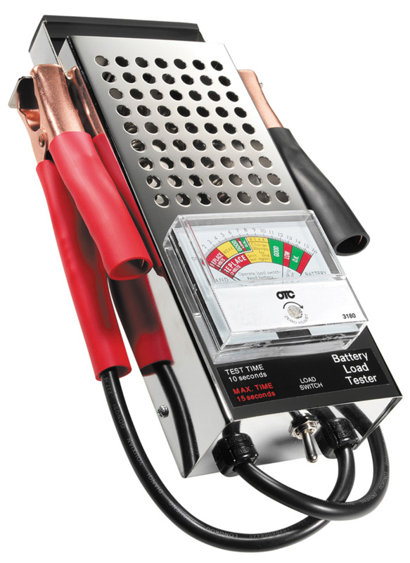

Your battery my indicate that it's fully charged but  it may no longer be able to supply current at the rate required. A load test is required this requires at test unit that measures the voltage while simultaneously putting a high current draw load on the battery, the indicated voltage under load should be at least @ 9 volts or so at a minimum, but you may find that you're only getting @1 to 2 volts under load or even less this means the battery is buggered! battery load testers  are cheap these days and  can also be used to test alternators you can get fancy electronic ones or old fashioned analog types, I have both and prefer to use no nonsense analog unit.
A simple analog type
One of these will quickly pay for itself in the time saved buggerising about. Once you have one you'll wonder how you ever did without one!
You can always drag your battery around to a retail outlet and get them to do a load test for you.

I’m with Cobber all the way, only I prefer the electronic tester. You can program your battery’s optimum perimeters into it & it tests around those.
Like Cobb’s I wouldn’t be without it & again it saved me it’s cost with the first series of tests on some very special batteries.

I won't single out any messages to thank, but I really appreciate all of your advice and guidance. I've got a battery load tester coming tomorrow (today now I guess) as I didn't already have one, and a new multi-meter as I've misplaced that as well 🙄

Good call on getting the load tester, should help narrow things down.
