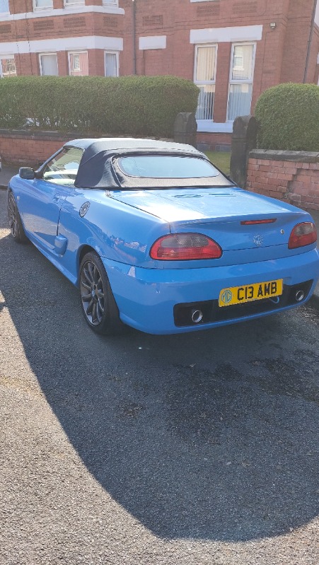

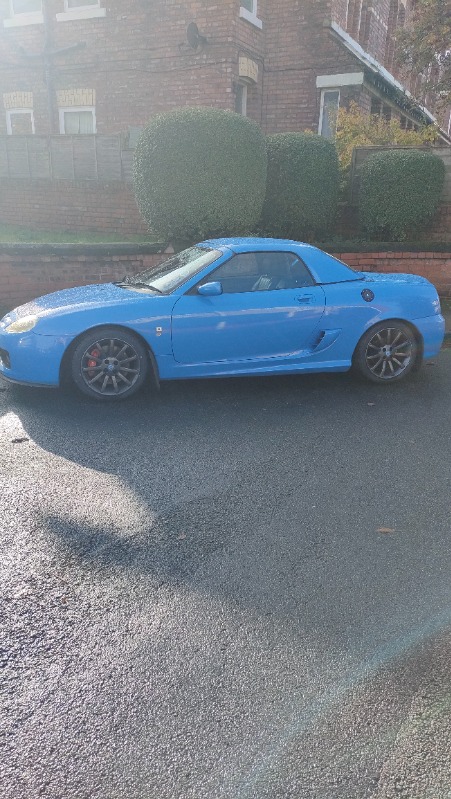

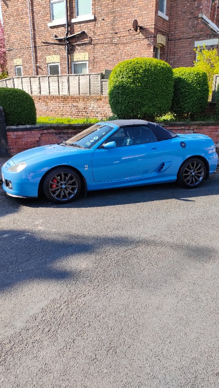

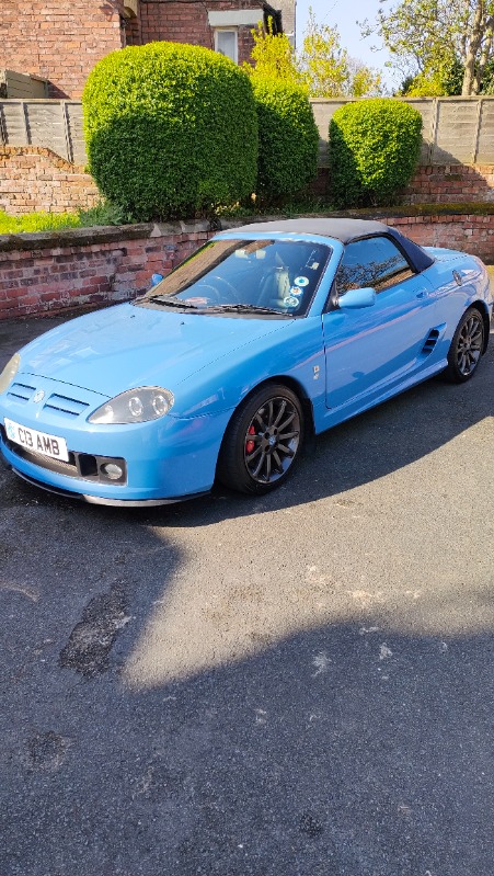

After a consultation with the garage I asked would the car be worth the investment of engine work...his response that is honest is due to the unknowns when entering the dissasembley , will it all come apart easily enough for starters due to possible broken or seized parts , and the second lot of welding that he has just completed he recommends I put my money in to another one.
Therefore I will be trying to sell it as is or break it up as it has many good parts on it that I will mention eventually when I get sorted. Disappointing as it is he reckons that the rot underneath may make the engine investment not worth while in 12-18 months.
Some attached pics of her🙁
