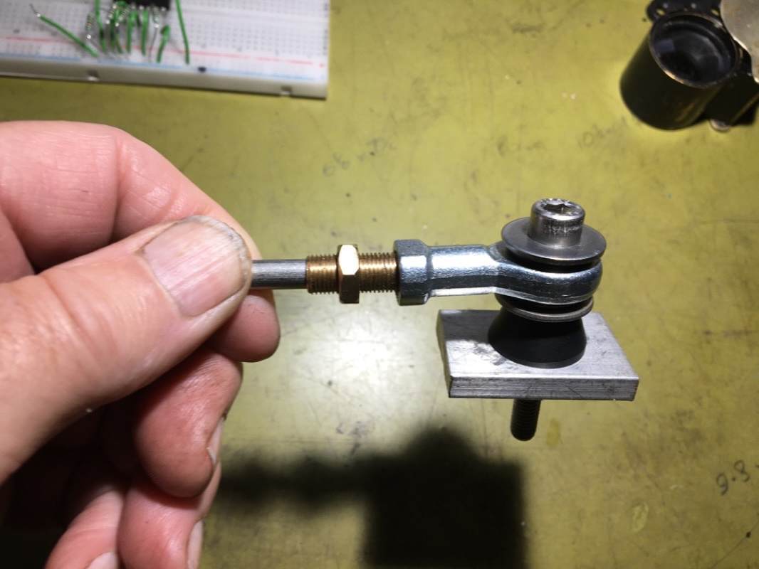

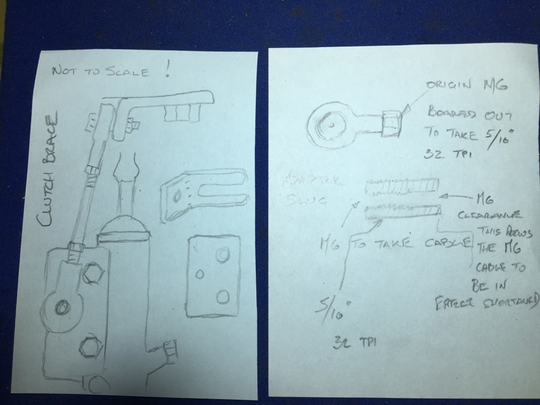

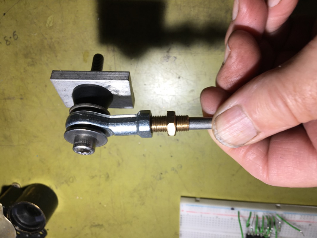

Right, if I do the right thing you should see pictures; the first (hopefully) shows the general arrangement of the brace. I slotted the angle bracket to give me a range of positions, also that 17mm bolt is a right bugger to get lose & to back it off rather than remove it altogether.
One thing I omitted from the thumbnail, the angled end has had material removed to accommodate some pipe work.
Ideally the rod ends should be a left hand & right hand pair & a matching threaded rod, but because I needed standard right hand for the prime job, that’s what was used here.
The cylinder anchor point was an off cut of duralumin thick enough to withstand any strain placed upon it. Obviously the two main mounts were clearance the anchor point is tapped.
the second drawing is a general sketch of the gear change rod end modifications & finally the assembly as it would be seen assembled on the bell crank. Water & grit are excluded by using “O”     rings retained under the outer 20mm washers, the turret is in to lift the rod end up to the appropriate hight, which is governed by the original design.
let’s hope my skills with pictures is as slick as usual.
m

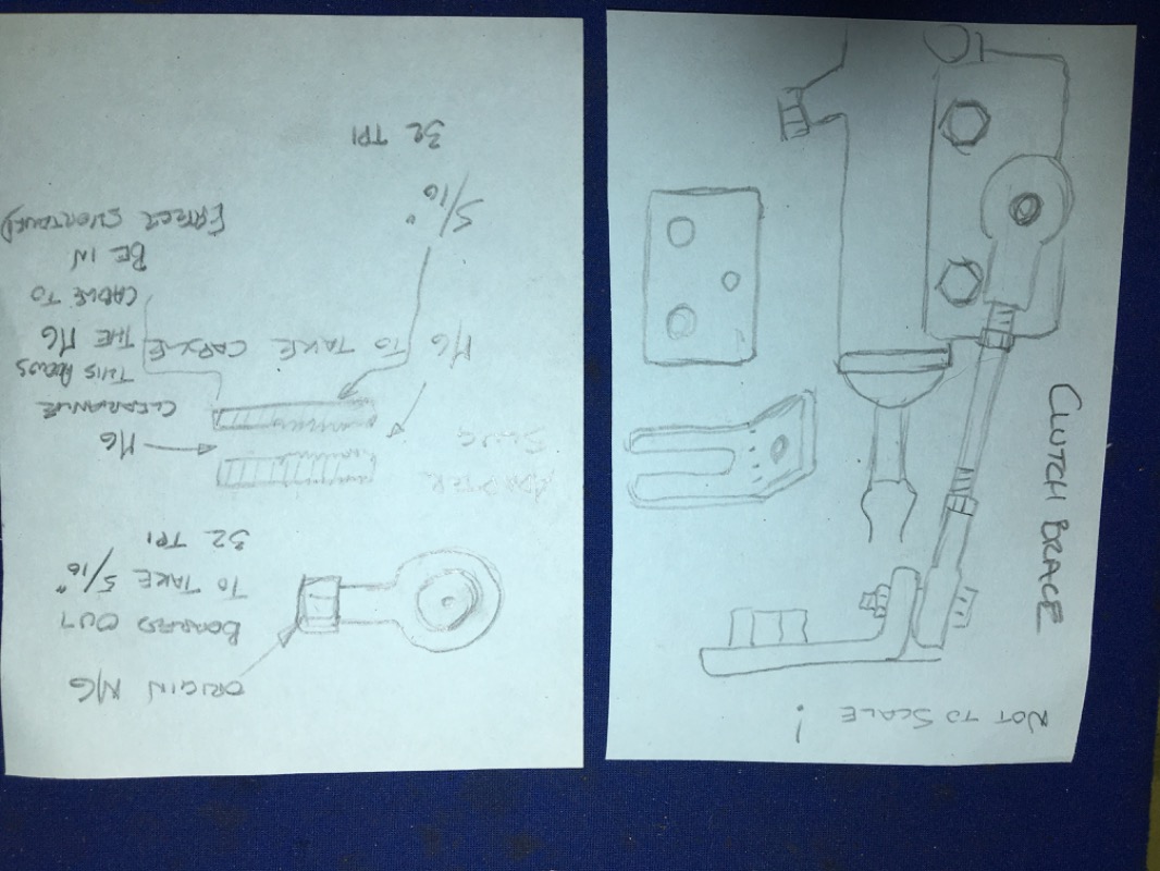

Replied by Airportable on topic Gear change changes.
Posted 1 year 11 months ago #207897
A moderate success, it being up side down will help Cobber, we have to accommodate all members equally!
Replied by Cobber on topic Gear change changes.
Posted 1 year 11 months ago #207898
I didn't notice that the pix were upside down......I was probably too shocked that you'd managed to get the pix to display within the post without  the assistance of a moderator to notice the orientation of the pix........well done that man!
Here they are in the correct orientation:

Thanks all for the detail relating to the clutch slave brace, very interesting it does open up possible opportunities. Not sure why you felt it was necessary to use fine threads unless you felt it was unpredictable to lock the arrangement without it slipping.
Back to the theory though..
As OEM the line of force will be following the slave rod. Without watching it deflect I can’t see what bends and how. But with the device fitted  as shown in the drawings the resisting force is not in line with the axis of the slave push rod.. Any resisting force might tend to bend the slave rod I would have thought.

Posted 1 year 11 months ago #207916
The drawing with the amended thread in the joint pertains to the gear change, the brace has the standard M6 thread.
In an earlier post I referenced  Mk1 & a Mk3, the Mk2 had a better alignment but presented a real problem when assembling in the car.
The thoughts of working through vector diagrams to assess excess stress didn’t occur until you mentioned off axis forces, however with my wife pumping the clutch there was no discernible deflection.
The bracket, as originally designed was a bit of a “can do” item, mounting the engine to the subframe & dangling on a flimsy excrescence is the clutch slave cylinder & so hardly surprising it wasn’t resilient.
The drawing is a general arrangement & as it says “not to scale”.
We’re of out in the car this morning & the entire system feel tight & positive; it hasn’t taken long to become accustomed to the new feel, which is probably not surprising as it is similar to my Mazda & that’s not heard very often.
The project was an interesting way to use up a couple of spare rose joints, whilst the engine cover was off. It might inspire others to have a look.
There’s a leitmotif to all my posts & that is one of experimentation; as years advance I prefer to use my accrued skills, to keep the neurones clattering around & thus I take it out on the car.
