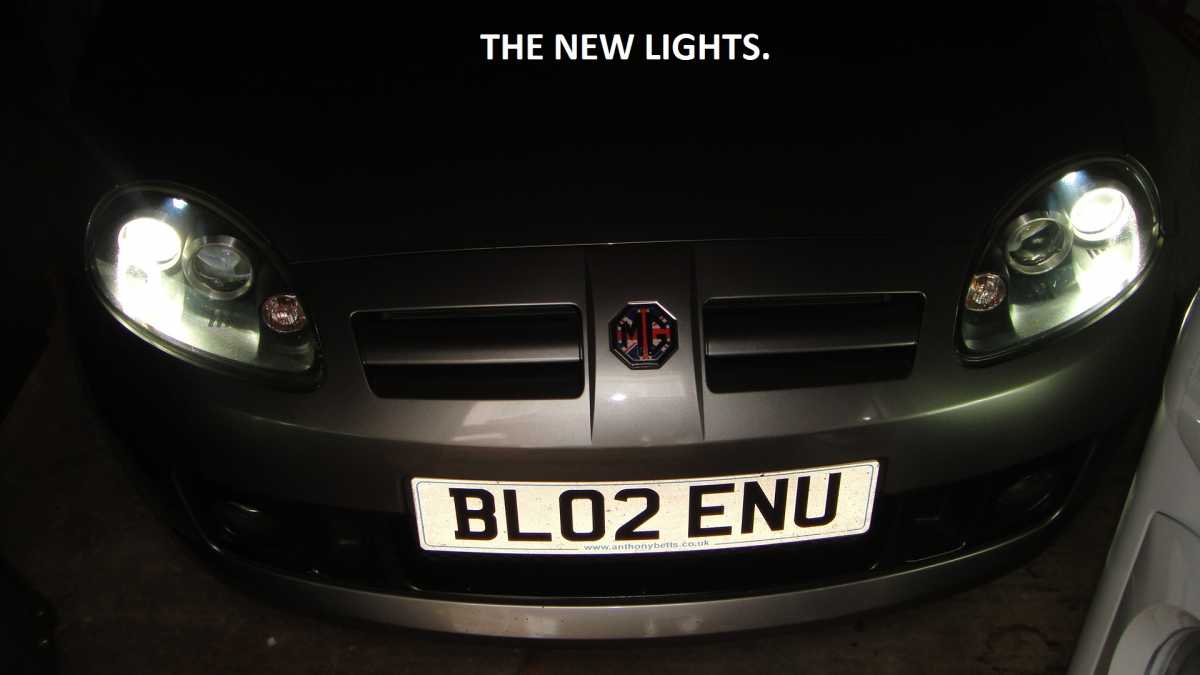

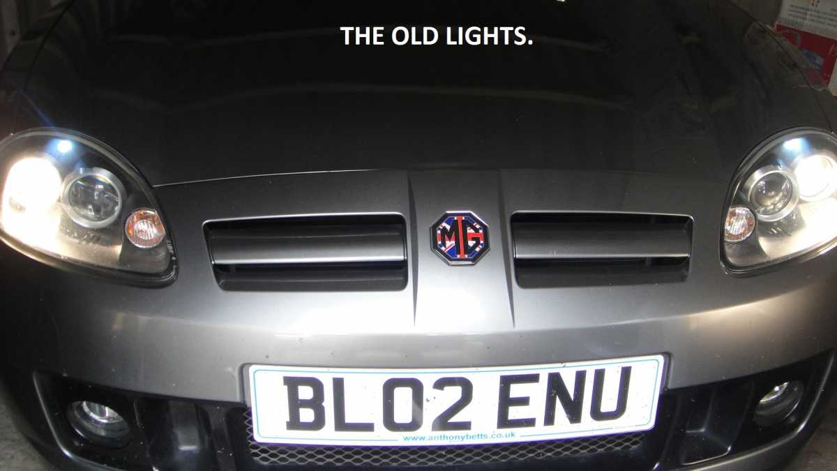

As for the proposed new lights.. well you can see from the pic below that the 4300k bulbs (use your imagination) shouldn't dazzle too much comparatively.
Anyway, not wishing to cause any hassle, I have decided not to fit this mod to my car after all. But, seeing as I have it coming, I will show how to put it on prior to immediately removing it forever and ever. Amen. ;)

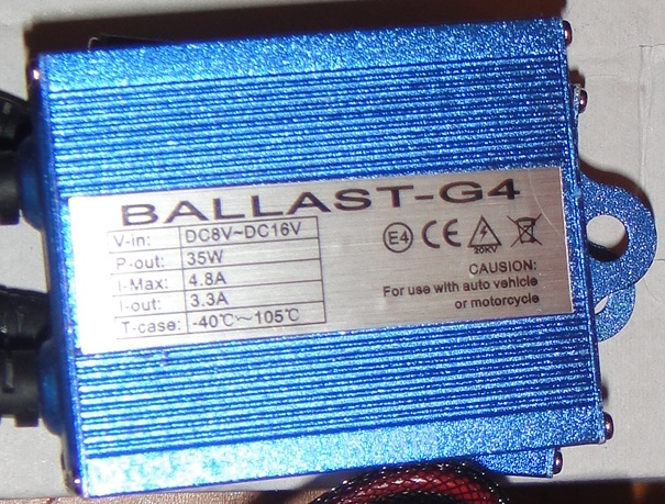

HIDs produce many thousands of volts to strike the lamps. Badly made units can interfere with other systems (noise/crosstalk), be lethal, or melt surrounding plastics and cables leading to a fire.
Many people don't realise the engineering and technology that go into the ballasts on these units and £30 smacks of 6 year old Chinese workers. Please be careful.

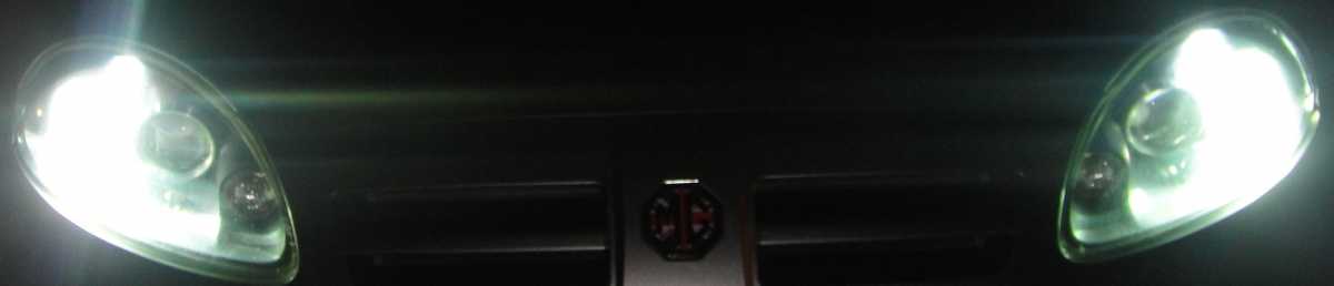

Make sure the brown return wire goes towards the bottom when you fit it.
I'll take more pics when darkness falls. However, I let the car run for over an hour and nothing was more than luke warm to the touch. The old halogen bulbs that I replaced were very hot though and they had only been on for a minute or so.
