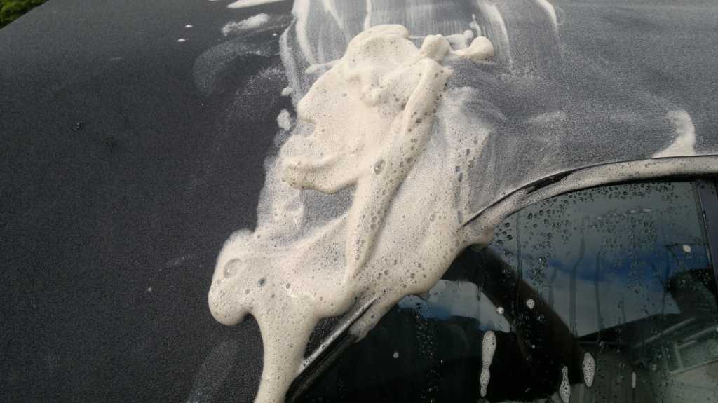

Tourbillon graciously sent me some Turtle wax roof cleaner. What a great bloke. :woohoo:
I simply sprayed it on and whipped it up into a foam, left it a minute then wiped it off.

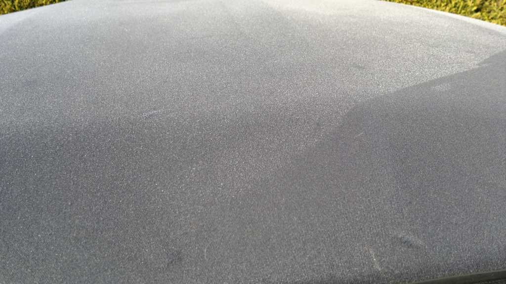

It didn't rain. But it did freeze.
Frozen pics to compare, from 5 weeks ago.

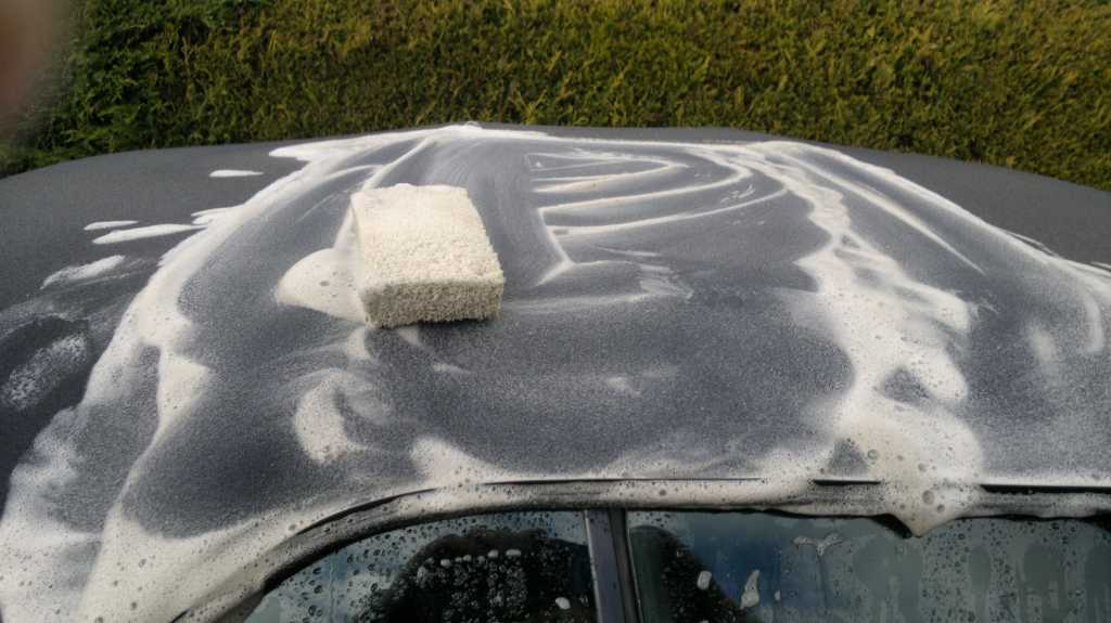

Get the hose pipe out and thoroughly soak the softop.
Next get the sponge and cleaner from the container.
I sprayed a area of the roof then started to work in the cleaner as you can see it foams up and the amount of dirt to come out is quite frightening
then move to the next part of the roof and do the same

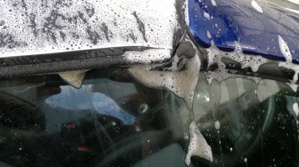

ensure you get into all the little gaps to remove the green mould etc
once you have done the whole roof use the hosepipe to wash off the cleaner.

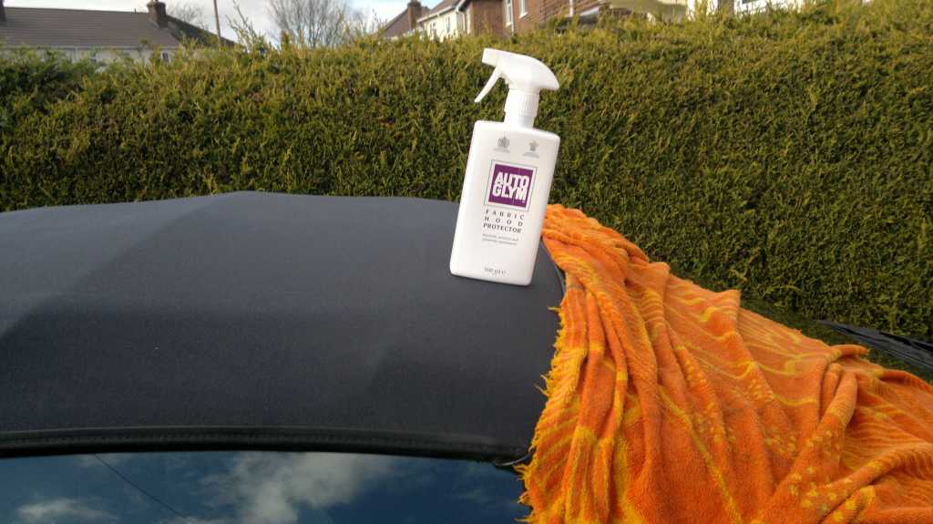

you can now put on the protector, you dont need to wait for the roof to dry out.
cover all paint and glass, I used a wet towel to cover the exposed areas.
Spray the roof liberally i used over 1/2 of the bottle. As it dries out the roof will start to shine white for a short time and as it drys out completely it turns to the correct colour
like this -
Thats it! One nice clean soft top.

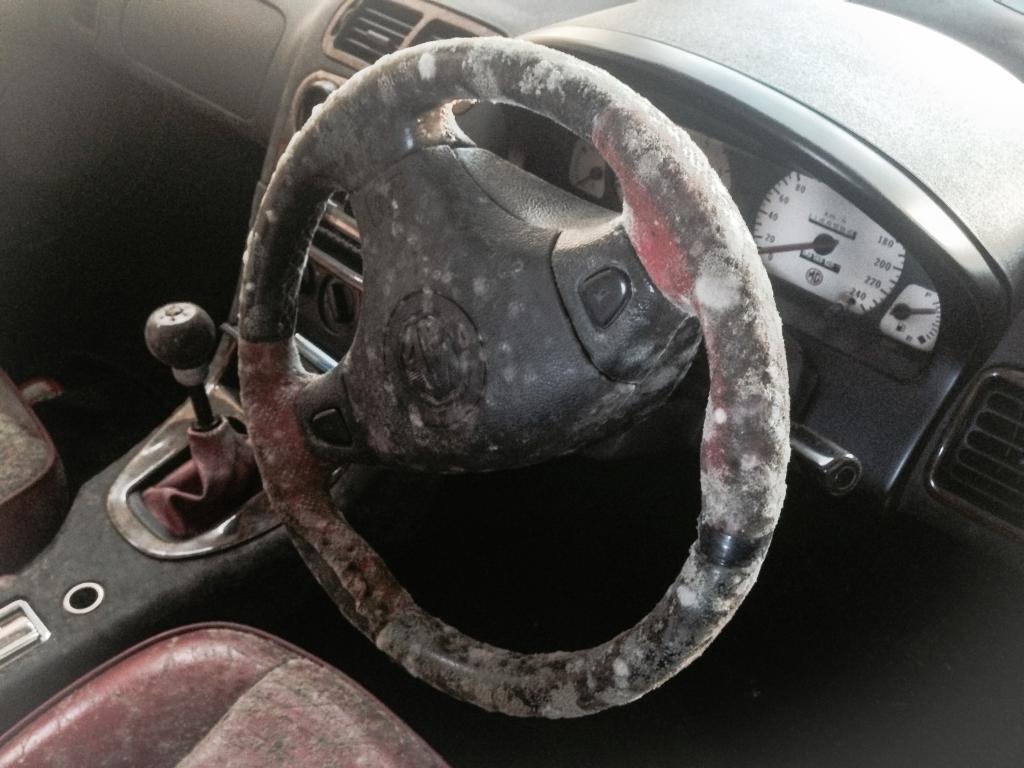

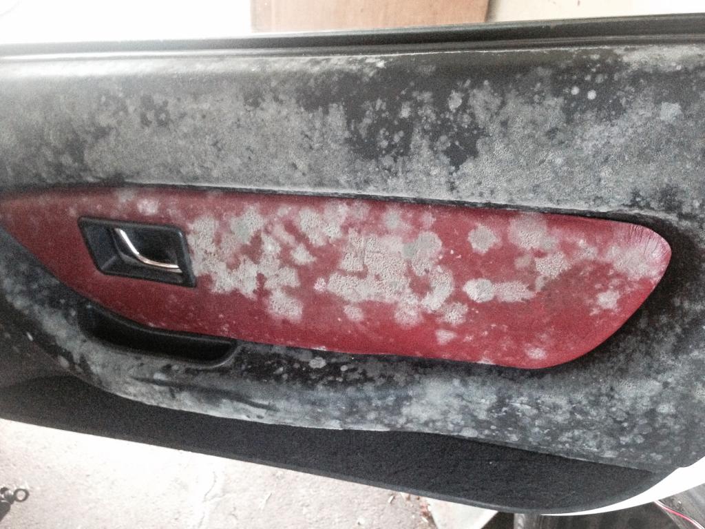

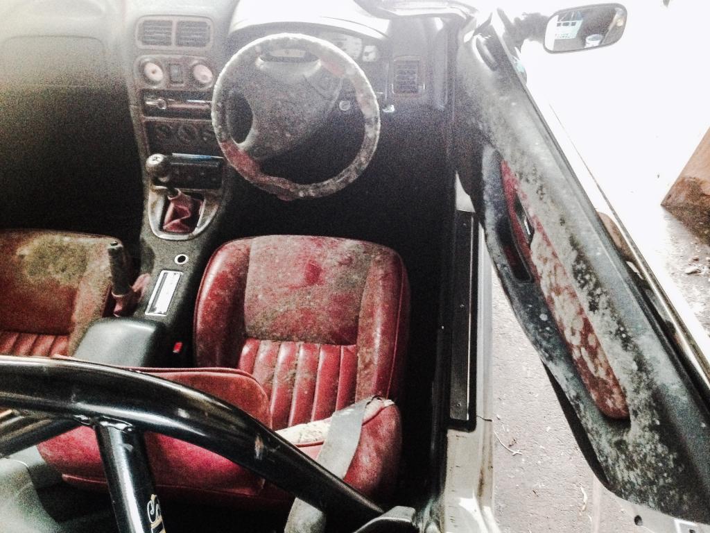

That is a pity and quite extensive. Has this come on quickly?
I have the roof down quite a lot and quite a few times it has become slightly damp from driving in light rain but I have not suffered this.
It looks like your roof has become wet and not had time to dry out properly.
It may be worth others using an antibacterial spray just as a precaution.
Is this a common problem? Not one I've come across on forums so far.
p.s. Have you been sneezing a lot lately?![:unsure: :unsure:](/media/kunena/emoticons/22.png)

It does look like mould :rant: when was the fabric cleaned and re-proofed properley. Renovo products are the best. :thumbsup:

I've neither cleaned it or water proofed it since I've owned it, around 7 months now Bryan. ![:) :)](/media/kunena/emoticons/8.png)
Yes, it came on very quickly Paul. It's my daily runner so it's constantly under the elements.
I'll fix it and then take preventative measures with 'agent orange' or whatever. It'll make for a good how to. So, I might let it mature a little longer just for some nice colourful pics. :broon:

Looks like a spare hood that's been stored in a damp garage for 6 weeks.
by Luckymarine
Leigh I would clean it asap if I were you. It is likely that it will leave marks you cannot remove if you let it 'mature'. :nonod:

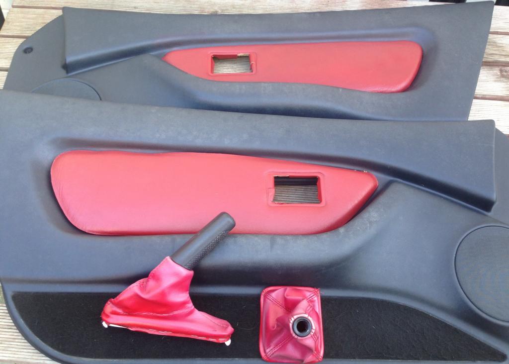

mine had this too and it had been renovoed cleaned, restored and reproofed. To make it worse inside there was condensation which was horrid sticky brown stuff :nonod: I think the car must have been owned by a smoker at some point.
All Ive done for a temporary measure is wipe it so any ideas would be appreciated

When our car sat in a garage car park for 6 weeks whilst they didn't do the head gasket, :rant: It came back with this on the inside of the roof (as well as a seized rear calliper from the handbrake being on for the same time! :nonod: ).
I cleaned it with autoglym soft top cleaner and when dry I renovo'd the inside.
Since then, it's been mould free!
It may also be a sign that the roof material is beginning to allow moisture through, so clean, renovo and waterproof the exterior for good measure. :yesnod:

Putting one of those things in that absorbs condensation eliminates it .. I have 2 in the Landy and was surprised at how quickly they filled with water, and one in Madam .. :thumbsup:
leigh i used dettol spray and it worked hasnt come back on mine
