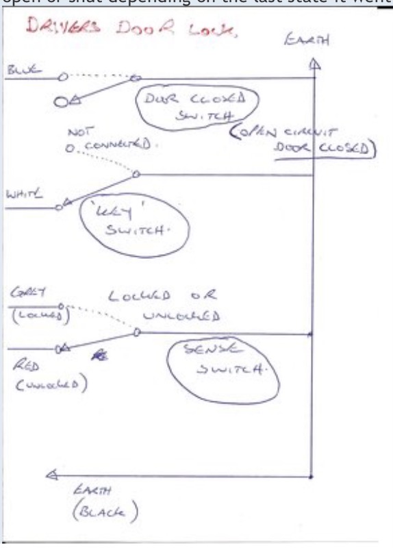

Replied by Delbourt on topic Locked out and will not start - alarm sounds off
Posted 1 week 1 day ago #224325
 This is a diagram that I came across some time ago and regrettably cant recall or find the reference to the author. I think it came from a MGF.de website.
I tested my most recent installed mechanism and it behaved as this - or at least it appeared to behave like this to me.
Replied by Airportable on topic Locked out and will not start - alarm sounds off
Posted 1 week 1 day ago #224326
I believe this diagram is off Dieters website. This website is a must for any enthusiast, it overflows with information, it lists the original monochrome circuit diagram if the f; it make an interesting comparison with the later edition.
Posted 1 week 1 day ago #224329
Regarding the origin of the wiring sketch. Yes, that seems to ring a bell in the memory.
Hopefully someone (perhaps Roverlike or anyone else) well versed in the electronics of these cars can add some further explanation regarding the issues Im experiencing with these locks.
Im very puzzled why the manual key could not overwhelm the system with or without the battery connected, but thankfully once the battery charger was connected and that presumably boosted voltage the fob operated the system.
