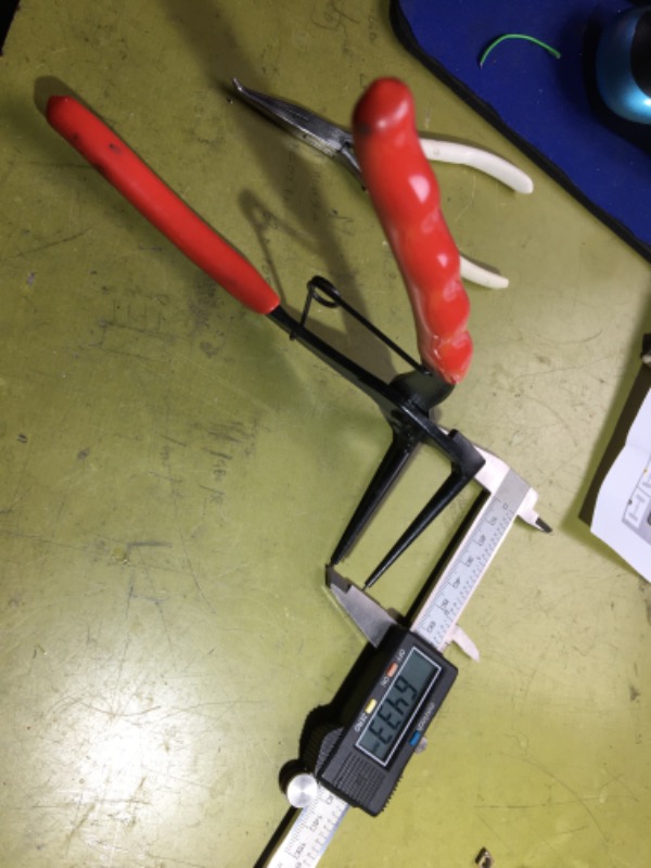

I have looked through the “how to” list and see the link to a sequence that restores functionality of the rear caliper but without disassembly of the internals of the caliper.
I have the piston out and as I look down the body of the caliper I see an inverted “top hat” component held in place by a circlip that is a very long way down with tiny holes for the business end of circlip players to locate in.
Am I correct in thinking that I need a very special pair of long nose players to get that clip out before I can go further? Or is there something else that needs to be done instead.
Someone must have trodden this path before me and know the answer. Please advise.

Replied by Airportable on topic Dismantle and re assemble the rear brake caliper.
Posted 2 weeks 1 day ago #224143
You are staring into the abyss, unless you have the correct circlip pliers, removing the clip can be done by “poking about”, re-enstating that clip is a task too far & you are likely to damage your head & the wall against which you hit it.
I have done a number & have sworn never to touch another; there is no instant gratification, you have to reassemble the entire system & have fluid through it before you can check your homework.
It is however gratifying once the job is done.
Where are you located, if you consider the journey worthwhile you can borrow mine.

Replied by Delbourt on topic Dismantle and re assemble the rear brake caliper.
Posted 2 weeks 1 day ago #224144
Thank you for the kind offer. If you were next door then I’d accept your kind offer with alacrity.
However, I suspect that Southway Devon is a bit more than a day’s bicycle ride away, and eBay have them for not an unreasonable price.
I note the complexity, thank you.
I might take up the challenge simply to get a pair of OEM calipers that are worth having. The piston is in very good condition apart from some minor corrosion around what looks like a vent hole in the groove into which the dust shield resides. Easily cleaned off.
The first challenge is to get the external nut off.
