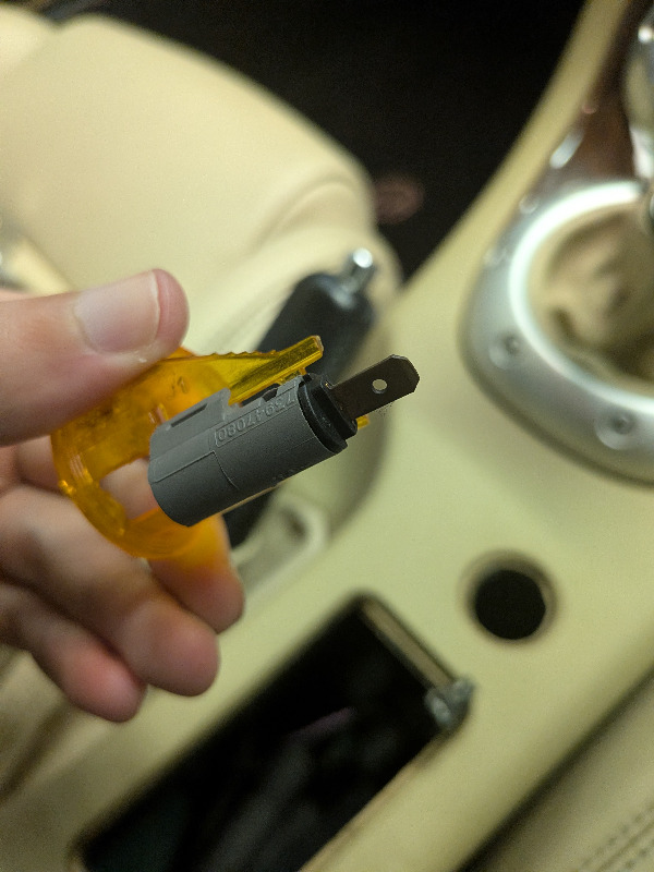

- Removed the current lighter and it's a bit of a mess, I gave it a bit of a scrub and this is how it looks (see attached below), is it just this thing is probably knackered and I should get a new one?
- Is there anything else I can test?
- I do have a cheap little volt meter but was unsure which was positive and negative on the cable, can anyone clarify?

It does look a little grotty, nothing odd there, a scruba dub dub with some wire wool should shift the grot; don’t do this whilst connected!
If it’s just a reasonable USB charging system you require, there are any number of ideas to be had for single hole fitting, by looking through eBay. You will, in all probability, need to open up the hole.
Chris is spot on with polarity & it would be a good idea to fit yourself up with a reasonable test meter. A continuity buzzer is an essential for car stuff & make yourself an extra long test lead with an optional crock’ clip.

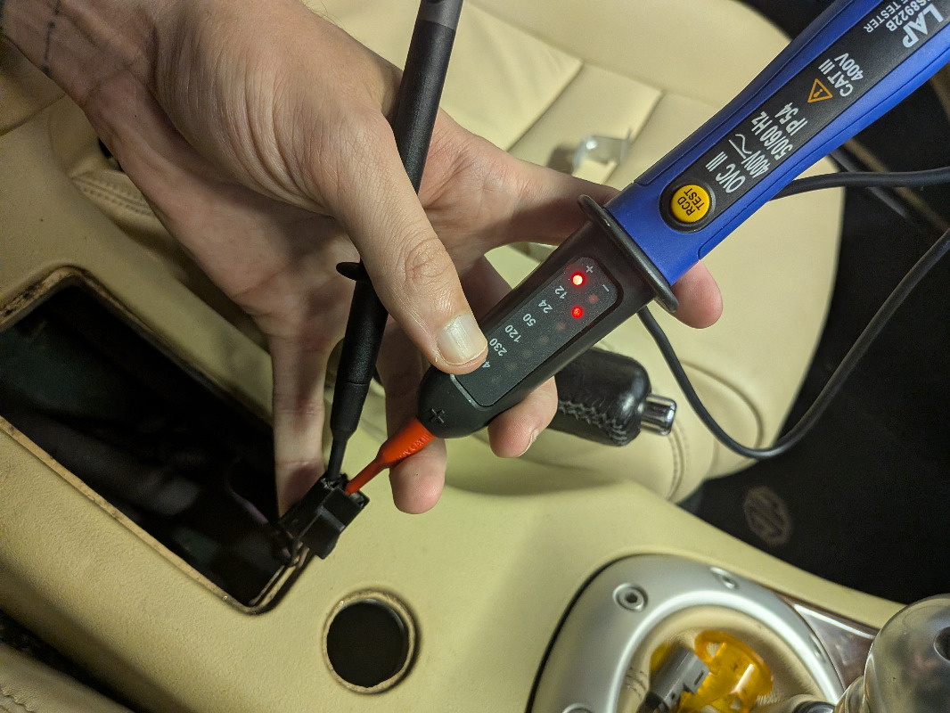

So I tested the cable with a tester and I am getting voltage to the cable end. (see below)
I pulled out the orange clip and noticed that there looks to be another connector on it, nothing was connected to it. Should there be able here. I had a rummage around the cavity and could not see anything. Is this needed to function or is it reduntant?

That third connector is for illumination. There is a spring clip on the grey fitting, this connects to the earthy side if the socket, a separate positive connects to the third connector & with a T3(?)lamp fitted you can locate the lighter when its dark.
