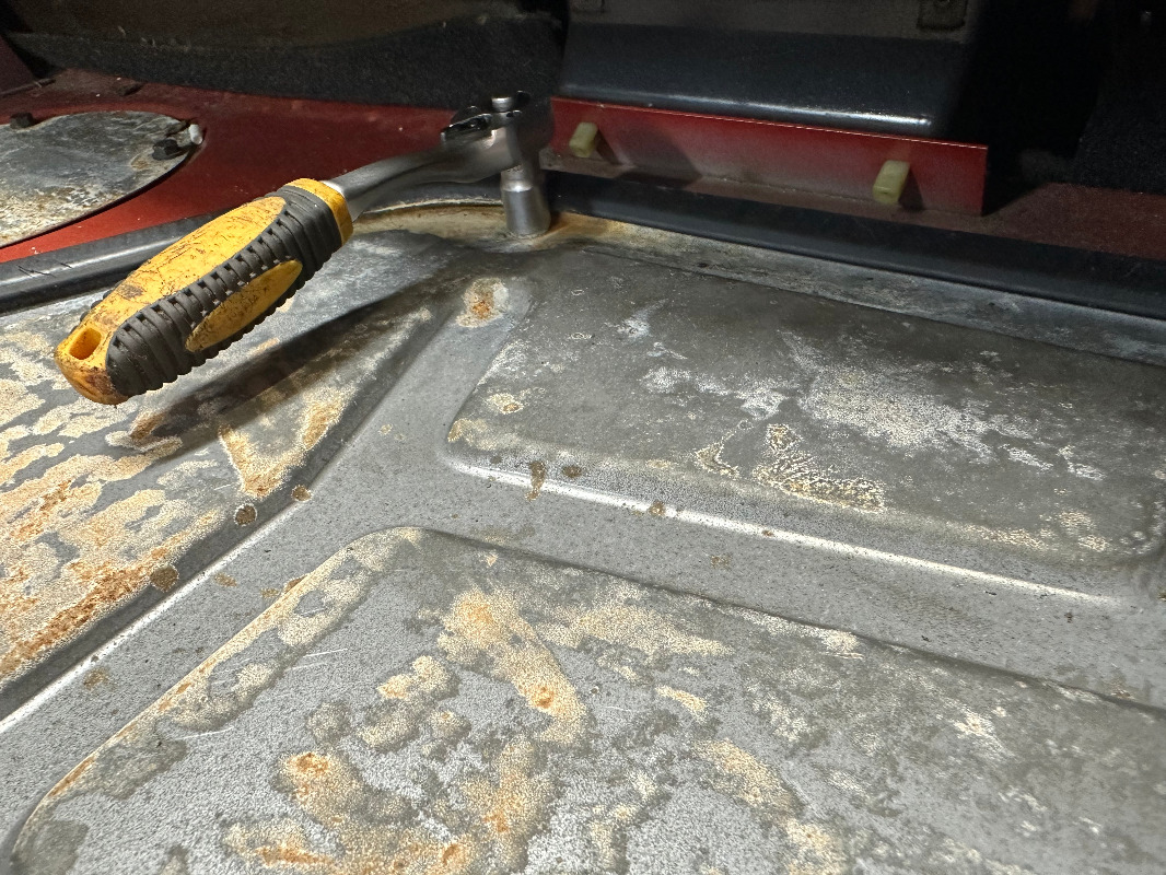

Cobber I, in common with everyone else on the Forum, am delighted to hear that you have recovered from your recent Trauma.  I will be interested in the upcoming How-To on the Clutch Change.  I live at the bottom of a valley and every route out involves a hill-start & rapid acceleration into an all-too-rare gap into heavy traffic on the A30.  It is difficult to avoid riding the clutch with a "generous" dose of power, in order to get out into that brief gap in traffic.  It is therefore only a matter of time before I will need a clutch change.
I read the post above with interest;  I suspect you have an F with no loudspeakers in the T Bar.  I think the complaints about difficulty reaching the bolts at the front of the engine cover are from those WITH the deeper speaker housing/T-Bar.  See photo below:

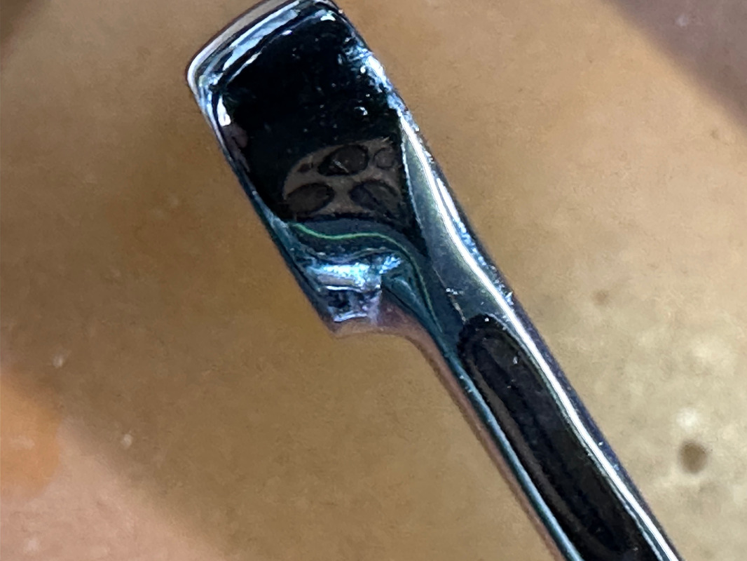

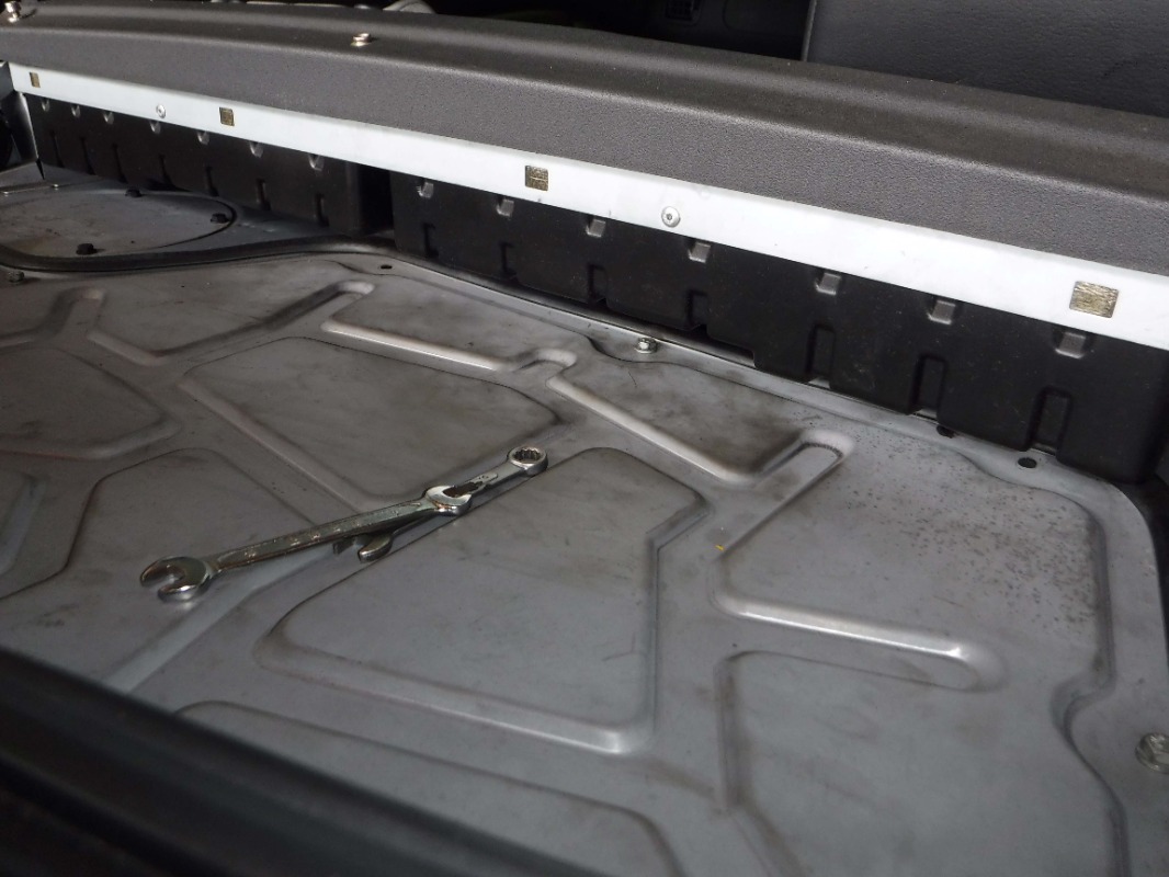

Yes I'm a F'er but TF'ers should perhaps look at cutting down a socket so as it's not so high as to foul the offending cover, you do not need to bugger up your !/4" drive set just buy a extra 10mm to modify for use as a special tool kept just for this job.

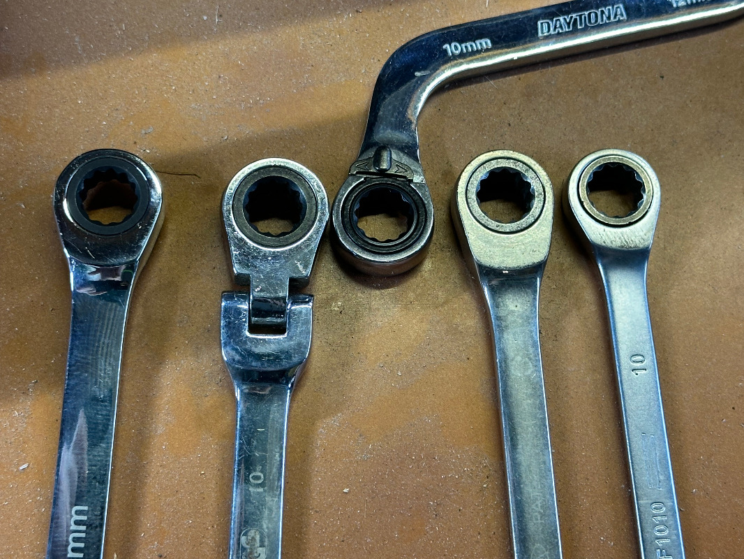

Another possibility is to find a ratchet combination ring spanner that has a thin enough profile about the head to not foul on the lip on the engine cover
Below is a selection of ratchet 10mm ring spanners showing the varying thicknesses of the head profile with the thinnest being on the right

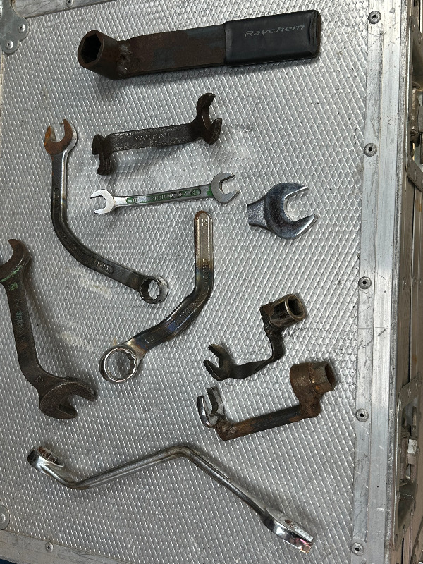

As promised, here is just a selection of special spanners that I've made up to do a specific job from one draw:
This lot are actually to work on Aussie Fords,
Oddly enough I've not need to make any for my MGF........ yet.......there is still time!

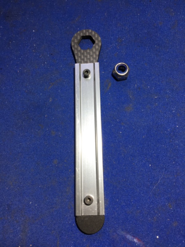

   And to finalise. The carbon fibre ring spanner arrived the other day & I thought I’d received an empty package, in the very bottom corner I found the spanner, which was considerably smaller than advertised, it was however 10mm.
It has been reimagined & for those need further proof that necessity is the mother of invention, I enclose a picture (hopefully).
