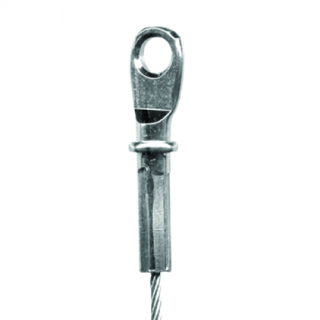

This simple manual release is there to save the day or just make it easier when you want to open the bonnet without going round the back and opening the boot. For the remote release you will need 1m of 2mm wire and a small eyelet.

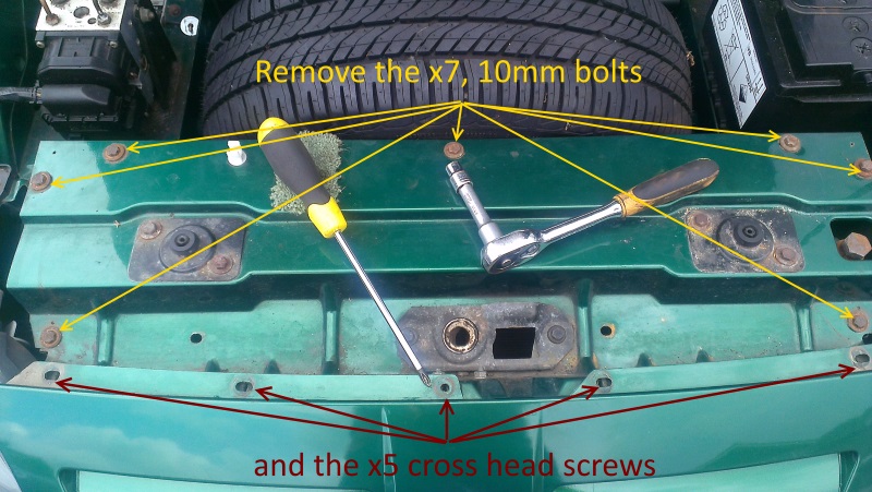

You only need to remove the x7 bolts and x5 screws as shown below you can lift the panel forward to gain access to the catch mechanism. The panel will still be attached by two bolts just in front of the latch, but as removing the nuts would allow the bolts to fall away I tried without removing them and there is sufficient access to do the job. Note there is no need to remove the bolts holding the radiator locating plates, they can remain in place.

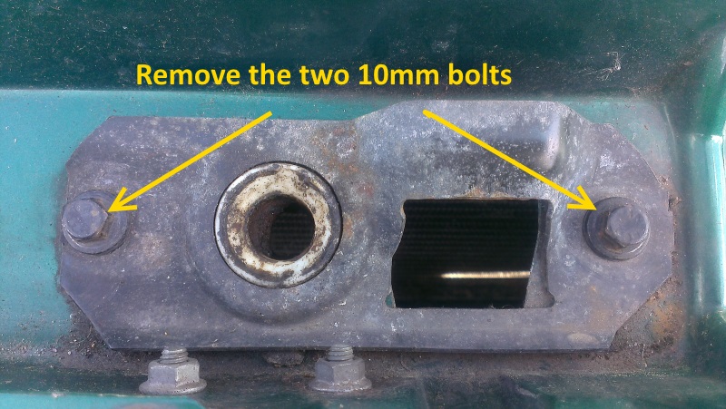

If you are removing the bumper then you would next remove to two 10mm bolts holding the bonnet release mechanism or if you have removed the radiator panel then you can miss this step and go straight to attaching the cable.

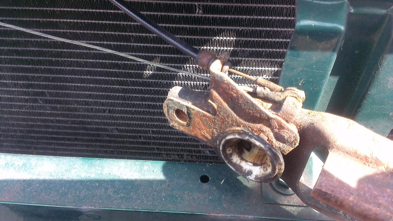

Here you can see the underside of the catch, with the additional cable release already fitted.
Pass the new 2mm cable through the spring retaining hole and then crimp on the eyelet.
hook the eyelet over the bonnet release arm (where the original cable is attached).

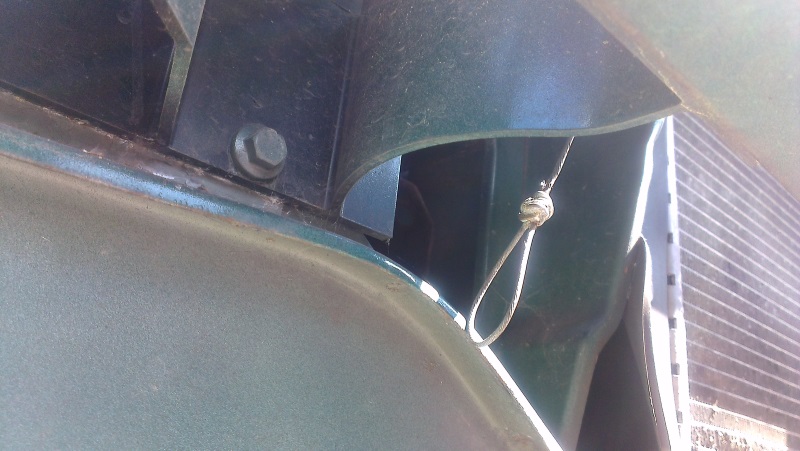

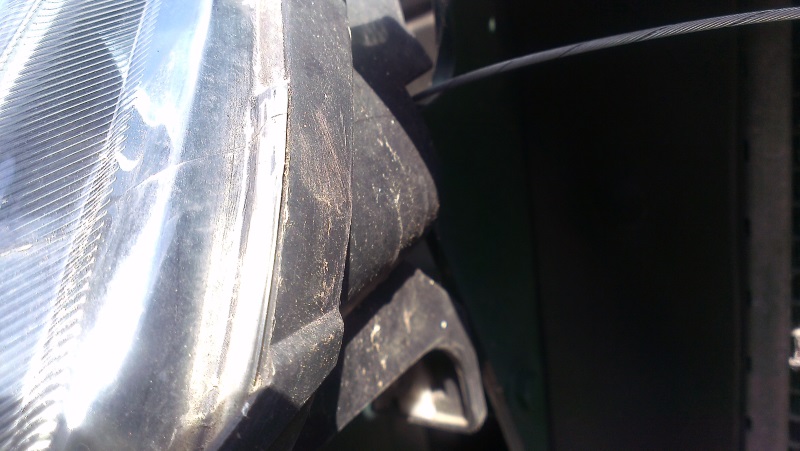

Adjust the length of wire so that it goes across the car to the offside headlight, over the body and hangs down between the headlight and the bumper. Next make a loop and then pass the wire over the body at the inner side of the offside headlight again.
Finally refit the radiator panel, taking care to position the radiator locating pins in their holes or refit the bumper as appropriate.
The loop of the wire is not visible from looking under the car but you know it's there and you will find it if you ever need it. :yesnod:
