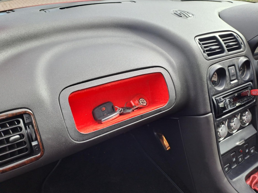

I whipped up a cubby holder on saturday morning , I bought a used blanking plate £13 and some red felt £1.50.
I was going to fiberglass it all but then thought it`s hardly going to be holding a gold bar, so after I had made the cardboard template test fit and realising how stong the card board was I just made it out of hard plastic and bonded it all together , I made a nice round lip for the front out of 3 core cable and covered it in felt .
only took a morning to knock up

I have been having trouble logging in the last few days , buffering and then say site not available, i manged yesterday but just crashed when I tried adding a photo. I dont recommend using a jigsaw as i went a tad too far in one corner and had no room to rectify the curve, i was going to get a dremel, until I saw the price of them ! anyway for a total of £15 it`s good enough , so here it is
