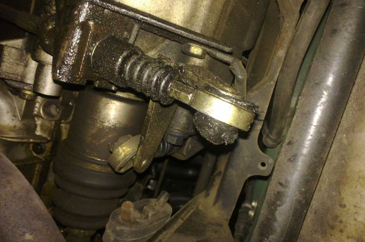

thanks for that. Just to make sure, here is pic I just took from under car. So besides that bell crank assembly and rubber parts, do i need to change anything else? Problem is that my 2nd and reverse gear dont go in at all, and 4th struggles also. So currently driving with 3-gear box :lol:
by janneh
Replied by David Aiketgate on topic Gear cables Bell crank fittings- how to replace.
Posted 12 years 9 months ago #129098
That all looks in pretty good condition , tbh. :yesnod:
Have you tried adjusting the ends.(see post above)
It just sounds as if your cables have stretched slightly, and screwing the ends in a couple of turns may solve all your problems.:shrug:
AND :welcome2:
Last Edit:12 years 9 months ago by David Aiketgate
Last edit: 12 years 9 months ago by David Aiketgate.

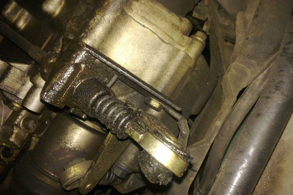

really, mine looks okey? Here is another pic.
by janneh
Posted 12 years 9 months ago #129102
Ah! Didn't spot that. :nonod:
I think it was Dieter(I'll check) who took the joints off and remade them replacing the damaged rubber with silicone rubber.
Posted 12 years 9 months ago #129103
...but to answer your question, you just need the Mike Satur bellcrank. Your rubber boots look in good condition.(Unless I can't see the damage!:lol:)
