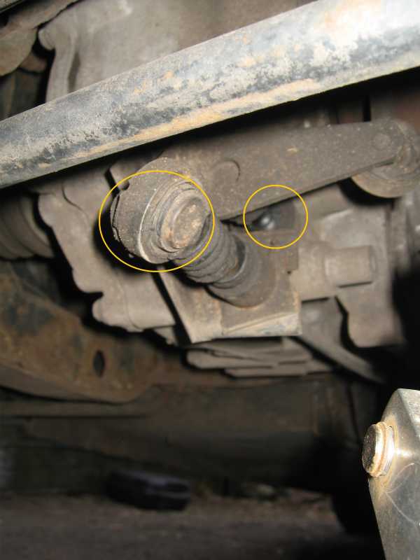

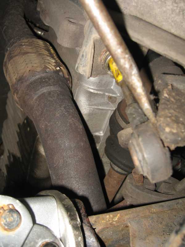

Just forwards of the Cat and just to the nearside of centre you'll see this.
This little gizmo translates the movement of the two gear cables into gear changes in the gearbox.

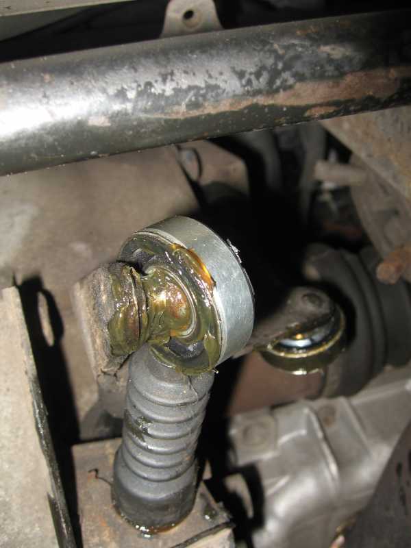

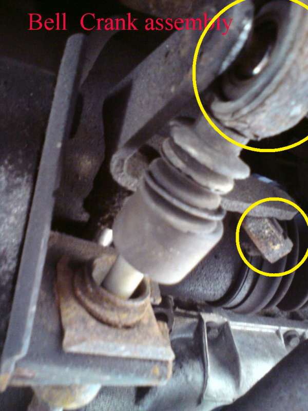

The two ball joints are highlighted above and in this photo from further away.

I used a sharp bade to cut away the remnants of the boot and exposed the cable and the fixing.
The cable end is threaded to take the the ball joint and there is a locknut securing the ball joint to the cable.

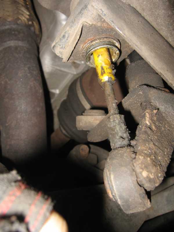

Using a large flat bladed screwdriver pop the old ball joint cup off the ball.

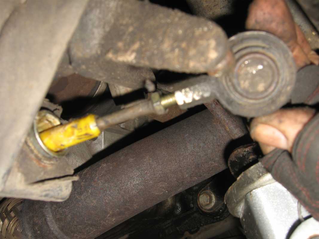

Using two 10mm open ended spanners hold the locknut steady and undo the rosejoint. This way means that the locknut is retained in the correct position for replacement without fiddling with adjustment. Once you have freed the joint you can wind it off the cable end by hand.

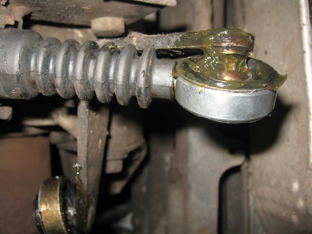

Replacement is simply done by putting the new boot on (I put some high temp grease inside the boot) and then winding the new balljoint up to the locknut. You can re-engage the two parts of the joint by pressing the balljoint cup onto the ball using gas pliers.

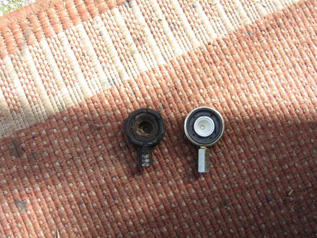

In practice, the problem I found was that one of the new balljoints had a longer shaft than the old one.

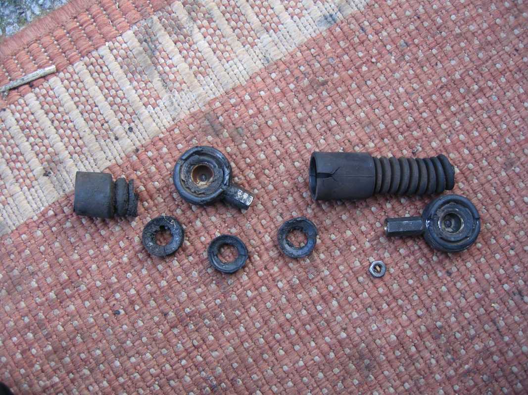

Here are the remains of the originals with all the pieces of the boots.

Slight over-enthusiasm with the grease, but this is the new setup.
