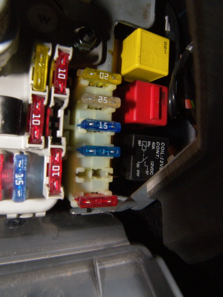

Removing one of the switch blanks reveals the other end of the heated Rear window circuit. I simply plugged the hrw switch in and pushed the new switch into place in the dash, fitted the relay into the socket to the right of the under steering wheel fusebox (see pic below). With ignition on, press switch, ooh warm air!

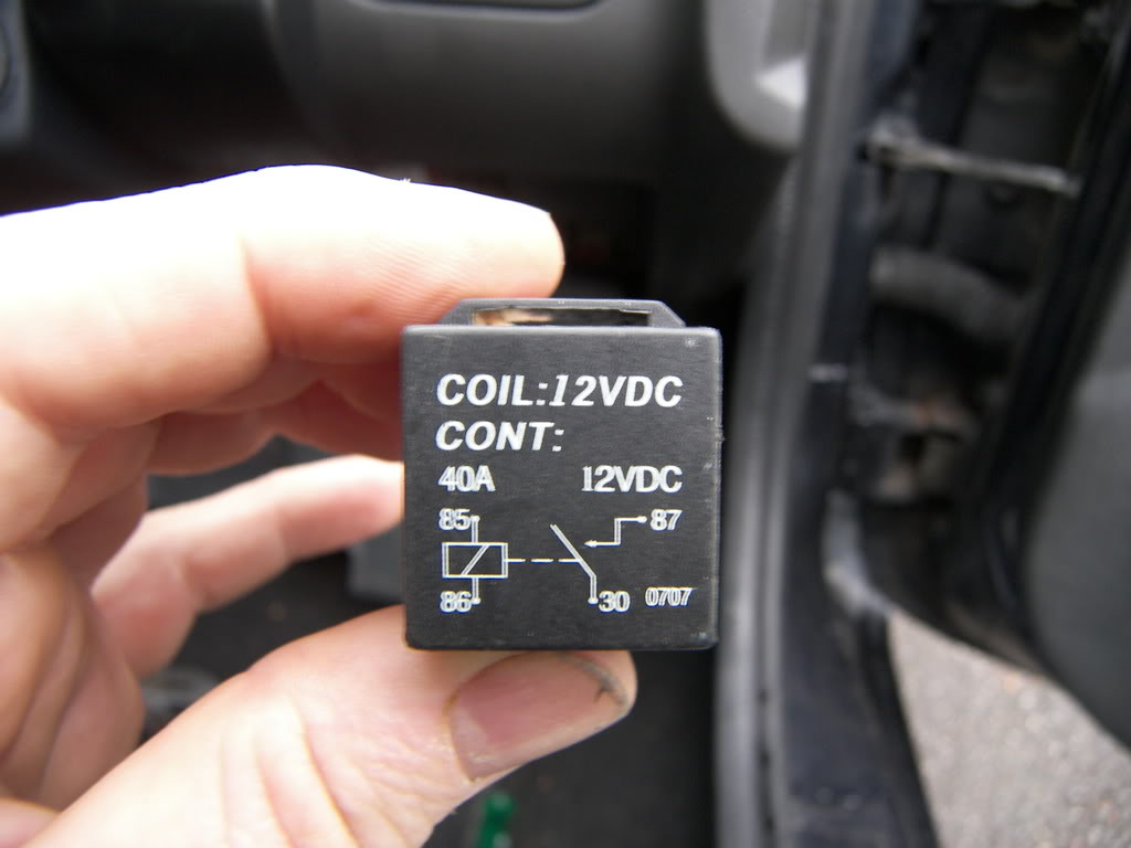

__________________When I bought the heated rear window switch and relay from Ebay, I was surprised that the relay was not a model specific or an MGR item , but just a common 40 amp auto relay, such as available at Maplins or Halfords.
I had bought a relay from Maplins for fitting some spotlights, and when my HRW one arrived they were identical! Only the one from maplins was only about £2.
Fitted in place and working fine.
